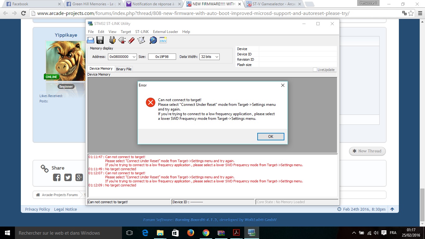

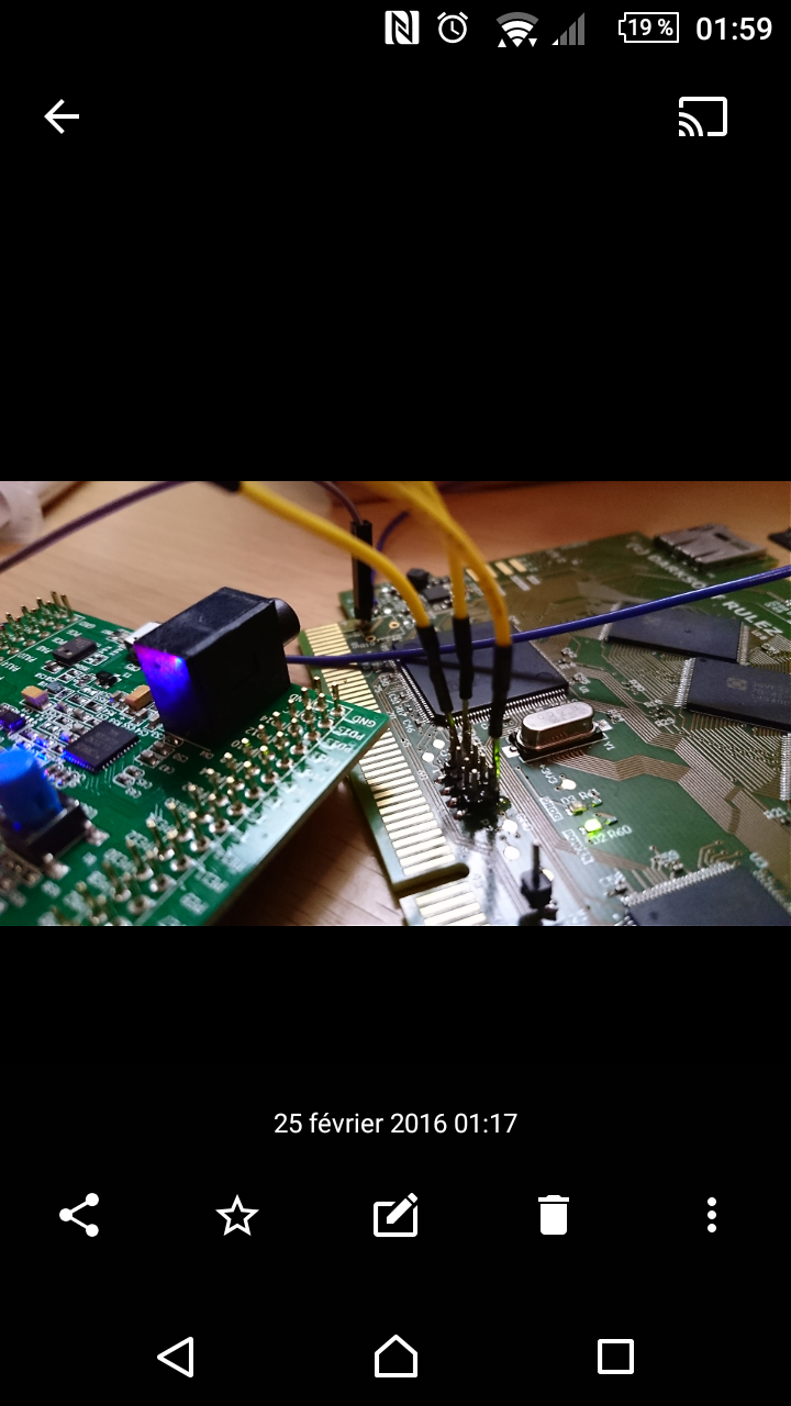

Hi,
I'm not able to upgrade my multi
It seems that I have an issue with the connection between the SMT32F4 and the card
Here a picture
can anyone help ?

you mean this

When I programmed mine, I used the same pinout as the CPS2 board. So 5 wires instead of the 3 shown in the new ST-V pdf guide.
General troubleshooting tips:
Run the program as an administrator.
Make sure you don't have the two jumpers in on the programmer that are noted in the PDF.
Rerun your wires to make sure you have them going to the right pins.
Reboot your pc without the programmer plugged in, launch the program, plug it in and try again.
If it still doesn't work, try doing it on another PC. I had this problem where one would work and the other wouldn't.
I need another PC so !
I troubelshooted all the steps mentionned above
Hmm. Should be more than three wires there. I'm pretty sure that pdf is wrong. Use the pinout of the cps2 guide.
you mean that the cart pinout for both multi is the same ?
I'll try it tonight and keep you posted
If you have other suggestions, let me know

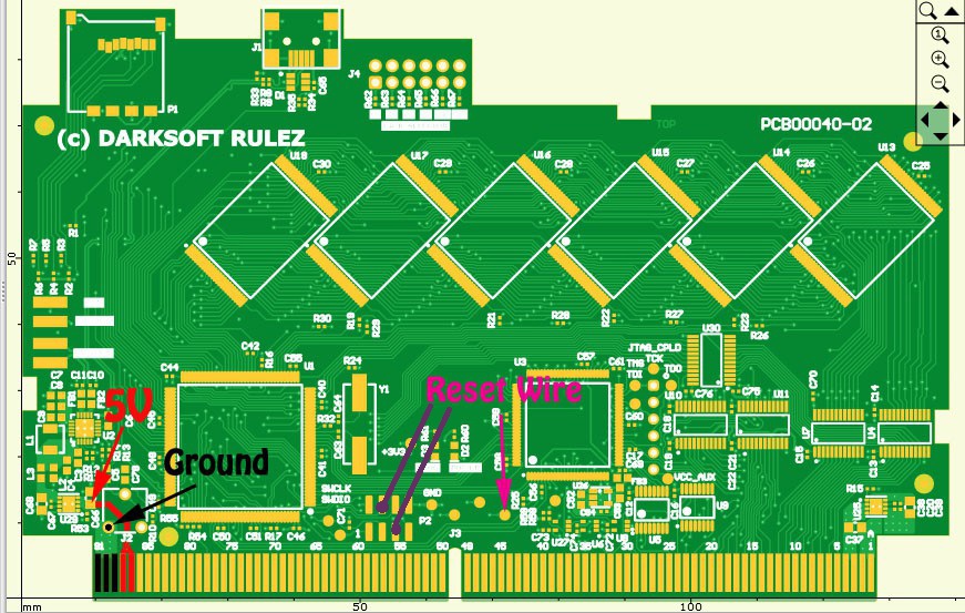

I have one more question :)
Are the pin4 and 5 from the cart programming connector connected to the reset point (the 4th from left to right) ??!
