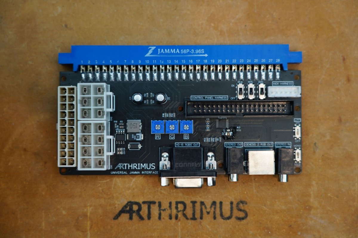

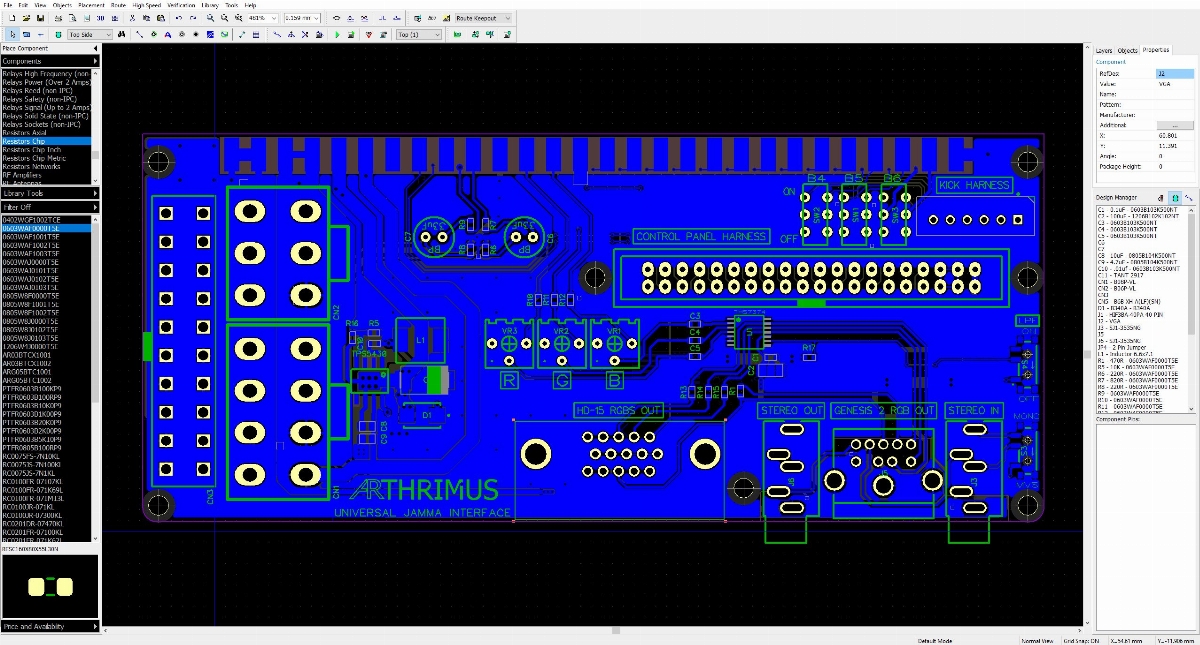

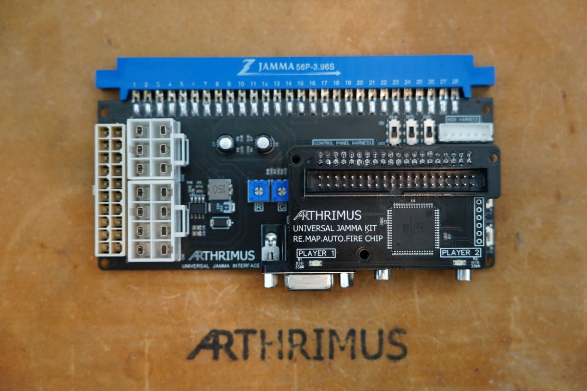

Hey guys, I have a new prototype in and have been testing it over the past couple of days. The new -5v circuit is performing well so far, but I wanted to get some opinions about adjustability. The current version of the -5v circuit is fixed voltage. What I'd like to know is if there is a particular need to have the -5v rail be adjustable. The current circuit is based on the TI TPS5430 which can be made adjustable by adding a trimmer potentiometer to the voltage feedback circuit, but if it's not needed then I'd rather keep it fixed because that will simplify manufacturing. This -5v circuit can provide up to 3A of current.

it's exceedingly rare that an Arcade PSU will have adjustable -5V
Precise voltages are really only necessary for digital circuits likes CPUs, ROMs and Logic Ics, 12V and -5V are generally only used for things like audio amplification and cooling fans where widely out-of-spec voltages are ok and wont cause any harm.

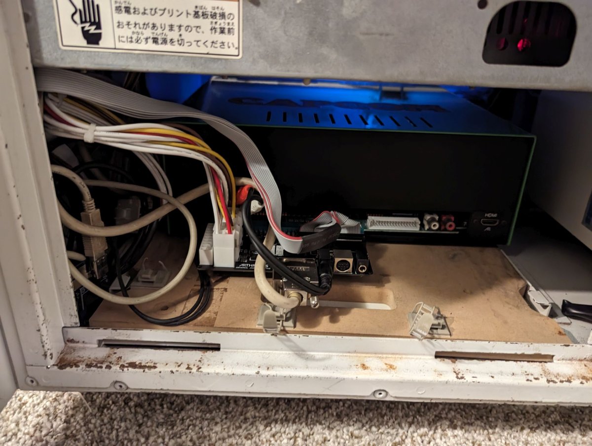

Ooohhh... is that a 20 pin ATX port I see? That would be sweet. I had planned on using a pico ATX to JVS adapter, but if I can just plug the pico into the board that would be amazing.

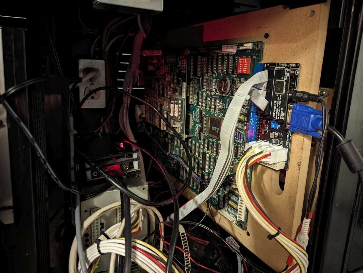

Does this Jamma Conversion Kit works for the Vewlix F Cabinet ?
Actually what do I need if I want to convert my Vewlix F Cabinet to Jamma
Can I just buy this conversion kit and I am all done ?

This would adapt the JVS controls to JAMMA but you would still need a scaler for the 15khz video (this is a maybe need since my Vewlix C seems to handle 15khz well enough). That being said, what I ended up doing was building a cable from the JST YLP-15V connector in my control panel to DB15 that I then plug into a Supergun or a JVS adapter.
