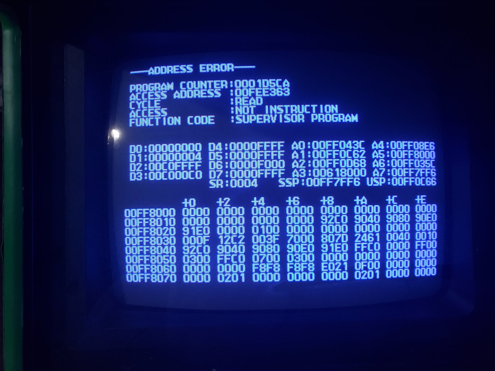

I’m having a problem with the games crashing on my CPS2 Multi. Some games crash immediately to a blue screen. When they don’t immediately crash, they either:
-load a bit, then cycle back to the first screen (the one that checks the data on the chips).
-crashes to scrambled graphics partway through the intro sequence, or if I try to coin up and start the game.
-freezes the game during the intro or coining up, the screen sometimes flipping upside down briefly with some flickering graphics, and my coin meter starts clicking and counting up like crazy.

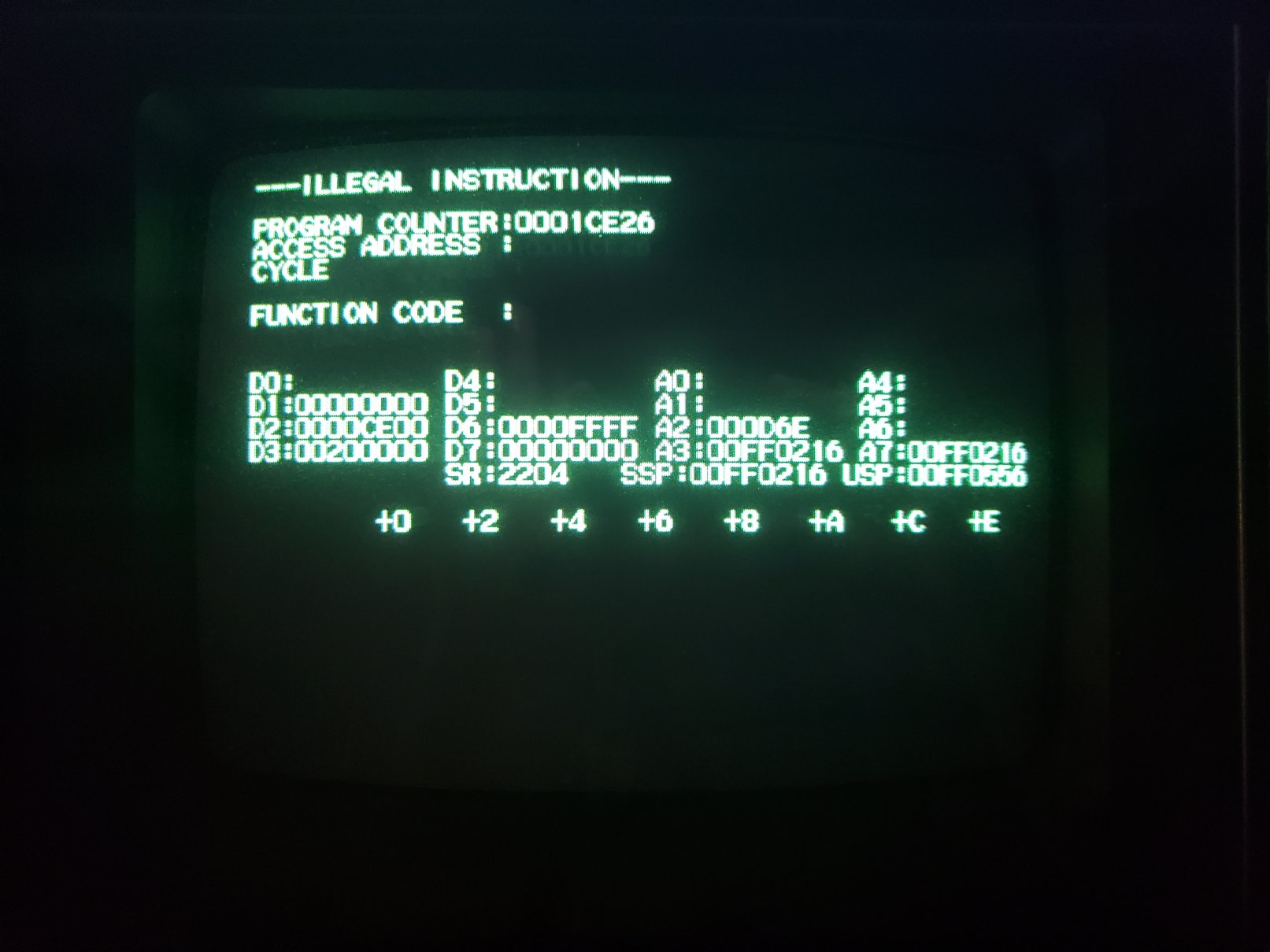

-Megaman Power Fighters and Megaman Power Battle crash to an illegal operation screen during intro or coining up (pic below of this). Street Fighter Alpha 3 Alt 2 US did this too.

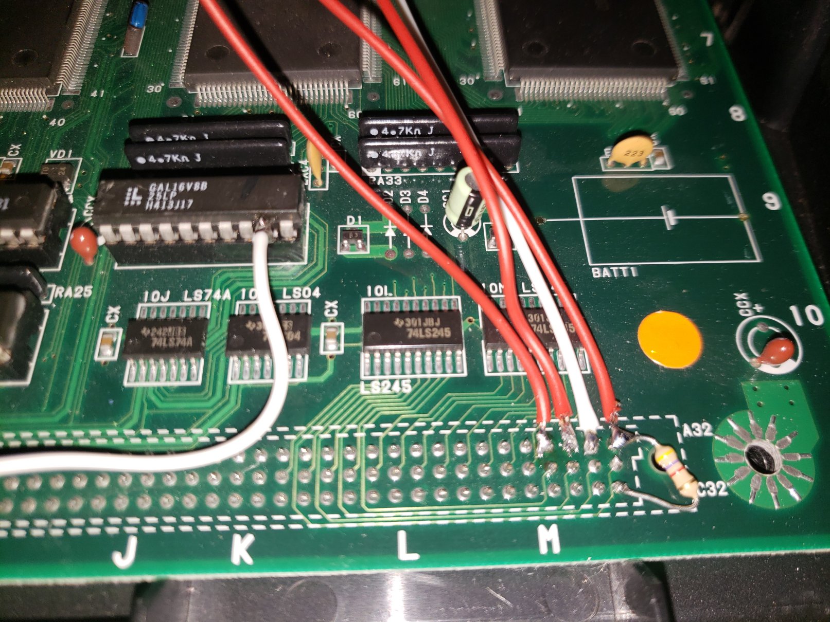

Installed the kit as per instructions, including the Key Writing addition. The old PAL I think is a D, so I used the one I bought with the Multi-kit, with pin 9 of the PAL G lifted from the socket and wired to J17 on the Multi.

Error message on Mega Man Power Fighters.
Error message on Street Fighter Alpha 3 Alt 2 US

So I wonder if there's something wrong with the key-writing setup, since only encrypted games are affected. When time permits, I'll remove and resolder the 4 wires for the key writing function.

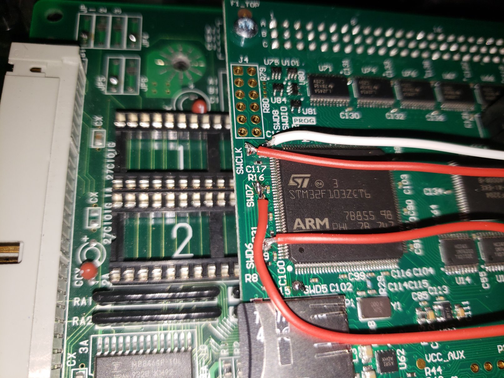

I removed the key writing wires. Made sure I got any excess solder, so no shorts or bridges. Installed new wires for the key writing.
I removed the key writing wires again (on one side only) and did the firmware update. It did take it successfully, and the file disappeared. Reinstalled the key writing wires, but still didn't work.
Completely removed the Darksoft kit boards. Checked all over the boards (kit and B board) for broken or bent pins, or any other issues, and used a continuity meter to verify any suspect possible breaks or shorts. Also checked the jumpers on the board, to make sure they were correct. Resembled, making sure all pins go in their sockets correctly.

I've seen the pictures of the 4 cables and those cables are IMO neither appropiate, not soldered in a proper way. I have the feeling that there is some solder blob or some shortcut with another part. Maybe the ARM has gone misconfigured or some component affected if there was a shortcut. At this stage, I'd sent it to @Mitsurugi-w
