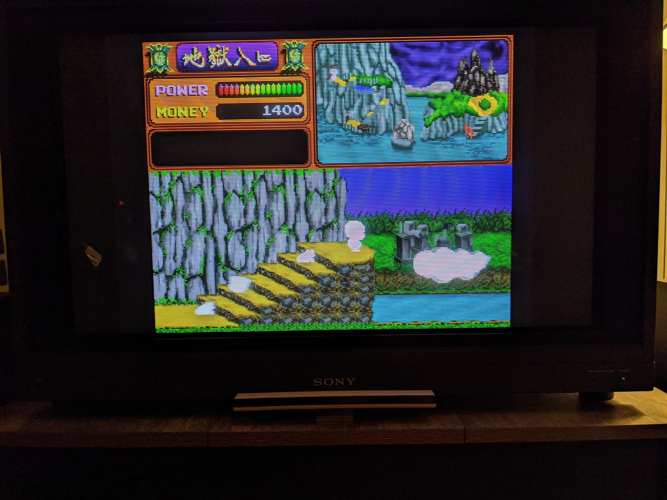

For me Shadowland works fine. Both versions of Yokai Dochuki load and I can play them. But all the sprites are pure white.
Not a dealbreaker as I would only ever play Shadowland anyway.
My donor board was a Galaga '88. I've not noticed any issues with other games. But I've only spot tested 50% of them or there abouts.

@the Goat just tried mine, also galaga88 donor. Same sprite issue for me on Yokai Douchuuki

Yokai Douchuki (both versions YD1/2) don't work properly visually (sprites are white)
