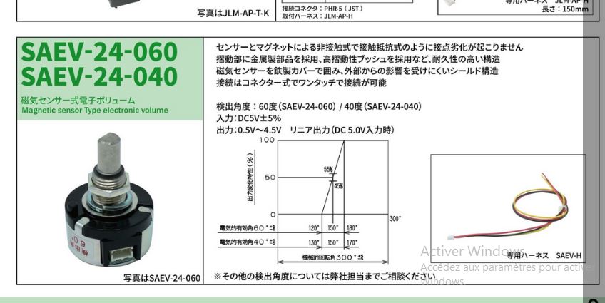

Hi everyones,
I've find this new type of volume pot inside the Sanwa catalogue and as I can see, they replaced the 3 pin arms by a JST header. This pot looks really cool. I'd like to replace the pot of my New Astros PSU and Id like to know if it will fit and also if the voltage is compatible.
The actual pot on my 400-5198-01X is a Chiba RVFI0 - 100QKK - SF :
https://chb.co.jp/wp/wp-content/themes/chiba-techno/pdf/presistors/01RVF02RVS-en.pdf
