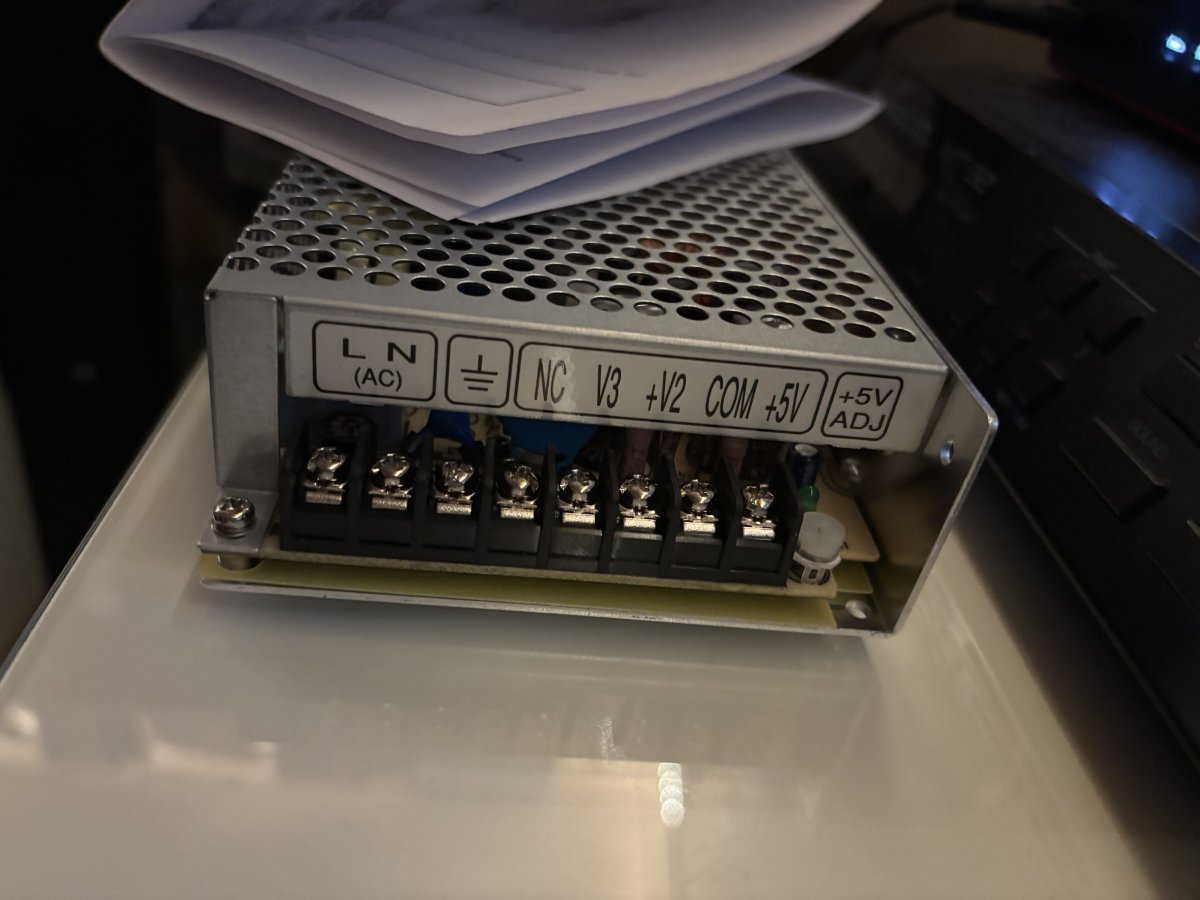

Hi guys,
So after getting everything together for my first arcade board (cps3, HAS supergun etc) I bought this power supply:
https://na.suzohapp.com/products/power_supplies/80-0064-00
I got the supergun power supply cables from RGB with the HAS and they seem easy enough to hook up. My question is to do with the power cable running from the mains, mainly where to hook up live and neutral. From my understanding ground would go to FG but not sure if the order of the other 2 matters, I'm in the UK and have the jumper set to 230v if that helps. Also what does the knob at the top control? Is this to fine tune the voltage?

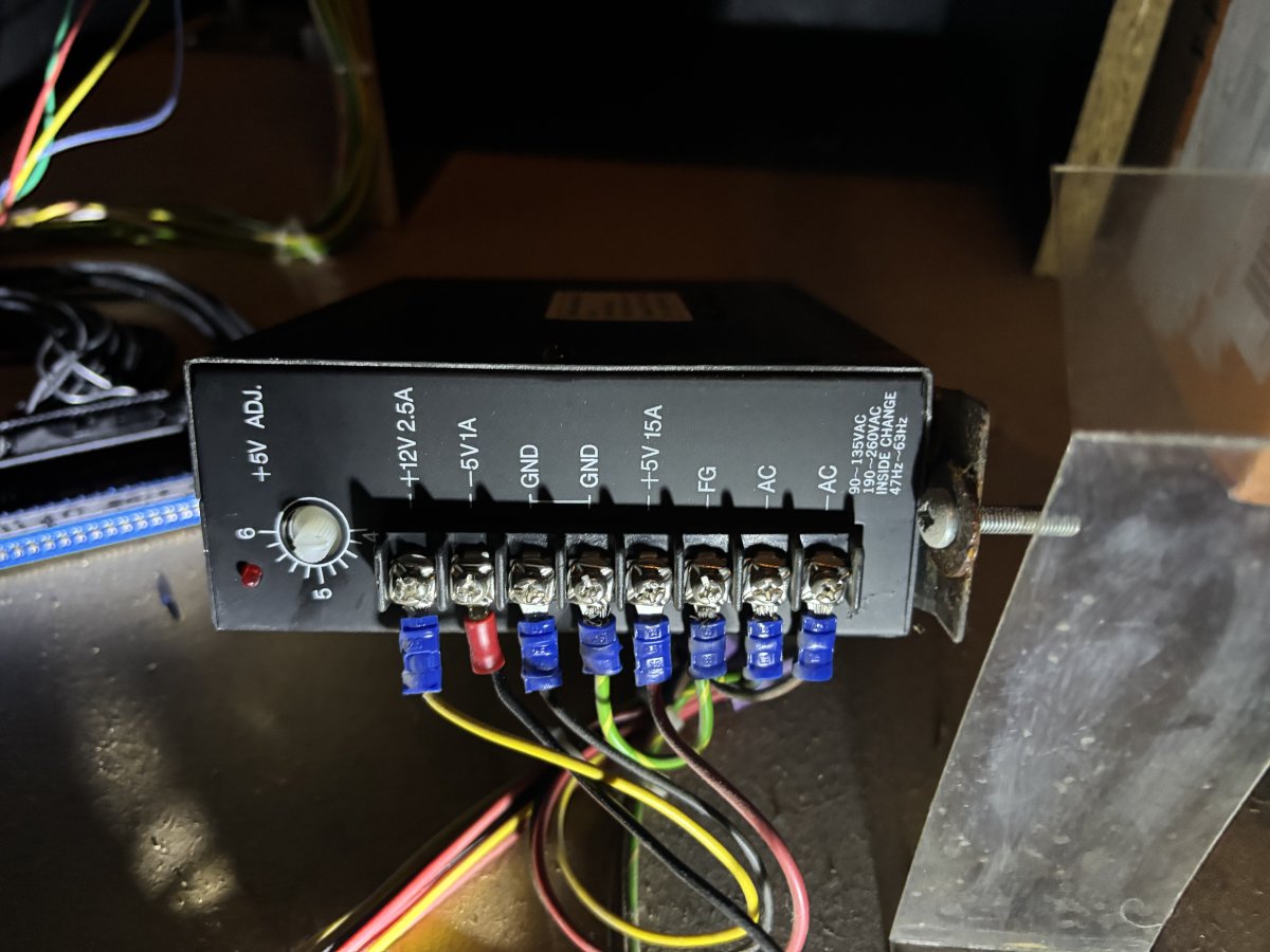

Here's mine:
It doesn't matter as it's AC. Just don't put them in the same terminal ;)
