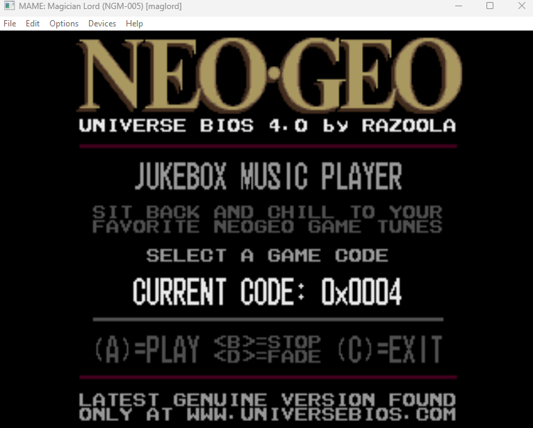

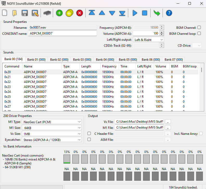

Hi Guys,
I'm trying to work with this nice tool, but i dont understand addressing.
From default it start it 0x20 command on first track, but what if i need to start from 0x04 command ?
What about neogeo logo boot sound from 0x0002 ?
Any way to work on that address ?
Any way to change the index of command ?
For my hacks I just do
add.b #$20, sound_command
On the 68k side.
You'll have to modify the.z80 it produces if you want to change the fixed commands. It doesn't offer any options to change these otherwise.

I know its an hard question, you know how to decopile / modify m1 z80 code ?

Hello iq_132
I'm back to the question here and i'm afraid I didn't understand your explanation. :rolleyes:
Anyone know what is for asm and c header that you can generate in option ?
can they be used for this purpose perhaps?
I found 4 magic address in M1 rom after build it with NGFX tool, to start audio on different address like 004.
So at this point i think to do some pre pcm conversion.
Now is really simple.
