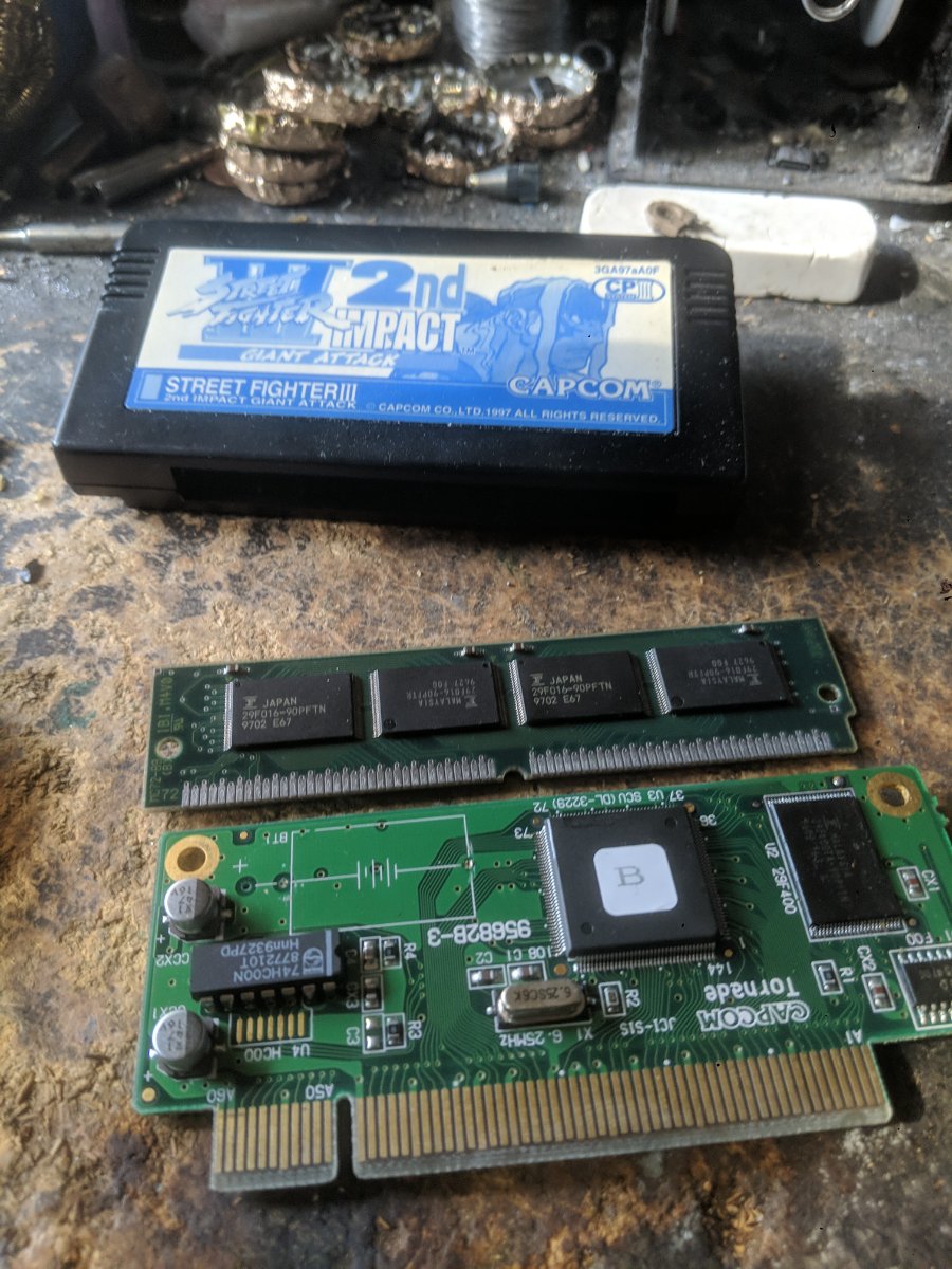

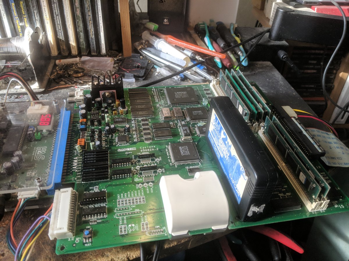

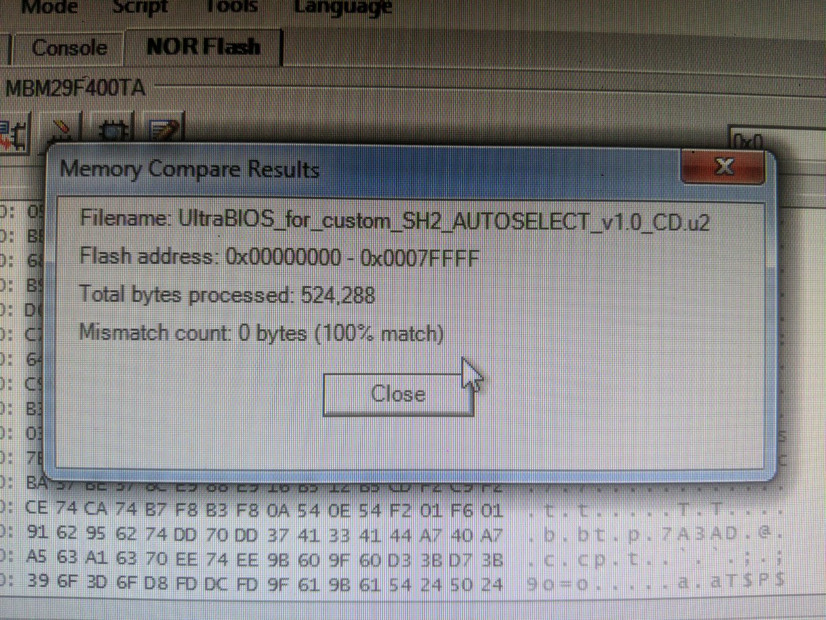

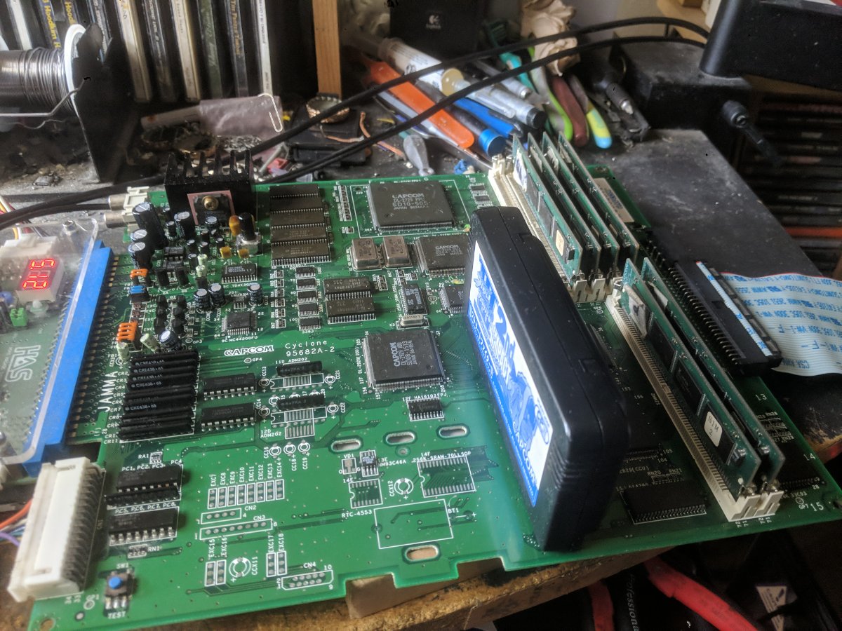

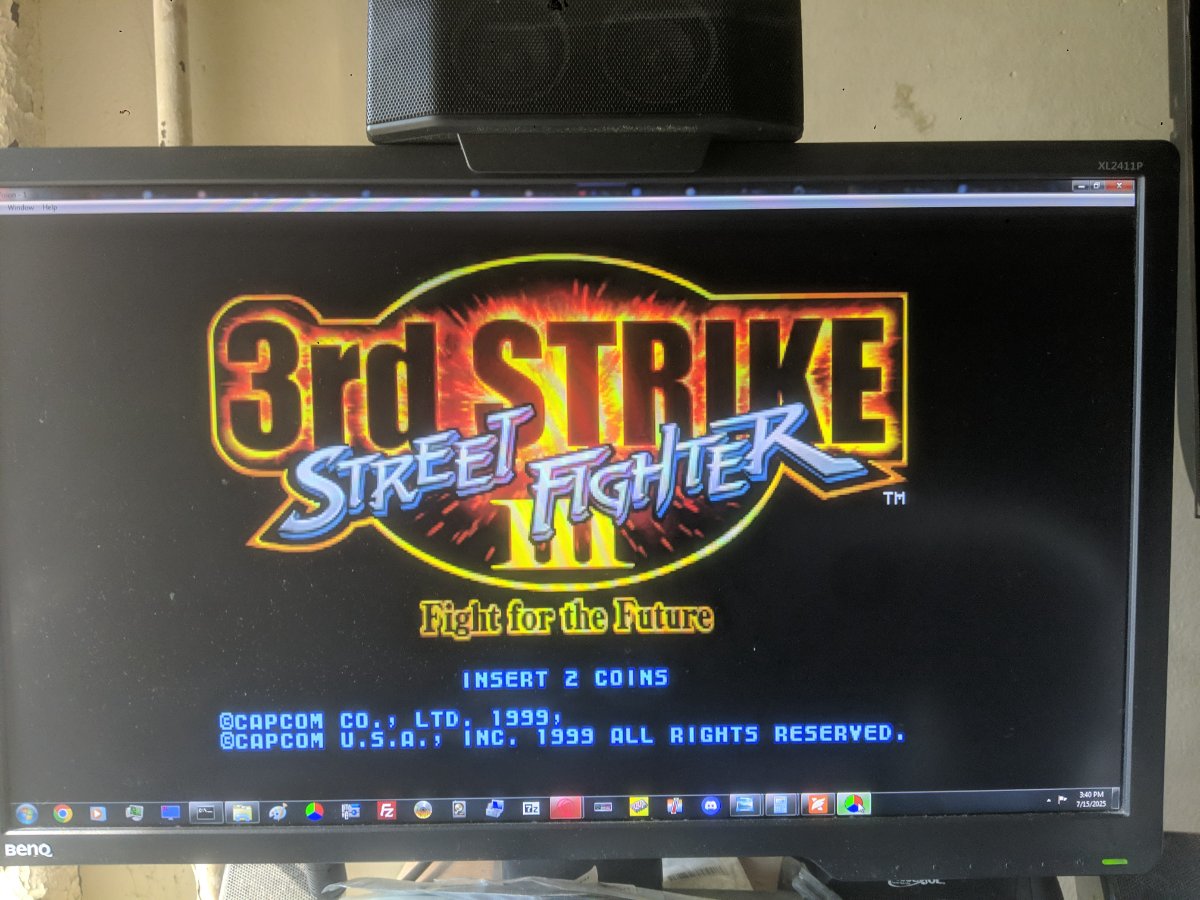

This board did not wanna go off peacefully lol. I turn it off after hours of testing last night to clean off all the flux off it, turn it back on this morning and it's missing simm 6. I took off the simm and started testing connections on the 3383 buffers, found that leg 13 which is common to all 4 buffer was missing from 3H, apparently this whole time it was hanging by a thread. Nothing some 34 gauge from top to bottom won't fix but damn this board a pain!.

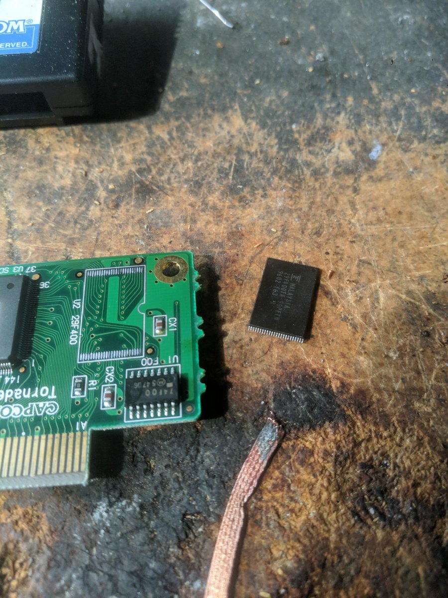

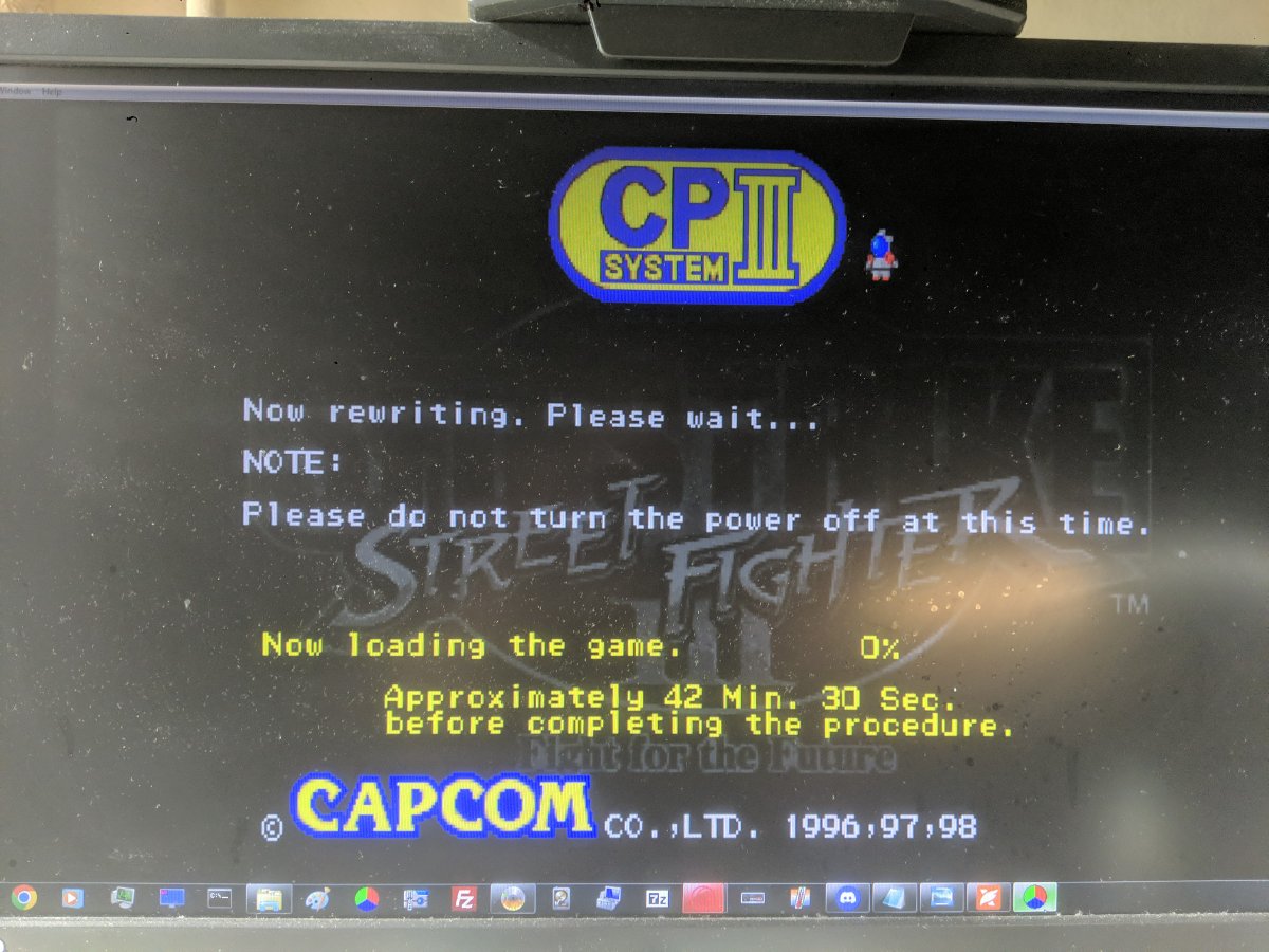

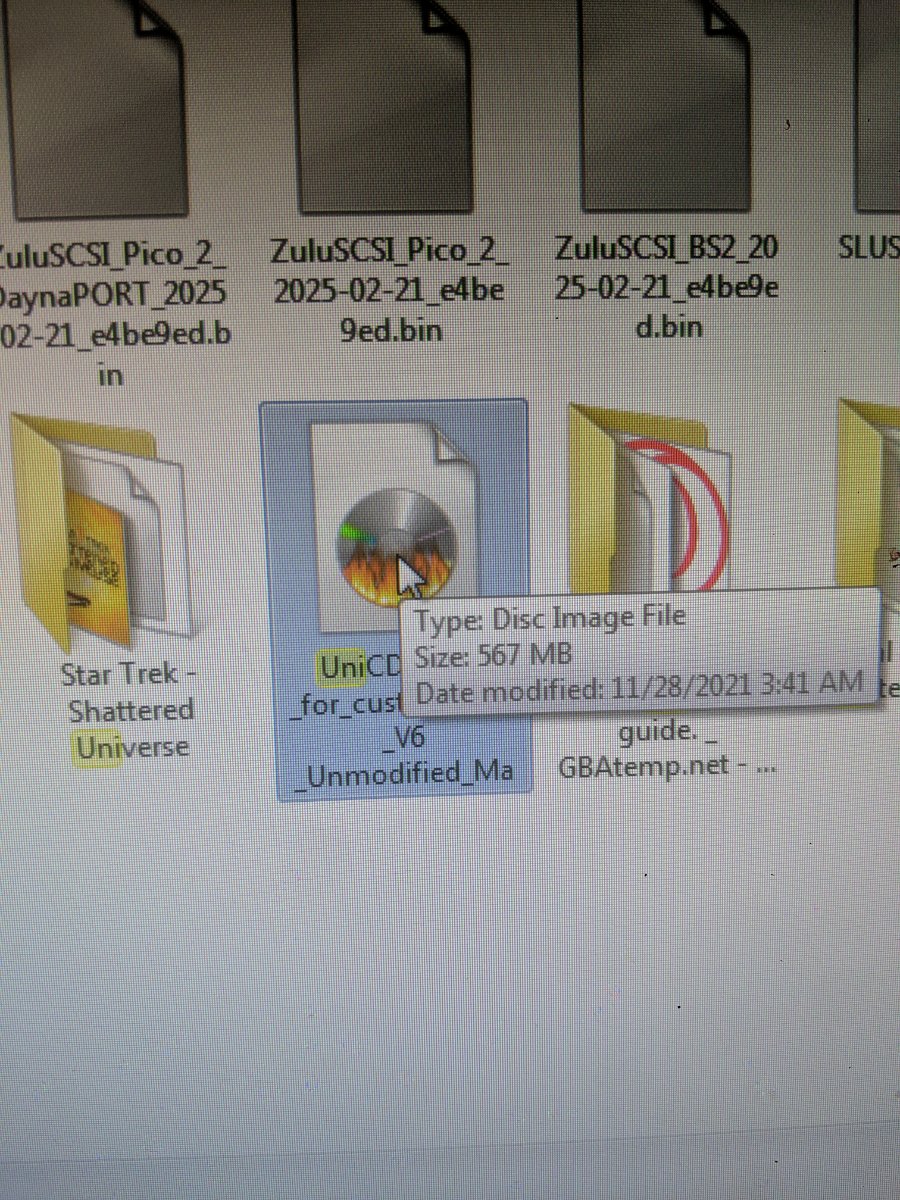

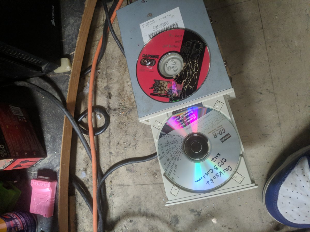

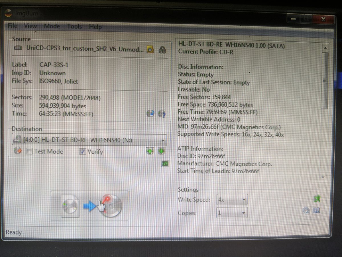

Well @cmv040 wanted to make this board into a multi down the line. I told him I had the extra 128mb he would need and could convert his cart. Just burned the CD and converted the cart writing 3S right now and so far so good.
