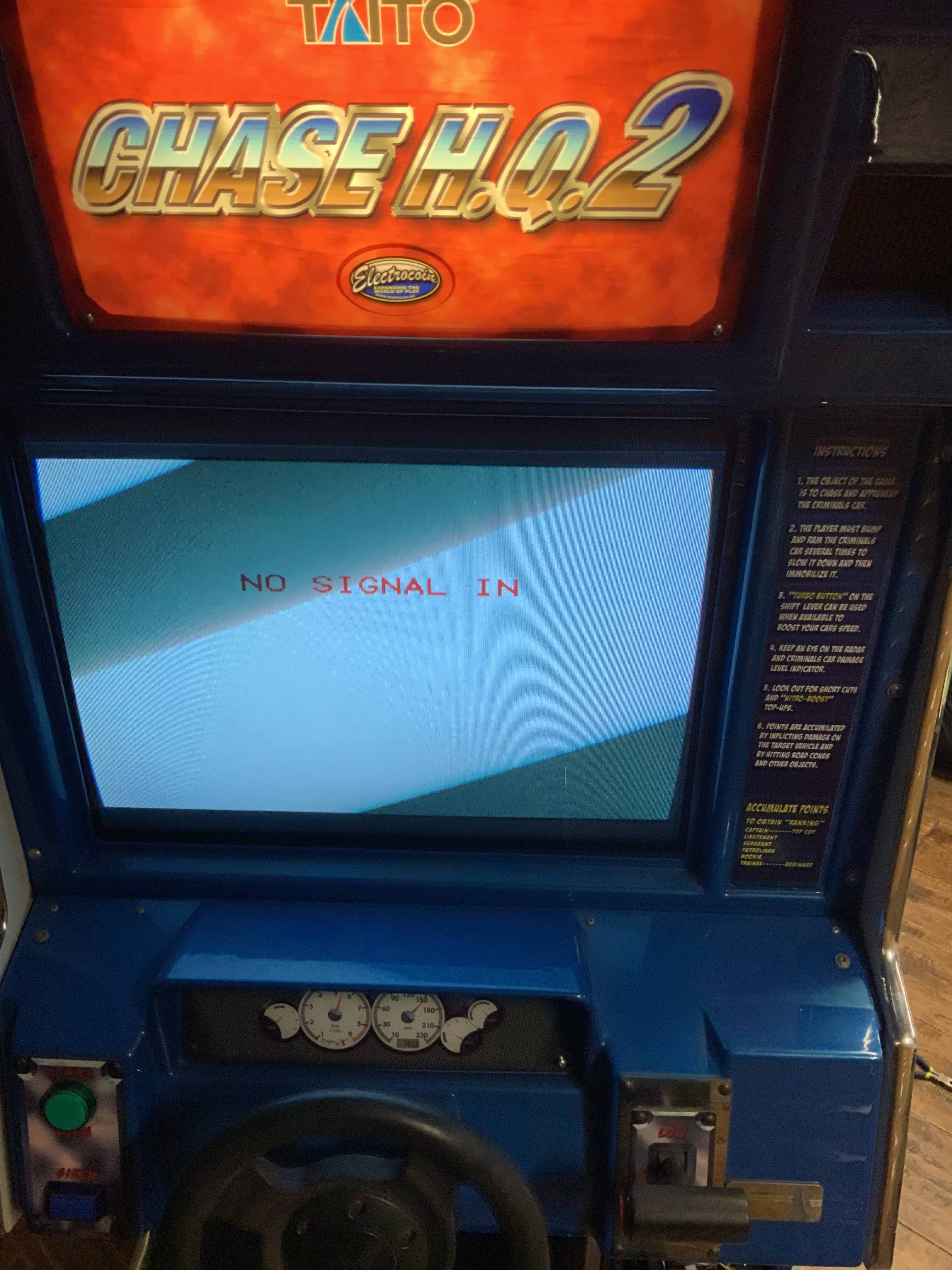

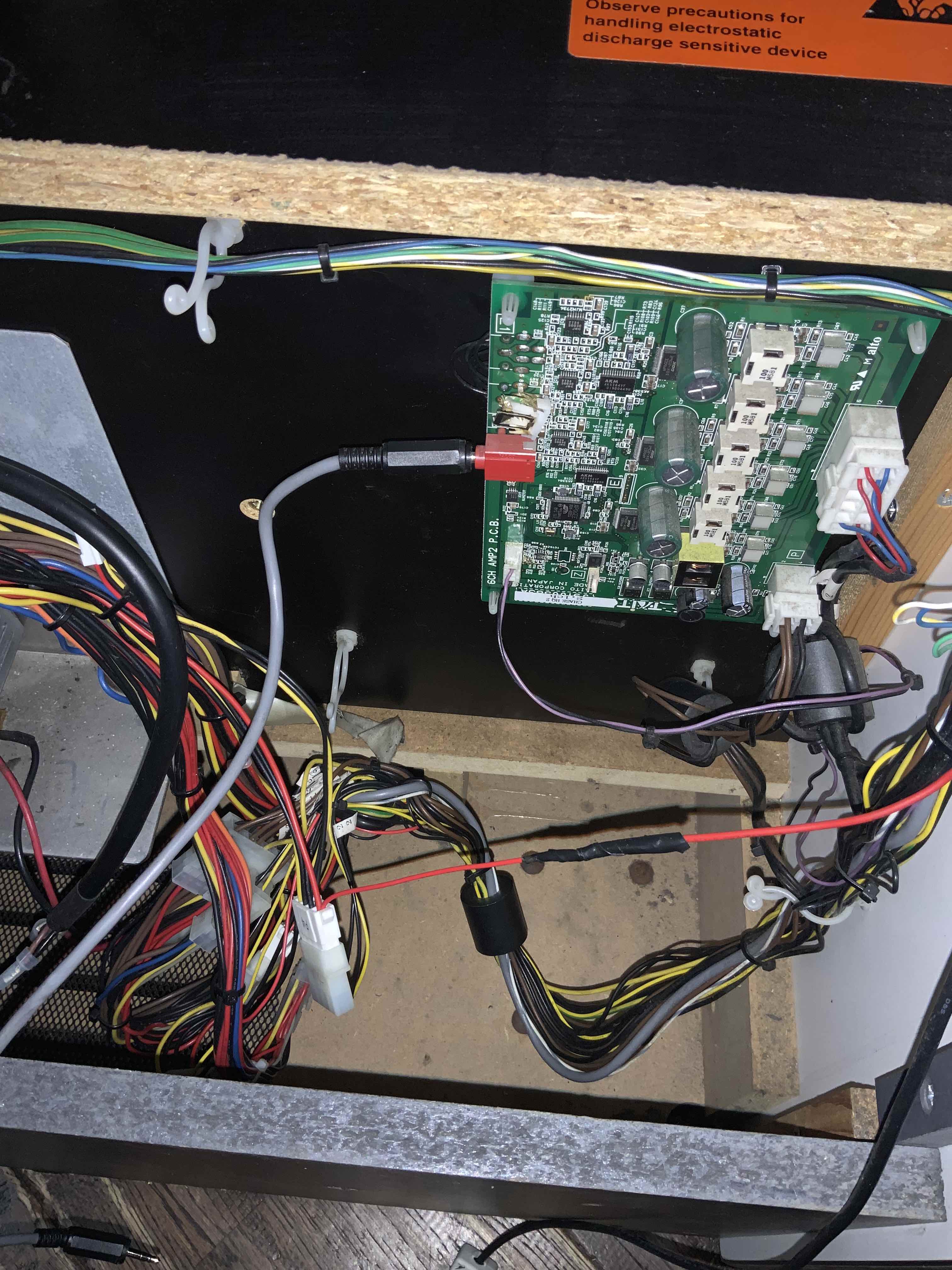

I recently purchased an original Chase HQ 2 sit down cab, but sadly when it arrived some wires weren't plugged in on the game board and there may have been an existing fault with the graphics and sound, however I did play it working before it was shipped, the only issue then was sound only came through 1 speaker, everything else worked. Upon inspection of the sound amp (pictures attached) it looks like the right channel jack input has been pulled off so I will need to solder a new one on there to get stereo sound.

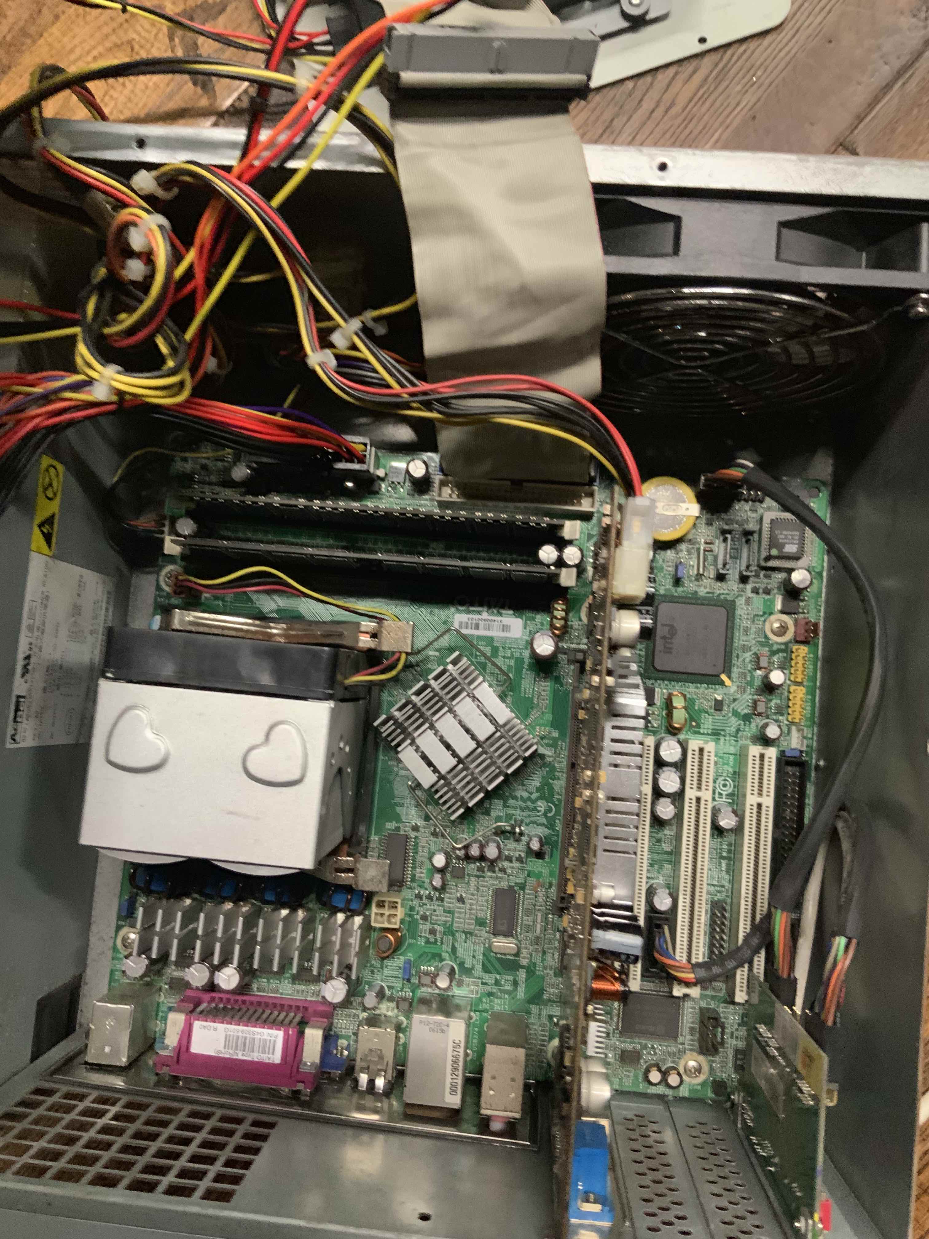

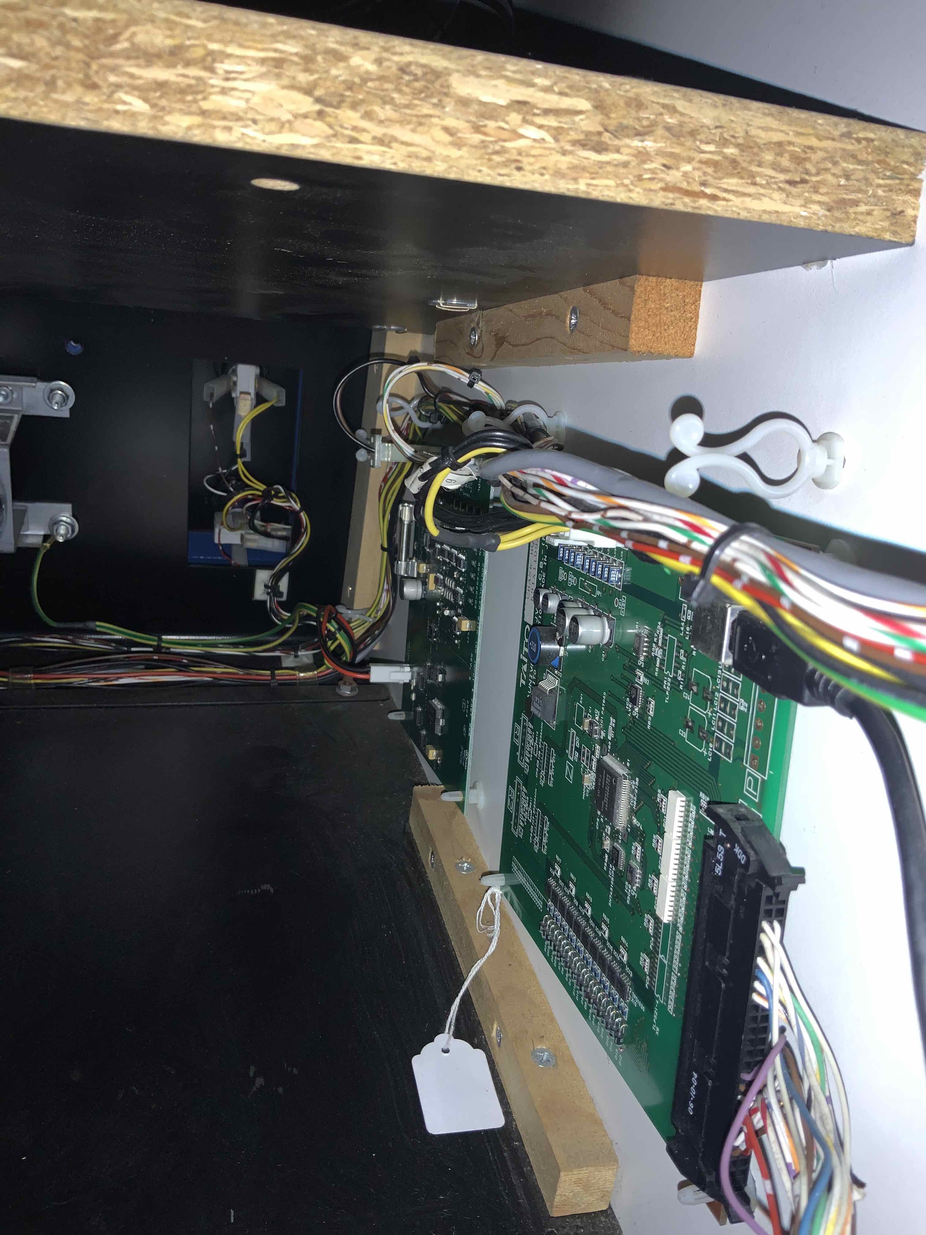

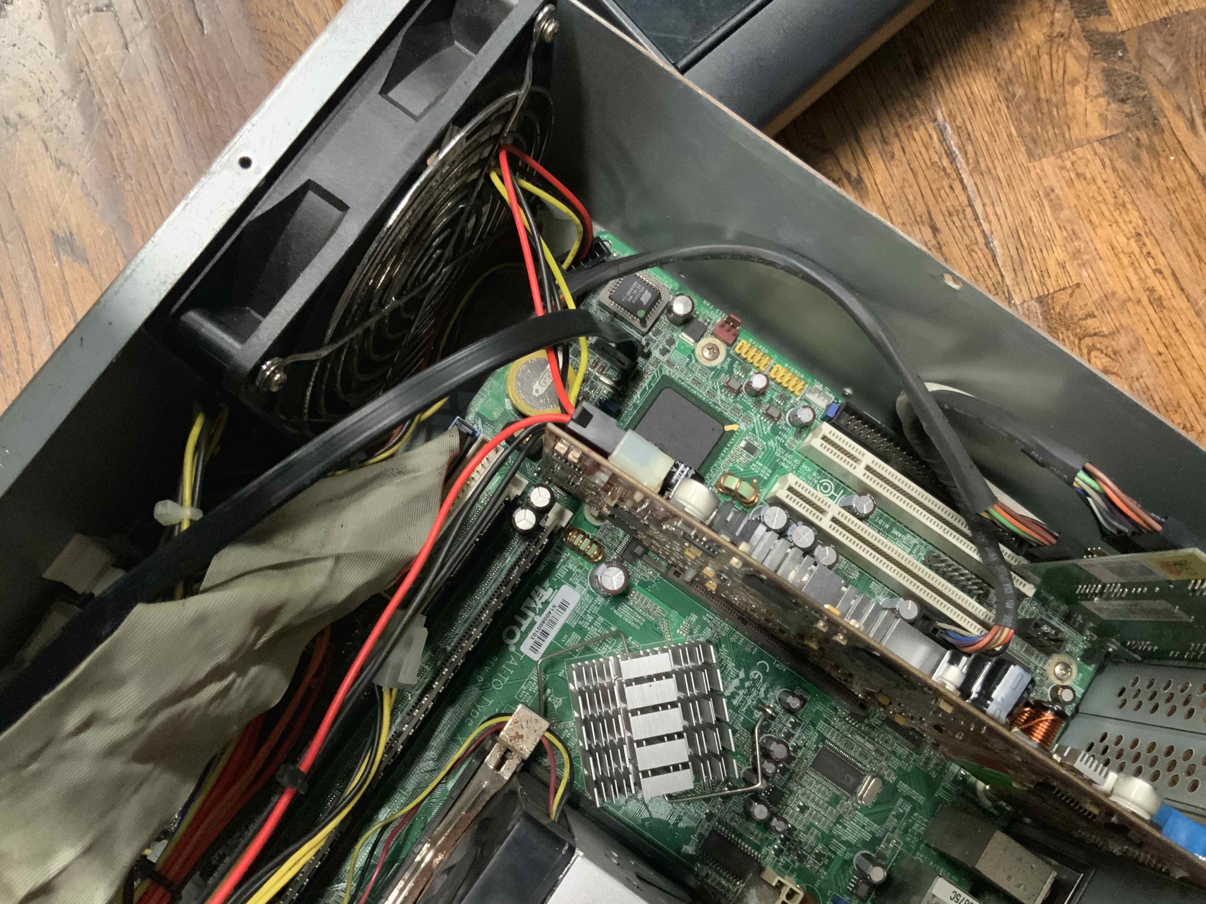

I had to replug in the hard drive and the monitor boots up fine with a "no signal" message and the PC also powers on with the CPU fan spinning and the motherboard LEDs lighting up. It also looks like the PSU has been replaced, I can't get any picture or sound through the graphics card but I have managed to get a boot up screen to come through the monitor using the onboard graphics, if I take the AGP card out. The game passed the initial HD check and then gets stuck on an IO error screen. I have tried to click past this to see if the game will boot using a usb keyboard and mouse but the X+ wont pick those up, so I have ordered some USB to PS/2 adapters and will try those when they arrive. I also had to plug in the Taito IO to the motherboard so I may have made a mistake there (I have attached pictures).
I have tried switching the AGP graphics card for another X+ compatible card that I know works and I still get no picture, so I am thinking it may be the AGP slot. I was told by the seller that the picture always came from the VGA port on the AGP card, but I have a DVI adapter at home so will also try that as well tomorrow, as I would prefer to get it working with the dedicated graphics card.

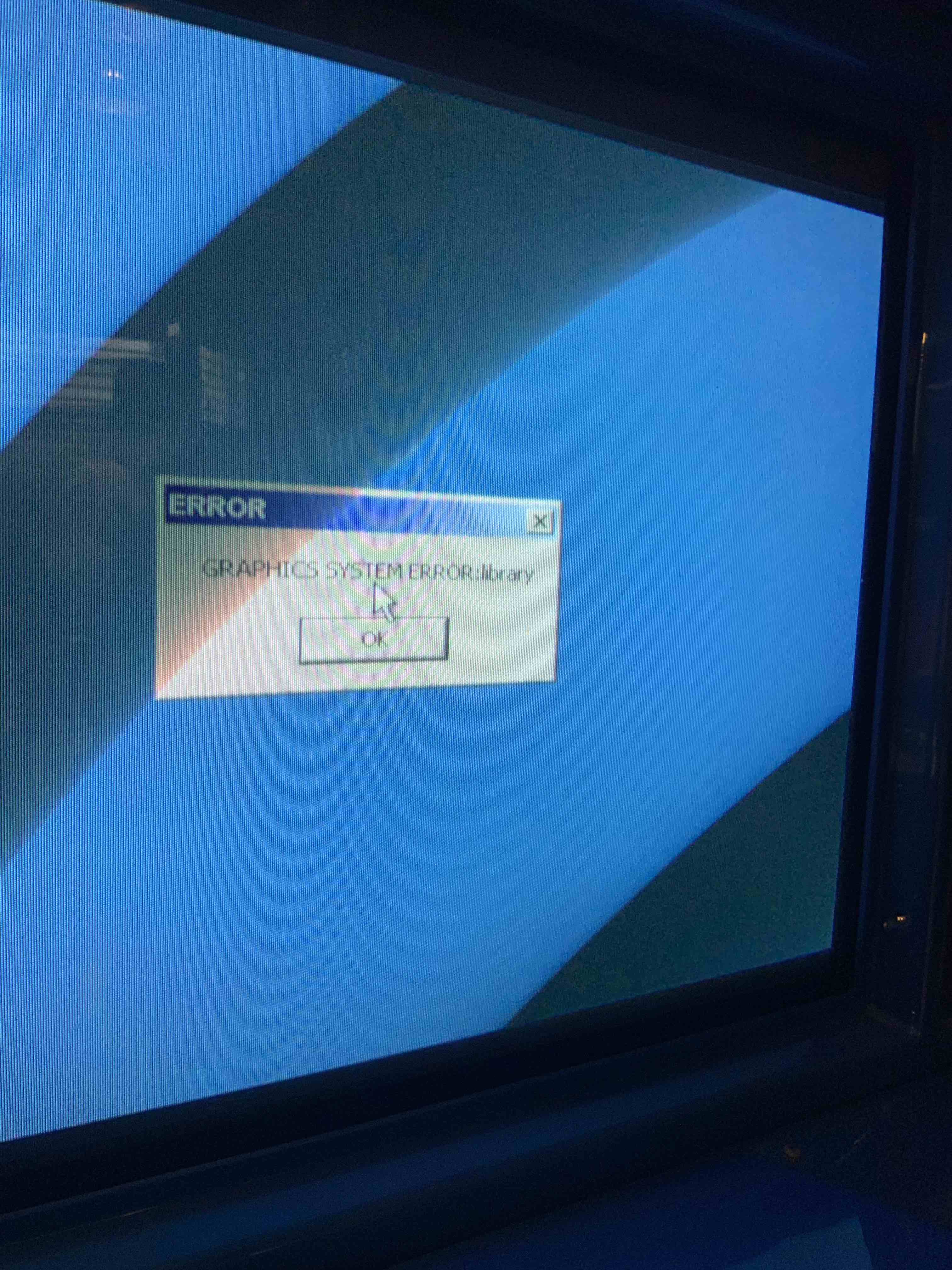

I am at the unit now, I have managed to wire the IO correctly in the original X+, which has removed the IO error I was getting before and my PS/2 mouse adapter has worked, so I have been able to click pasT the errors. I am still only able to get a video signal from the onboard graphics with the original AGP graphics card removed. Which is probably why I now have the error "GRAPHICS SYSTEM ERROR:library", when that is clicked past I get a Japanese error message, I can partially translate as "game.exe - Application Error" and the message "cannot read memory allocation 0x004625cb and 0x000006e8. Please click OK to restart program" which then restarts the X+. I am thinking it is either a corrupted HDD image (probably not a dead battery, because that would show a different bios error) or/and a dead graphics card/AGP slot. Interestingly when I switch the card with another X+ compatible AGP card I still can't get a picture but the motherboard does beep and it doesn't make a sound with the original card, which makes me believe there is some communication, so maybe an uncorrupted HDD on the X+ might solve it and I could keep everything else the same. Either way, I have a hit a wall I think with the X+ without a new HDD with the original game image, I am gonna go to phase 2 and try and get the decrypted game running without JVS emulation on my PC and plug in the taito IO to my PC motherboard and see what I get, I just want to play the game on the cab! haha. I have attached some pics of the errors.

Also replace capacitors on the old motherboard and video card (as well as their respective fans if necessary). It's a common fault on most PC based arcade hardware.
