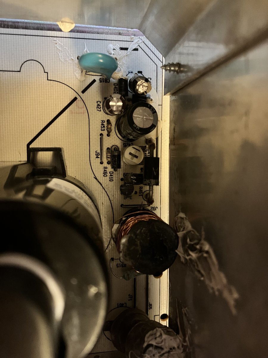

Hi all,
Thanks for the support! The PM1745 sanwa keeps blowing the 1.5A fuse.
The new one (pm1745 samsung?) has a damaged spool (one end is not wired and came off) this one however energize the monitor. I noticed it after swapping them for testing. I only need to discharge monitor with the samsung chassis when it is time to take it out.

You're definitely going to need to fix that coil at a minimum, as well as probably the component that's folded over above the R461 label (looks like it's labeled 409).
Honestly if it was sold to you working, just get refunded or exchanged.

I think i found them. The PM1745C pic is just for reference. Could this be the reason why the 1.5A fuse blows?

Yes it Is the psu area usually damaged, someone here have already replaced some parts, at least two resistor which usually fail, you have to check r804, q803 , q804 and look for any short in that area, the pcb appear brand new, probably never seen one in this condition, this must be paired with samsung tube/yoke, if you want use this chassis with a toshiba tube you Must replace the heater resistor, from 2 ohm to 5 ohm, it is a big metal oxyde resistor near the hot.
Thanks for the reply. This one is the spare i bought which doesn’t work either (damaged coil) and i have to change the oxyde resistor as you said.
The other one is packed because I was planning to send it for repair. But with your advise I will give it a try on both.
Any idea on how to repair/ replace the coil?
I'd be interested to know as well, I have one with a bunch of coils that got knocked off and unwound. No clear way to source replacements other than from a donor that I am aware of.
If the coil is not open you can rewind the copper wire if the wire is broken you can repair by soldering but the position of the ferrite core can influence the h stage for ex ample on the h linearity, on those sanwa chassis , those coils are so fragile that they glued them on the heatsink.
If you know the spec the coil can be reproduced. It Is an odding balls job too.
