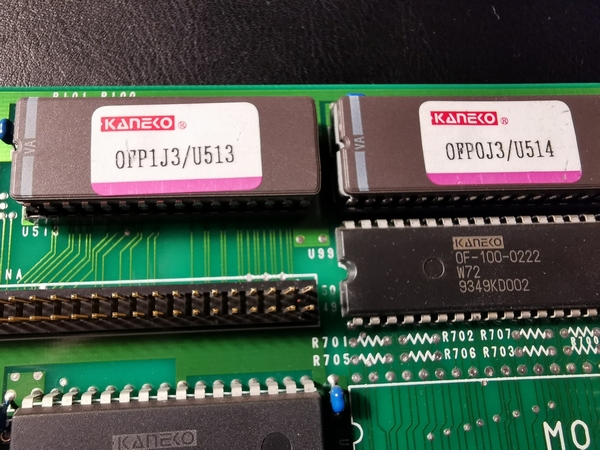

I have a Oedo Fight board, which is the censored version of the game [no blood, no gore, no fatalities]. I'd like to convert it to the "bloodshed" version, which is ten times more fun because of how ridiculous the gore is. The Western version is called Blood Warrior for a reason. Anyway, the game is actually two PCBS layered on top of each other. All of the ROMs are on the bottom one. Only three are socketed:

I really love this game, truly and unironically. Used to play it with friends all the time, which was insane. Sure, it's severely broken in the balance department, but man, it's so much fun.
The mame driver will show you what files are the same between games, just look at the crc values. Bloodshed is enabled in either test menu under "Memory Switch Setup". Pretty sure all you need is one rom swap, socketed ofp1j3.513 <-> ofp1f3.513 to change between games

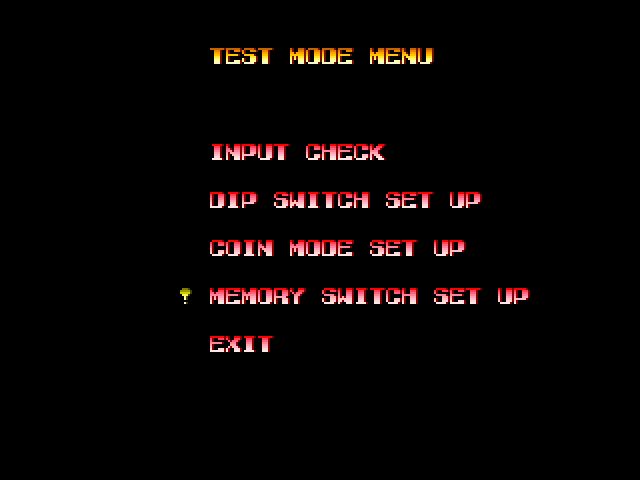

That would mean swapping a file from the Japanese set to a file from the Blood Warrior set? I'm ordering some 27C4000s and 27C010s as I type this. I guess with China's shipping times, we'll find out in about a month.
It's weird that MAME doesn't even have the non-bloodshed version listed as an available ROM set variant, which it obviously is, because I have a board of this version. It lacks the violence settings in the test mode menu.
As you can see, everything is, oddly enough, under "memory switch set up", a section that my board completely lacks.

I have that romset/abomination too, actually. It's not in mame. In that case you'll need two 27c4001 or equivalent, and you will need to swap the 513 and 514 chips to whichever you want... western or japan version.

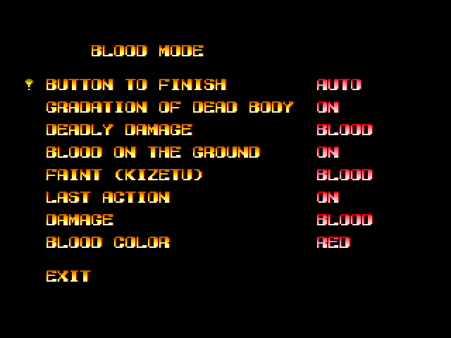

50
Status update! Finally got the chips and I have to say, I wish all of my projects went this smoothly. The conversion is officially a success! All I had to do was to replace ofp1j3.513 and ofp0j3.514 with the Bloodshed ROMs. Two 27C4001s, a MiniPRO, MAME Bloodshed files and it's done. I posted some images on Twitter for those interested. This also gives me the Bloodshed menu with all of its crazy violence settings.
