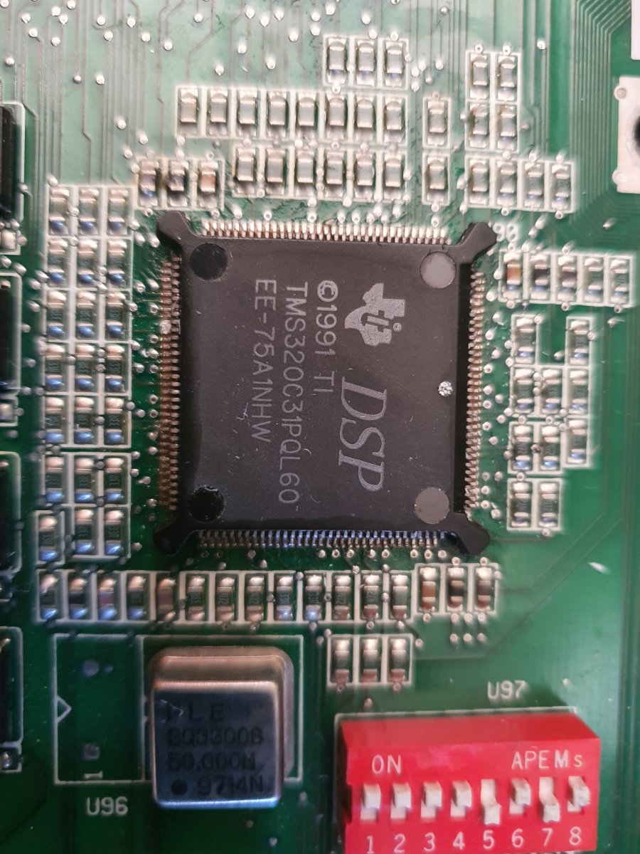

I bought a Offroad Challenge arcade and on the pcb is a chip with the number
DSP 1991 Texas Instruments 33pin
number TMS320C31PQL60 and the second number EE-75A1NHW, that chip is broken and I just wanted to know if there is a replacement chip or can I buy a empty chip and program it or does anyone have one that I can buy.

It's a floating point processor. There are pulled chips on Aliexpress for 5-10 bucks. May or may not work, but worth a try at that price. Be advised, they will take forever to get to you with standard shipping.

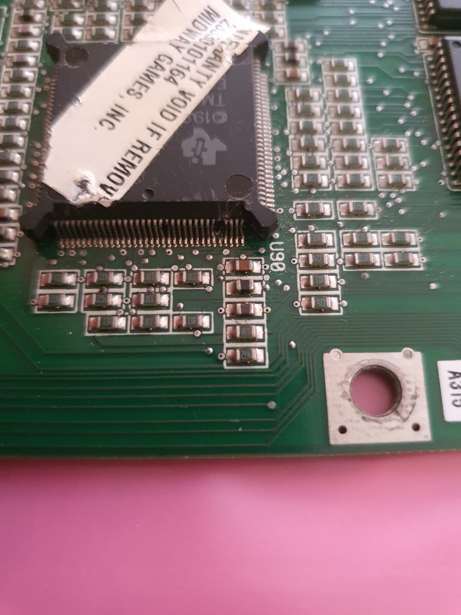

I just wanted to check, this is the chip that I have to replace,
That's the one.
How do you know the one you have is faulty?
Some of the legs have been broken off, unfortunately that's how I bought the pcb, just wanted to know if the second number EE-75A1NHW have to be the same as the original number because I can get one from ebay but the second number EE-75A1NHW is not the same, the first number TMS320C31PQL60 is the same

Oh yeah, that's definitely going to be an issue.
I suspect the second number is just a batch number. It being different won't matter.
