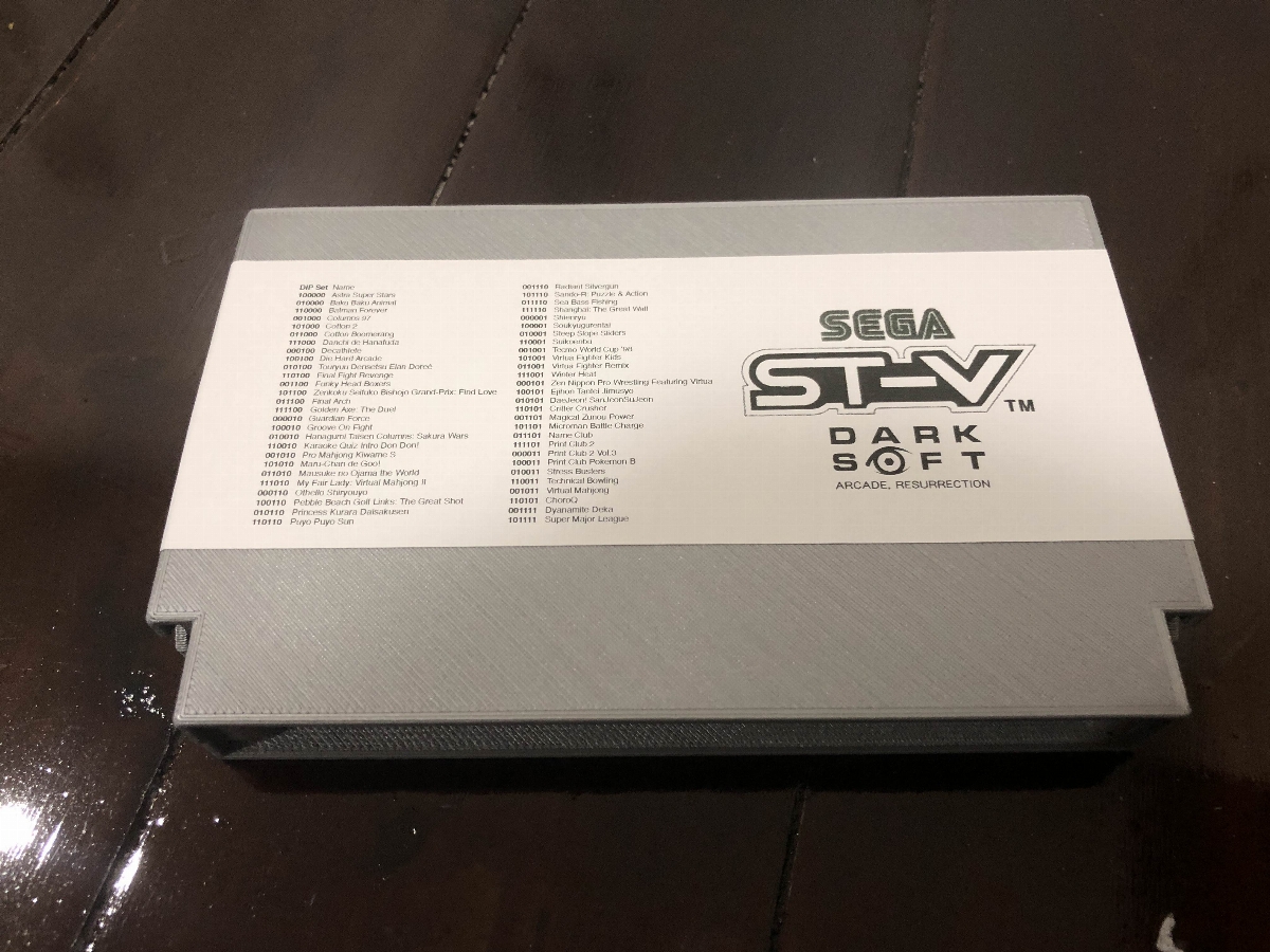

Just got my ST-V Multicart, yeah! Only thing I'm a bit confused about is which pack is best to use. The one linked above or @SmokeMonster latest rollup pack? I verified that the games/ contents actually differ.
Likely not the most beautiful label, but it gets the job done for now ;)
That's an outdated pack, definitely use the Roll-Up.

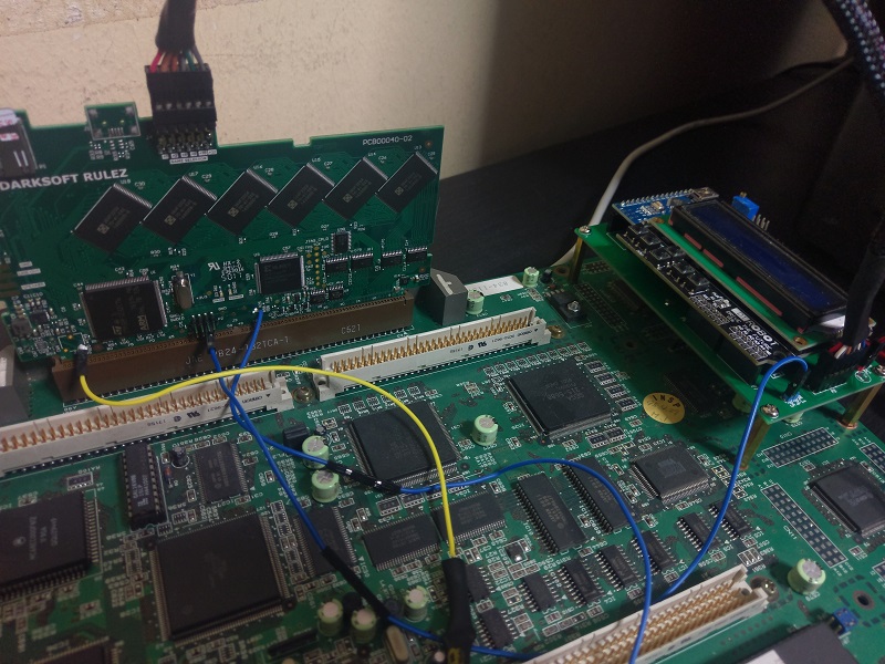

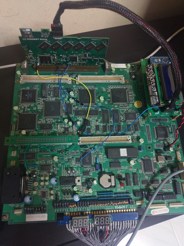

Hi, I have received the multi cart and set it up straight away.
After flashing the game doesn't boot. As per instructions there are 2 LEDs during flashing and 1 LED once the game is flashed. I have also connected the wire for the sound and there is a clear start and end sound.
I have tried with original bios and multi bios and the hook up looks correct to me.
Based on the 2 pics can you help me check what I may have connected wrongly?
Thanks
Try narrowing down the source of problem. Remove the LCD screen and set the jumpers to a specific game. See if it flashes correctly. After flashing does the console reset? If it doesn't power cycle and see if it boots properly or how is the cart recognized by the BIOS? You should see the name between [ ] brackets
Thanks for the quick support!
The problem seems to come from the motherboard as the TV does not receive any signal regardless of the Multi cart inserted or not.
I will have to find a way to fix the board or get new one :(
Thanks
those sh2 processors tend to fail a lot. Try applying some pressure. If it improves then a solder rework might solve the problem.
Pressing on the SH-2 didn't work either.
I am afraid I need to get a new board as I don't have the skills to troubleshoot it especially when there is nothing obvious such as a blown cap...
