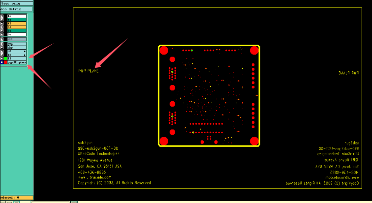

Hi! I was going to try to build this, and I submitted the Gerbers to PCBWay, and here's the message I got back:
"Thank you for your support,there is an Engineering question of order W353380AS3D5.
As shown in attached pic, there are two l3 layer designed in your file, pls confirm which one should we follow?"
I am not a PCB designer, so I have ZERO clue. @shanki91 could you help here, or see if you could ping your contact at NanotechGaming to ask?
Thanks!
--Dave
