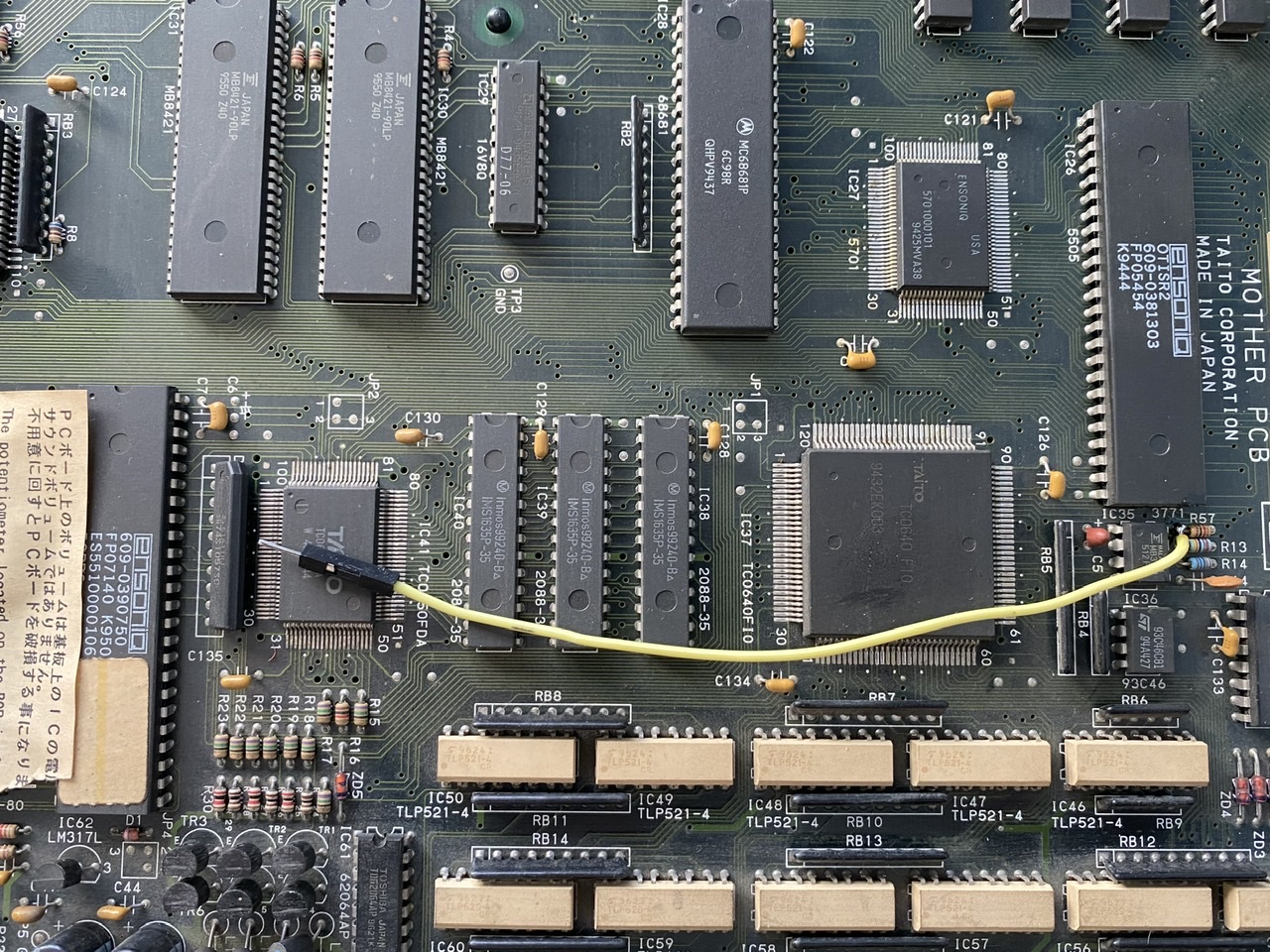

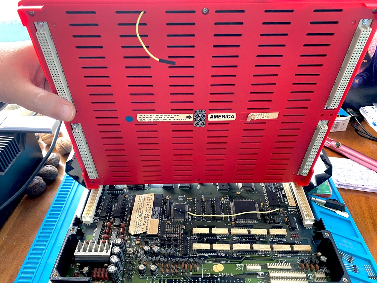

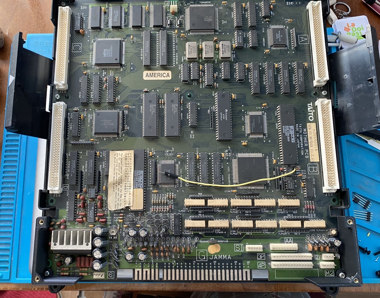

Finally, i reinstalled the Lions3 kit on my motherboard and i decided is much better with reset wire installed and i proceed in this direction ✌️
Thank you Mitsu & Darksoft for this ^^

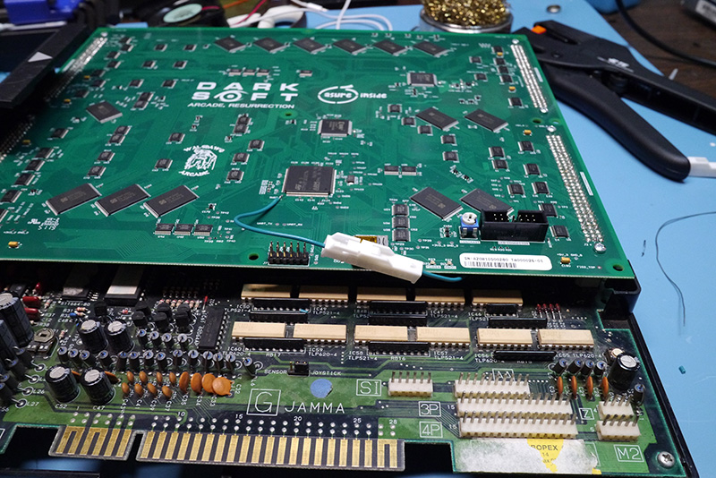

Just performed this mod, not because I think some glitched looking images will destroy my monitor, just "feels" nicer. Working great!
I used JST YL wire to wire connectors, because they're one of the few connector series with a single position type (matching the gauge needed) and I'm not a fan of using dupont style connectors this way

And how you managed to close the multi in the F3 cartridge case sir ? How it looks with case ? ✌️
