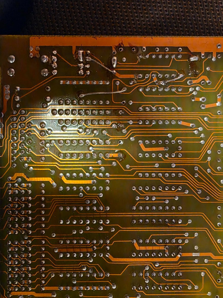

This board also shows a lot of factory rework (extra solder joints, cut traces). It looks original since I’ve noticed exactly the same on other orange boards being sold.

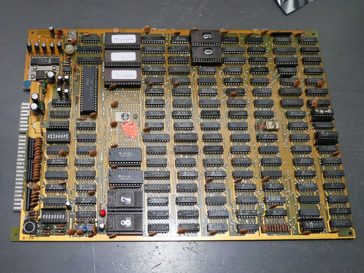

I recapped mine. Perfectly loud. Try that first.
You likely noticed, but you can replace the axial capacitors with radial lead ones. There are alternative solder holes available.
Picture of my board.
Mine also has the freeplay and highscore save enabling roms from Gadgetfreak.
Thanks! Yeah, I noticed the possibility for radial caps but was able to get the axial ones. I will recap and then see.
Mine has quite some rework done, with traces cut and sometimes different components. It seems factory done (I think to fix the coin input issue), as I've seen exactly the same applied changes on multiple boards. Don't think that is related to the sound issue though.
Not necessarily a bad choice. Axial capacitors with their lower profile have a lot less chance of being ripped off the board.
