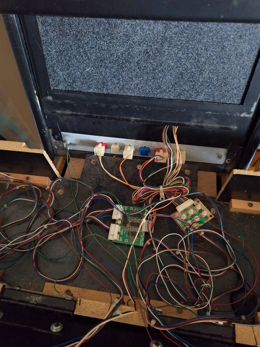

There are a couple issues.
Player 2 button won't work and not sure why. Used a meter and there is power going to it. Both the switch and button itself are fine, it's the Player 2 specifically that won't work.
Need to hold down P1 button as I go through the menu options, otherwise it constantly flashes as if P1 was being pressed rapidly. Not a huge deal once I calibrated the guns, but regardless wondering why as it might be related to the P2 issue.

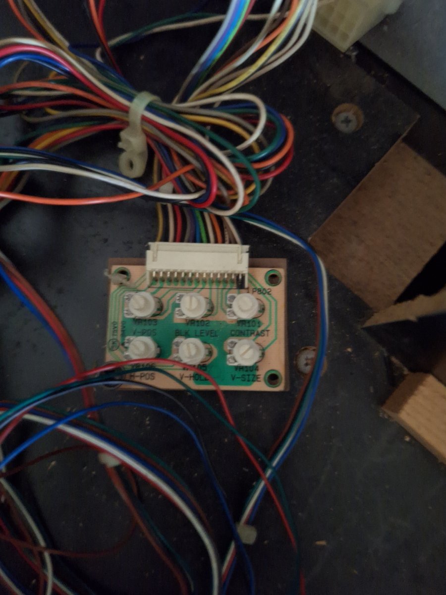

Unrelated to that but I want to know how to adjust the screen width. I can adjust its height and move it left or right using the knobs, but want to narrow it slightly so targets on the ends are visible. Any ideas?
It's probably a coil on the chassis. It will have a ferrite bead inside that you can turn with a hex key.
I'm not seeing a coil on the chassis. It possible to be some other spot?
Edit: found the coil. The rest remains an issue. ;(
2nd Edit: also solved the P1 issue so now it's just P2 button not working
P2 was both a bad wire and switch. Was a pain to figure out.
The coil on the chassis isn't solving width screen problem, so removed the board and going to check the caps.
