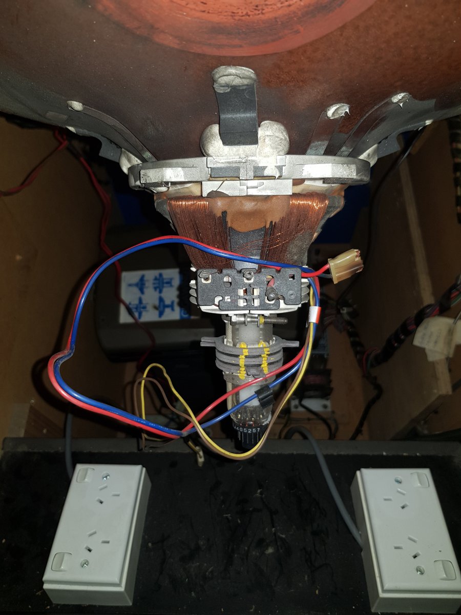

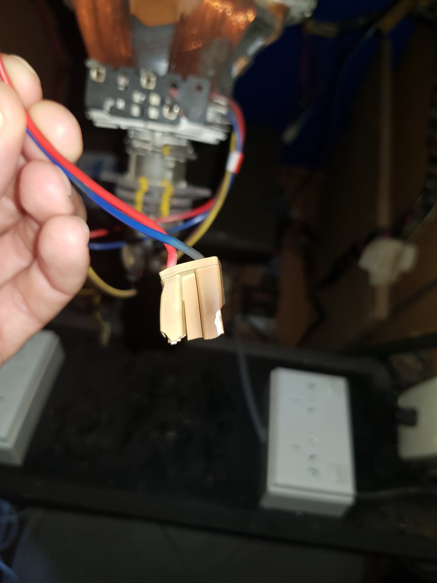

Seeking assistance in ID (part number etc) of a connector as pictured for a Toshiba tube and MS9 chassis.

I cannot find these description parts through RS online- what are the equivalent parts withinnthe mouser/digikey/rsonline catalogue?

JST has matching connectors in the LV Series, but I would be surprised if RS carried them.
https://www.jst-mfg.com/product/detail_e.php?series=162
2P-LV for housing, SVF-01T-2.36LN for pins.
You can order them straight from JST, but I don't know what kind of MOQ requirements they have for them.
That's all I got. You can search for other compatibles ones with 2.36mm diameter pins and connectors with 10mm pin spacing.
