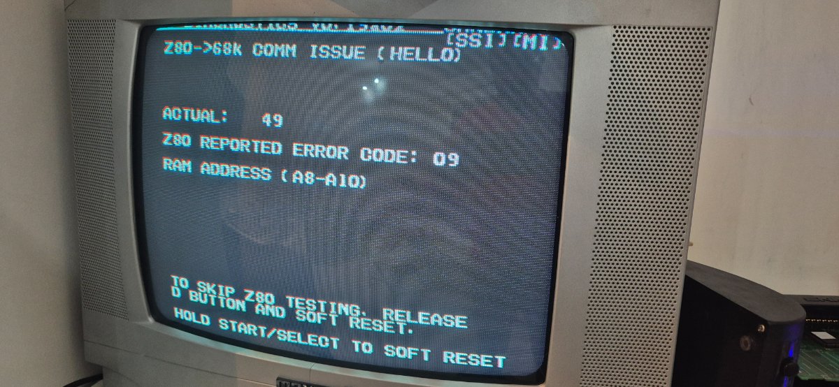

After the last repair a few weeks ago of my MV1FZ slot, which had a sound problem due to the neoC1 that i replaced, I start having a similar problem, once again.
The sound seems to be missing tracks, and always cuts off at the same place, at the beginning of the intro.
After a test on the Diag with its card, I see this error. Where should I focus?
Update.
Swapped IC 6126 and track are playîg normal now! A blind shot to be honest lol.
But the sound is still very weak. Already swapped volule pot and made a full recap. Still weak.
Anything else to think about?
