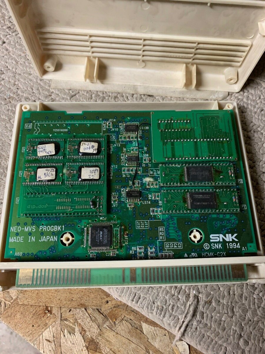

I've seem an EPM7128STC100 been used on a bootleg posted here before, would that work too?
Yes indeed, an EPM7128S would be up for the job. The pinout is different though, so a different board would need to be designed.
I didn't chose those chips because they aren't made anymore and I didn't want to deal with counterfeits sold as NOS, but it might be worth giving it a shot.
Never seen such a repro used in a bootleg before, very cool find !
Another example showing that bootleggers were ahead of their time regarding preservation. If only they had shared their findings at the time :P
