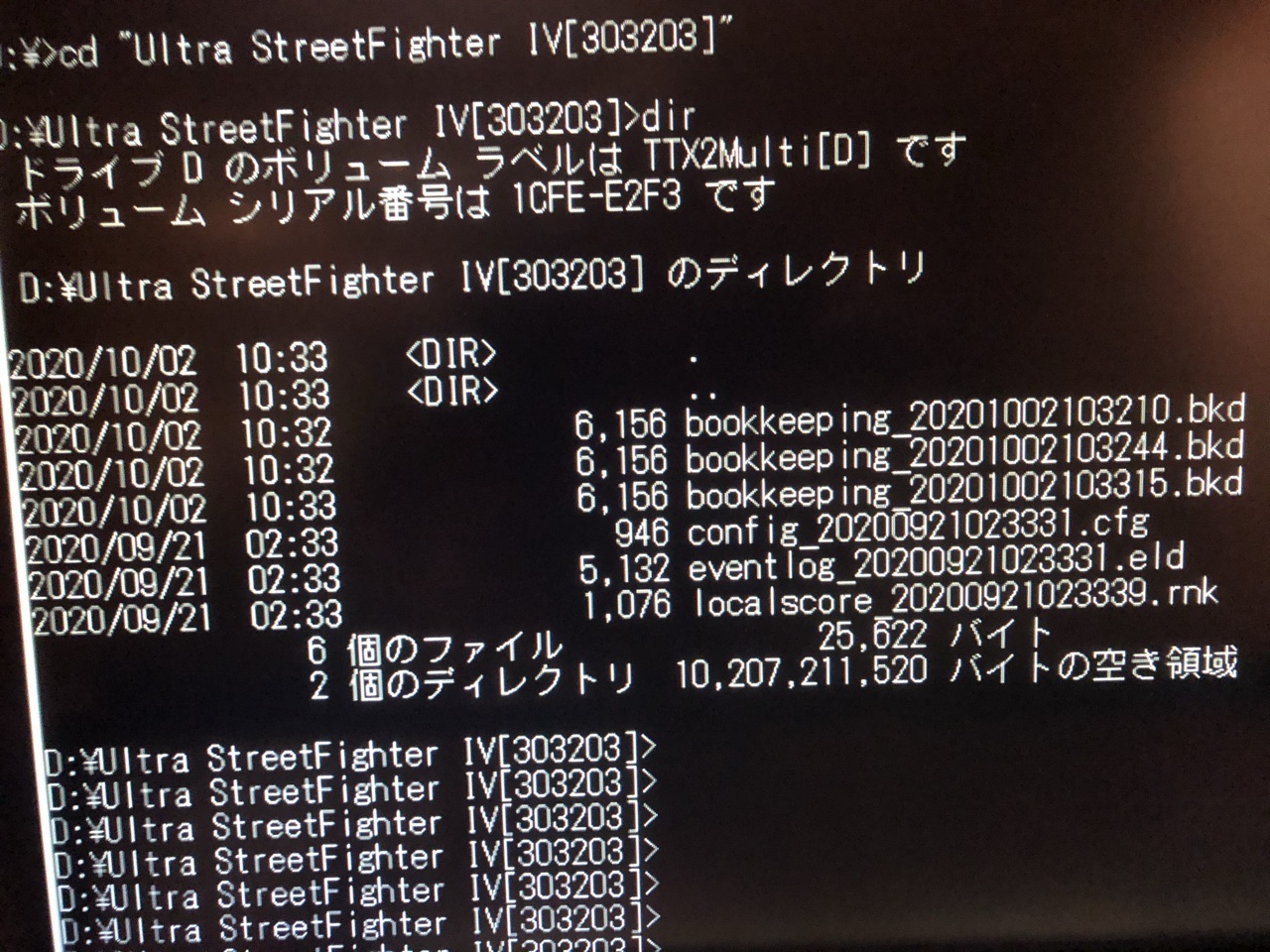

Are files being written to the respective game folder on D:\?
TravistyOJ
Jul 21, 2015
51
17
Yeah I see the files being written to the folder in D:

Oddly this just started working for me. I changed the settings again relaunched it, then power cycled it and settings were retained. But for some reason they weren’t keeping before
Niko
Sep 22, 2015
976
1,430
Louisville, Kentucky
It might have something to do with how you're exiting the game after changing the settings.
For example, if you change the settings and then play the game for awhile before just powering off the system. The writes might not ever be getting flushed to the disk. Were as if you change the settings then exit the game and start another game the OS might flush the writes to disk.
