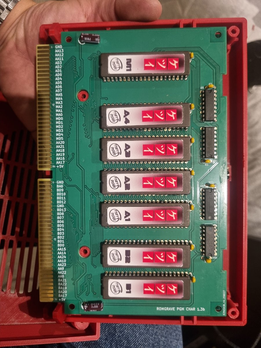

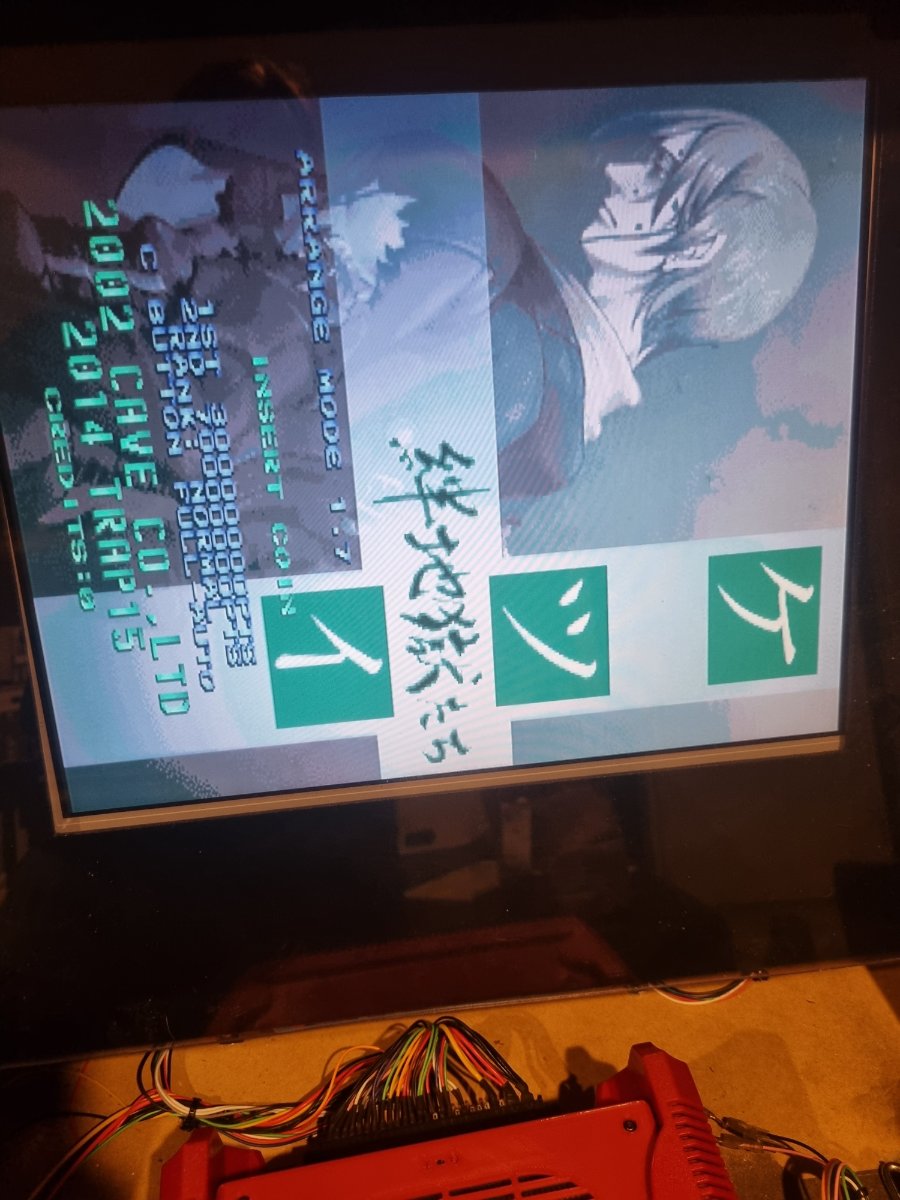

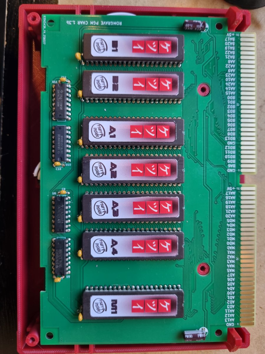

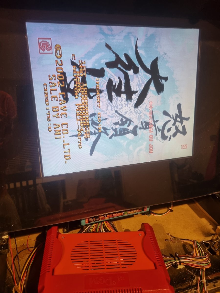

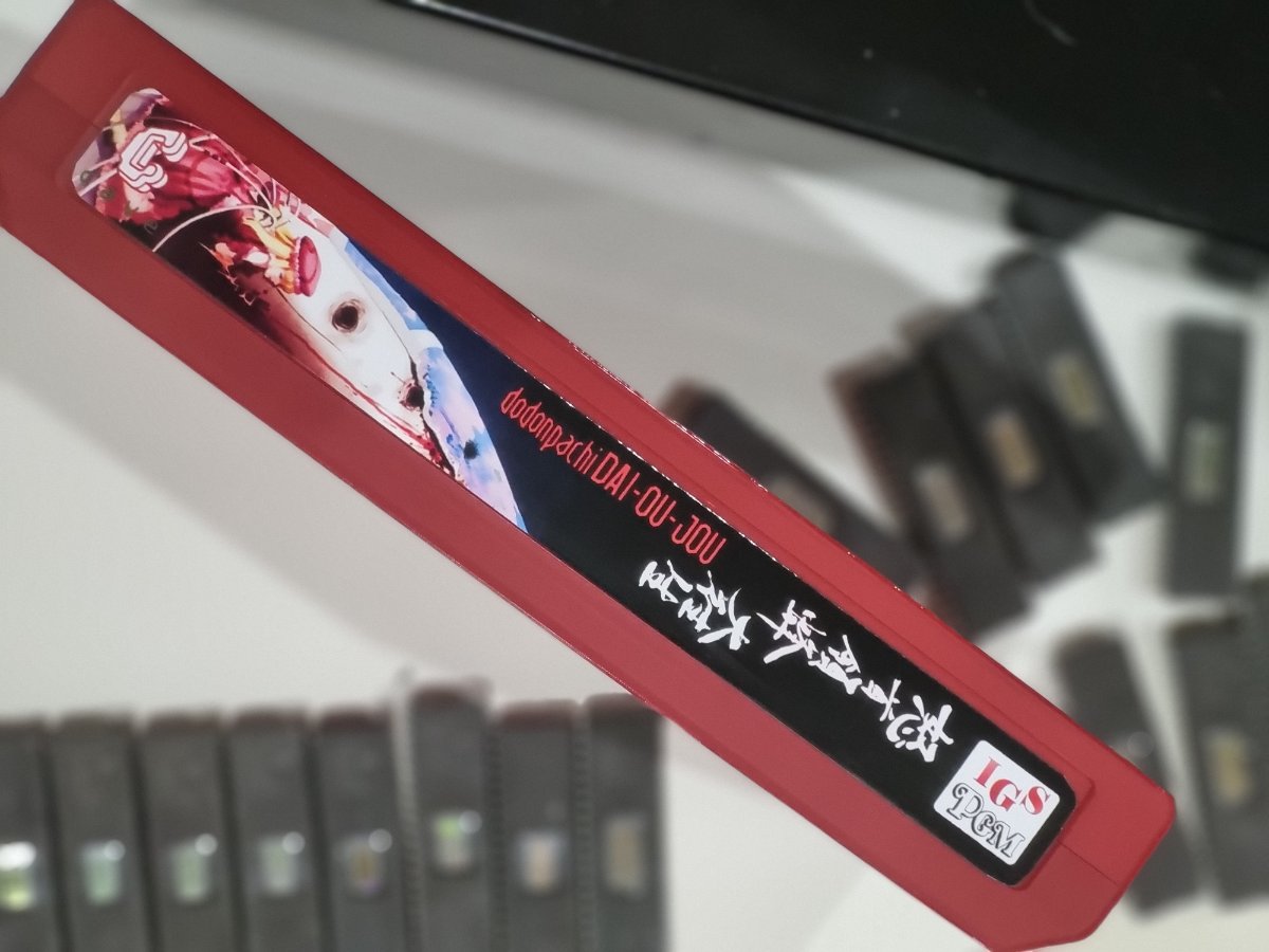

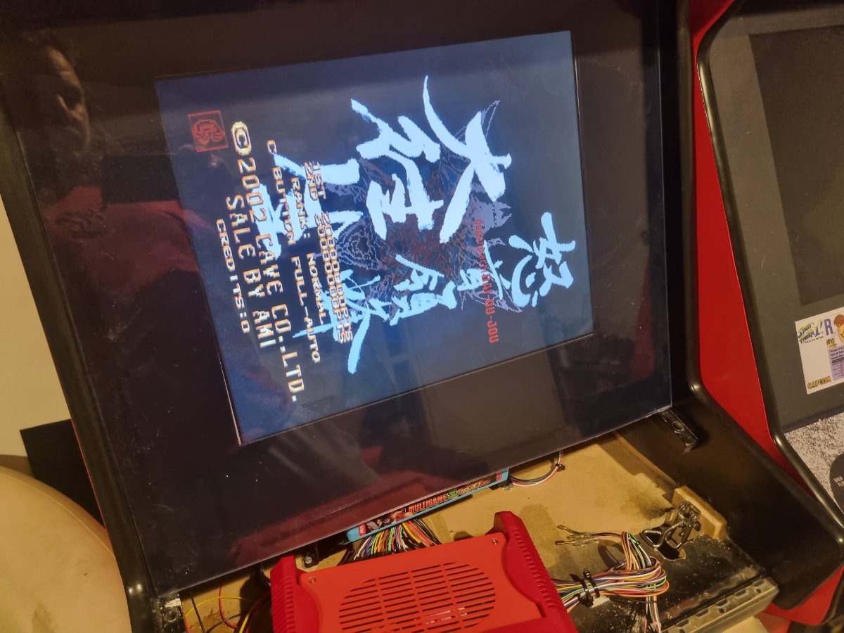

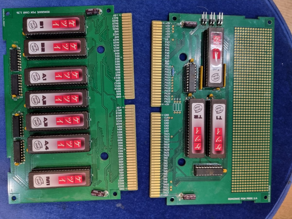

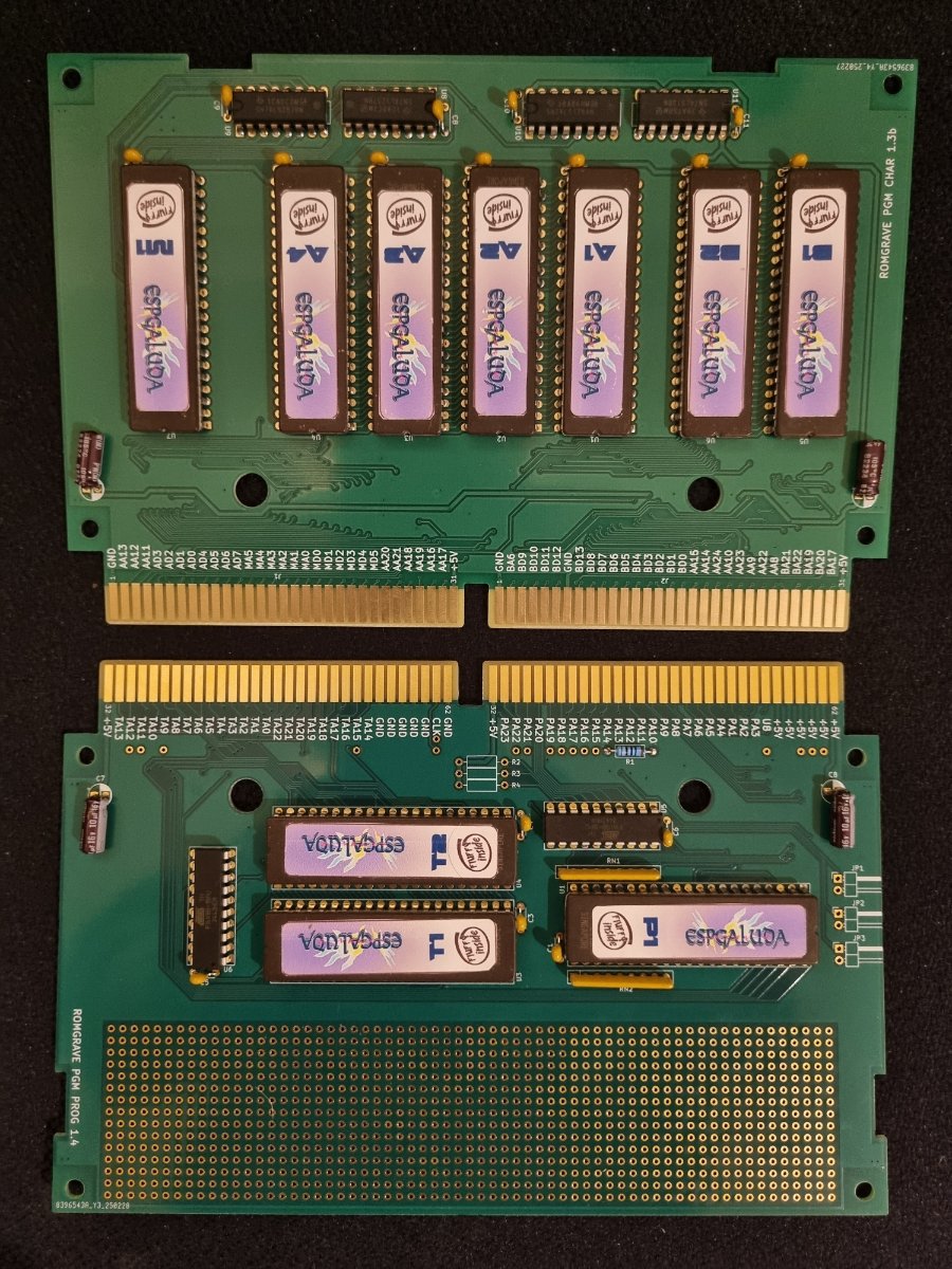

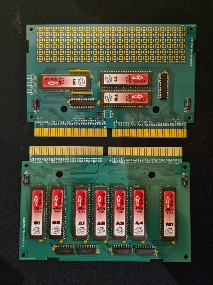

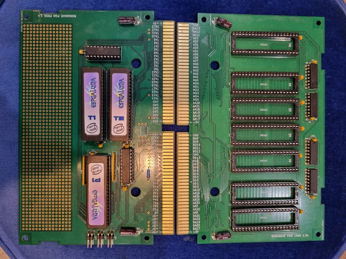

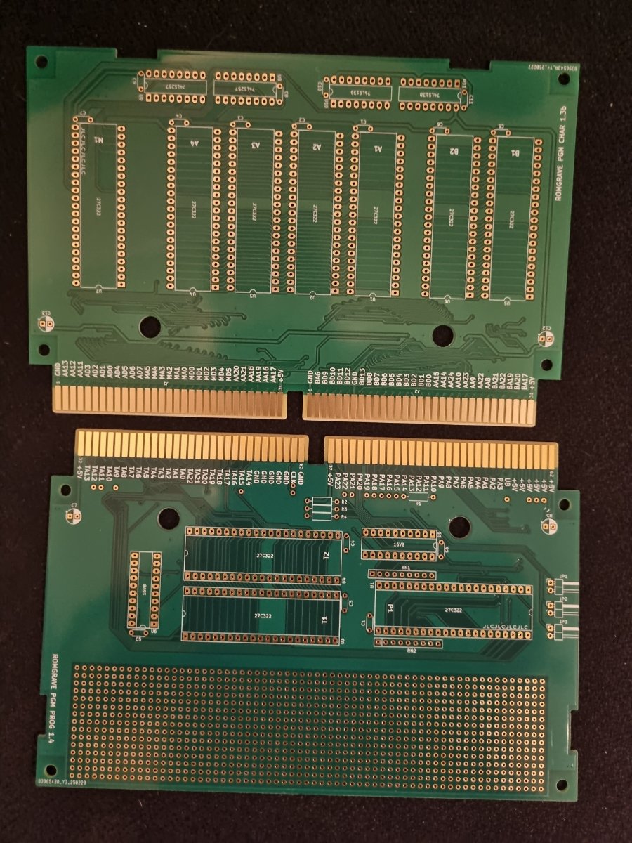

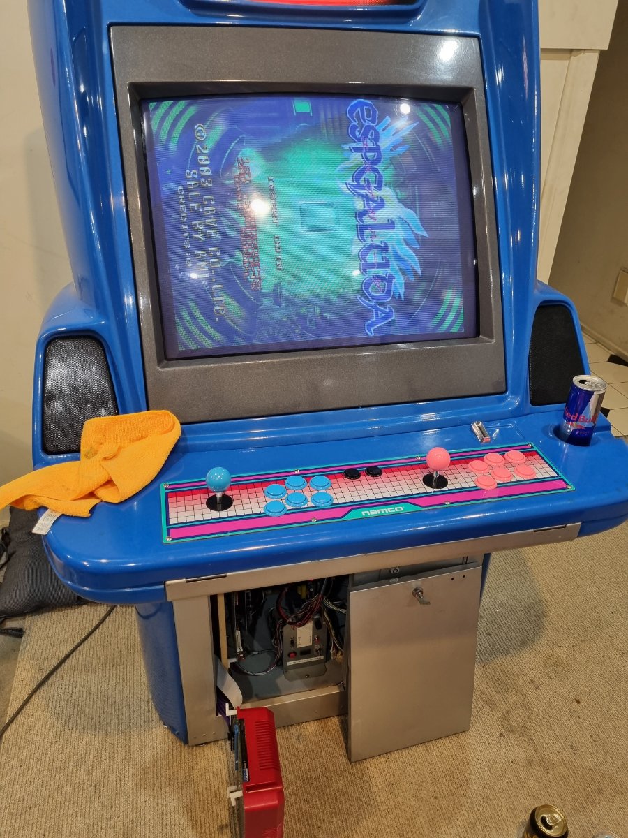

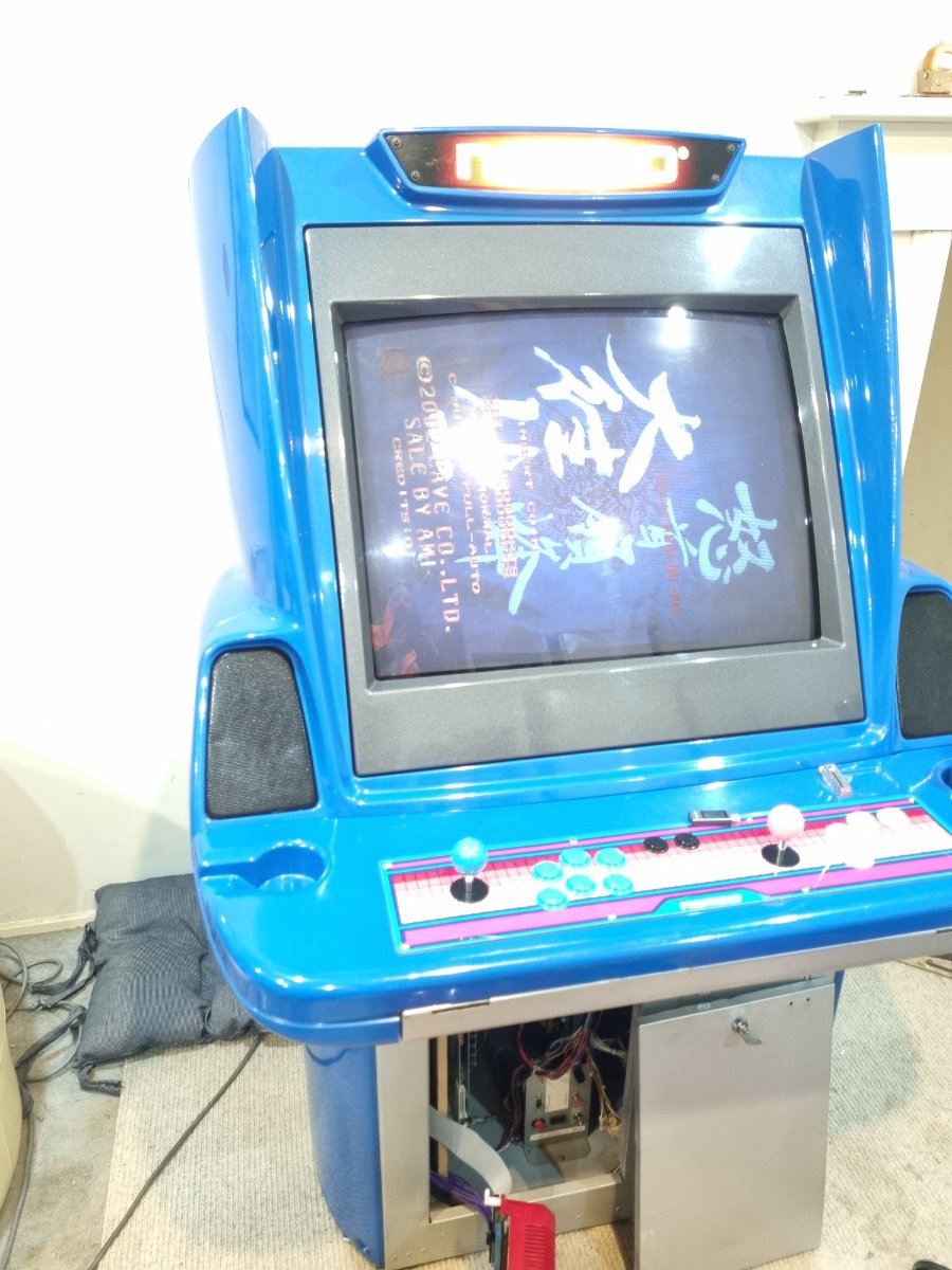

So I built a fully socketed test board to build these from and it works great. Once I have the EPROMS and PALs working in the socketed board I solder them in directly on a pcb blank.
Have EspGaluda and DDPDOJ dual boot working and ran out of EPROMS just before I finished Ketsui. Generally I am getting about 1 dud in 10 from a supplier I have been using for a while. Moat of these are not blank and if the take longer than 20min in the eraser I am shelving them as the are likely almost done anyway. Frustratingly the EPROM I was short on Ketsui wrote and verified fine but it left me with corrupted graphics. So the wait for EPROMS starts again.

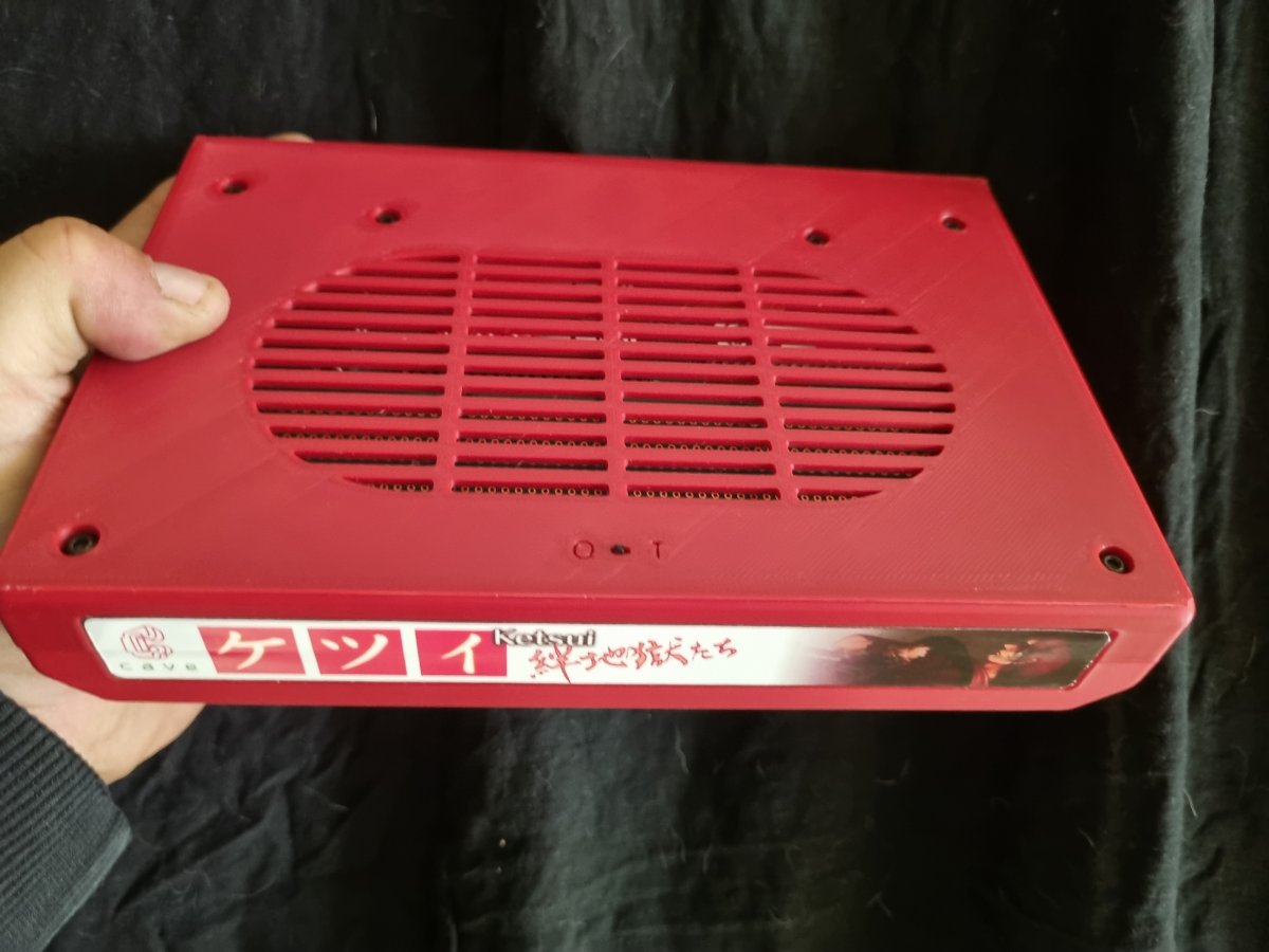

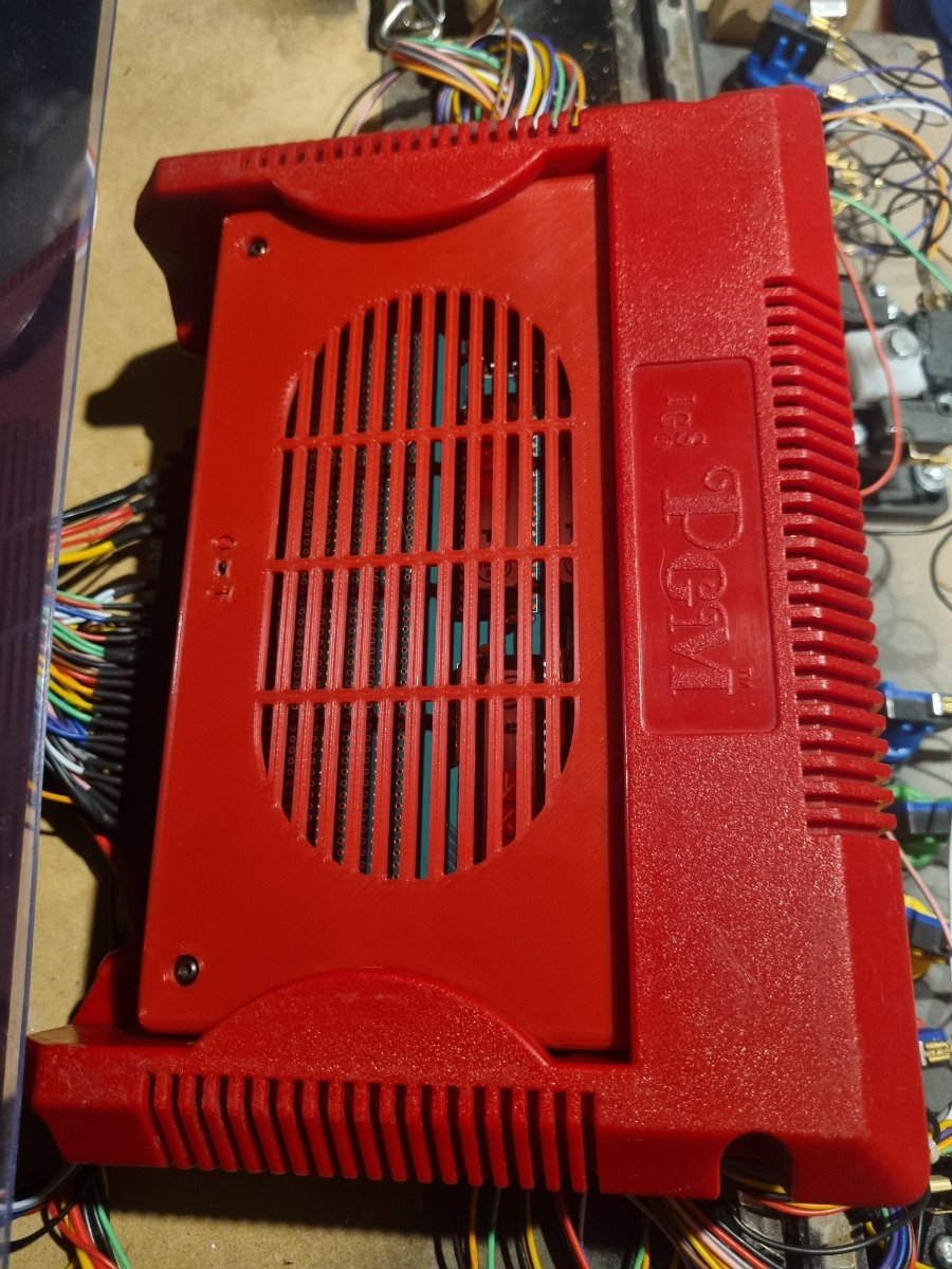

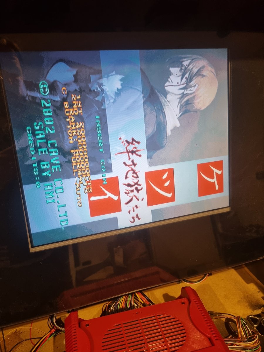

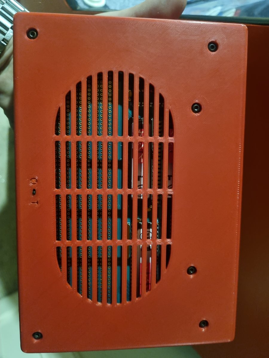

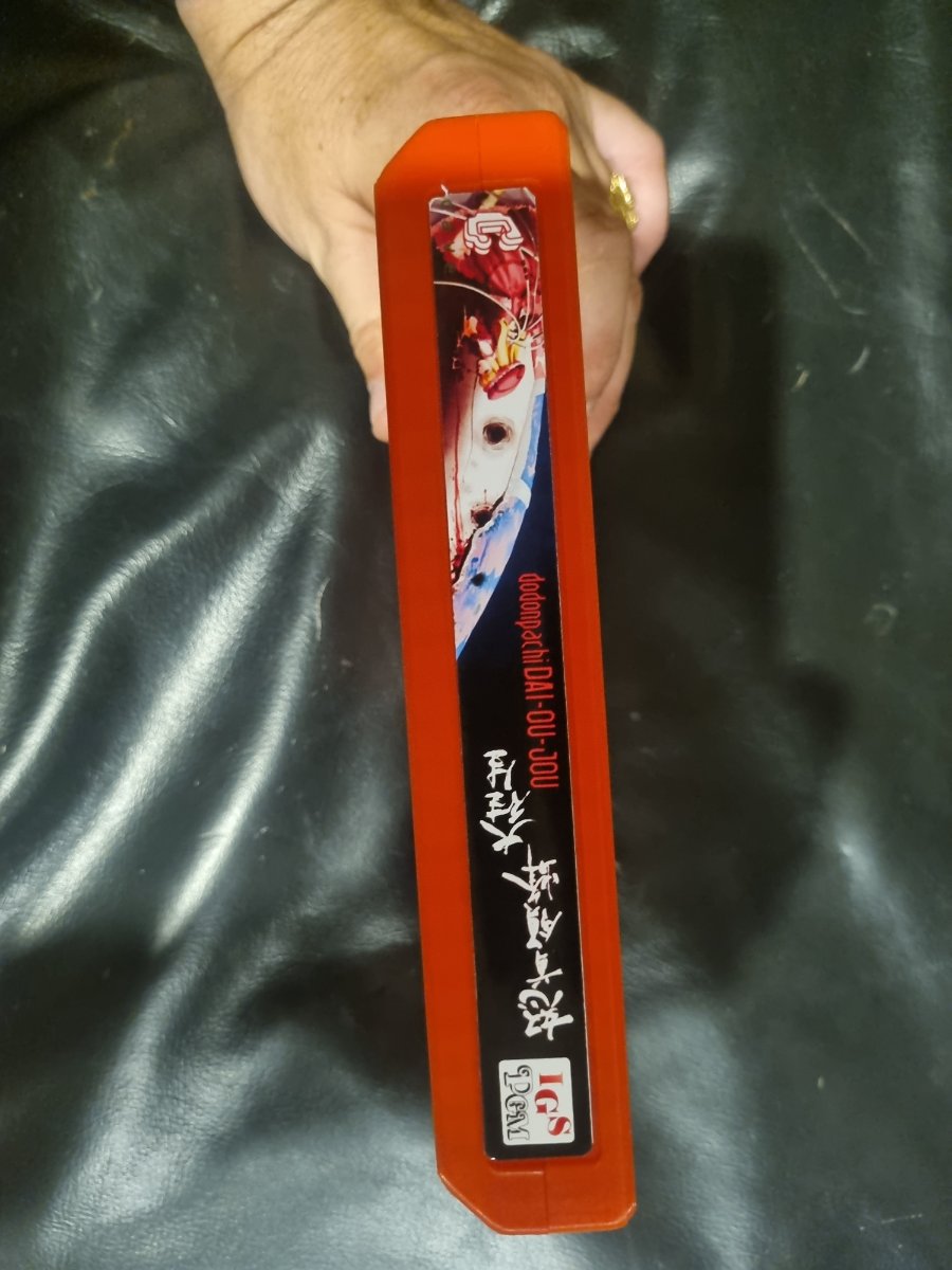

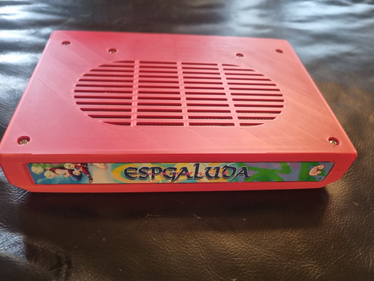

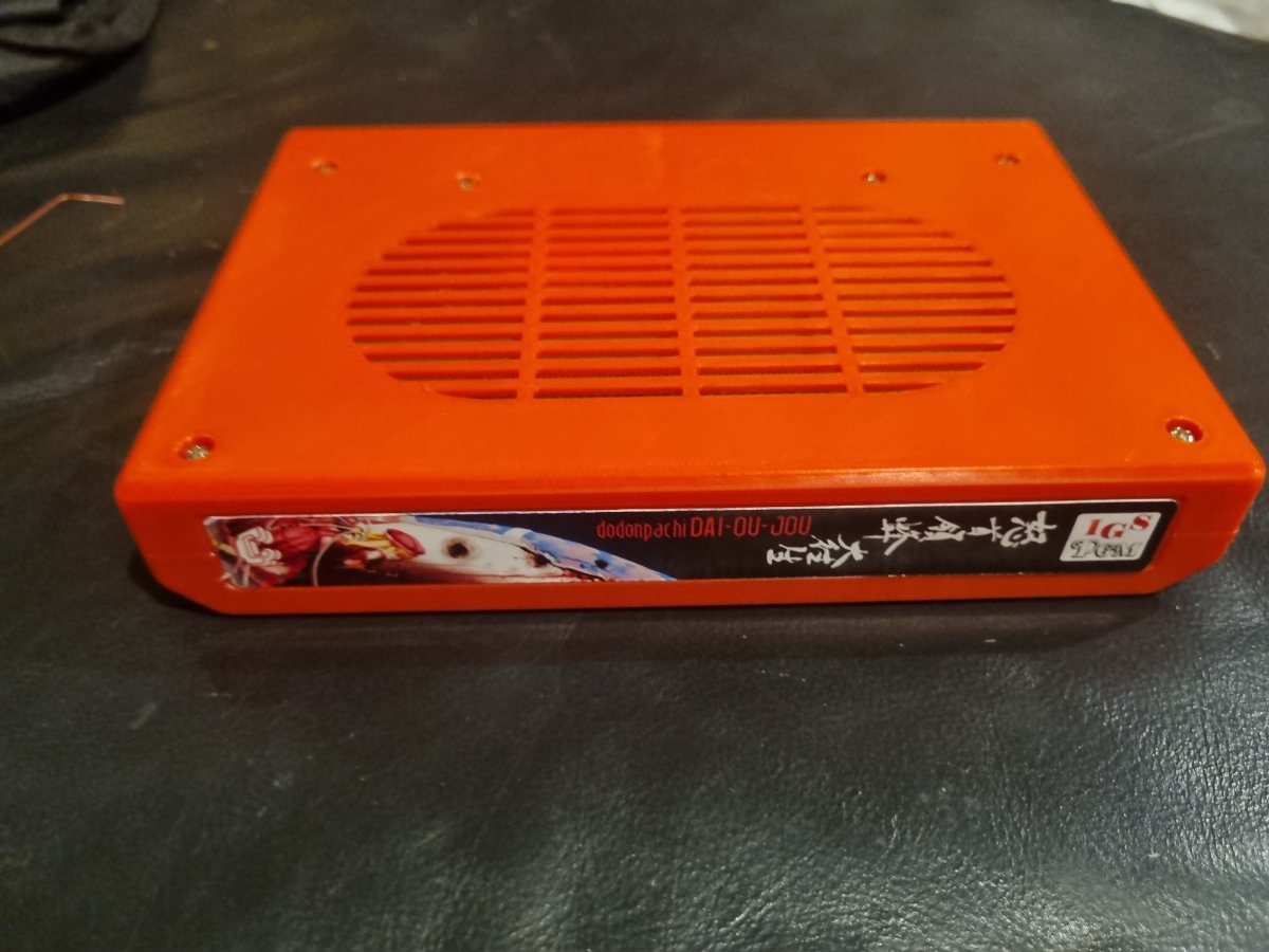

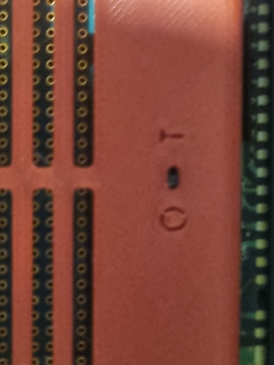

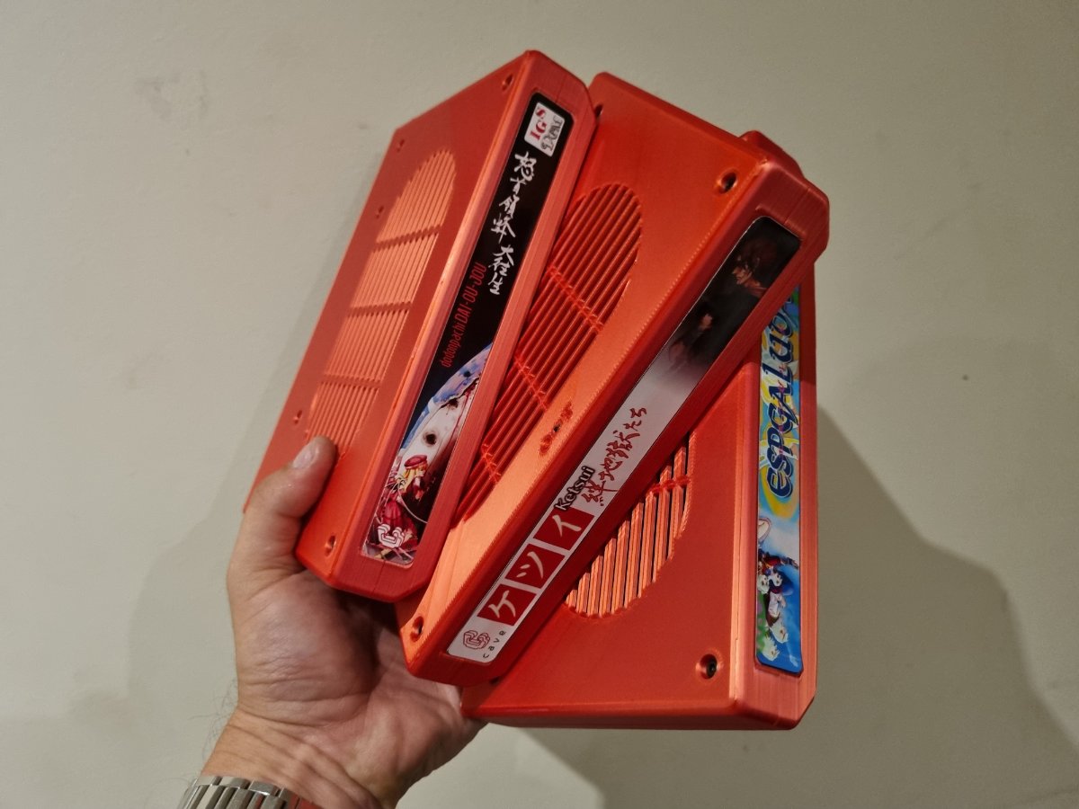

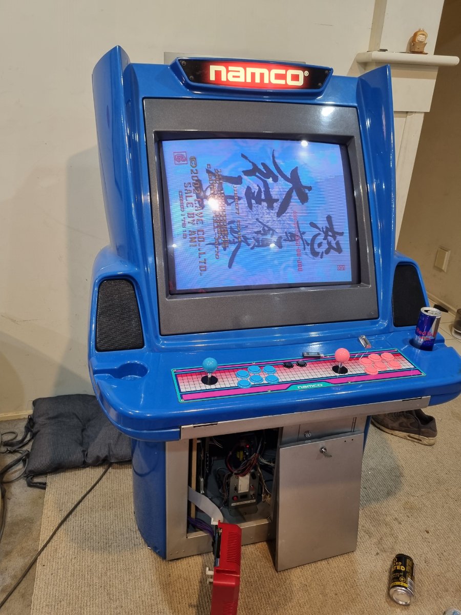

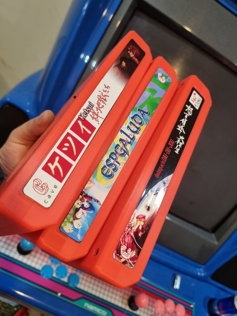

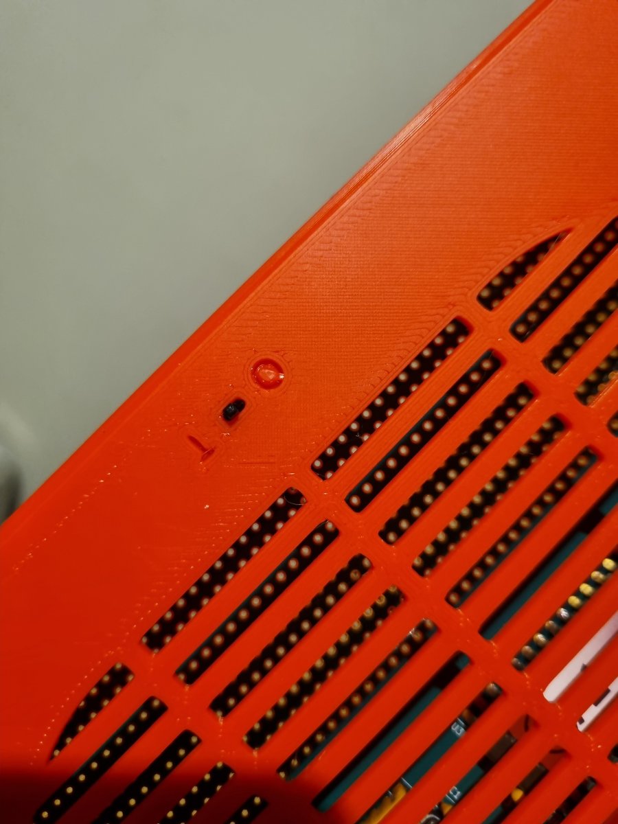

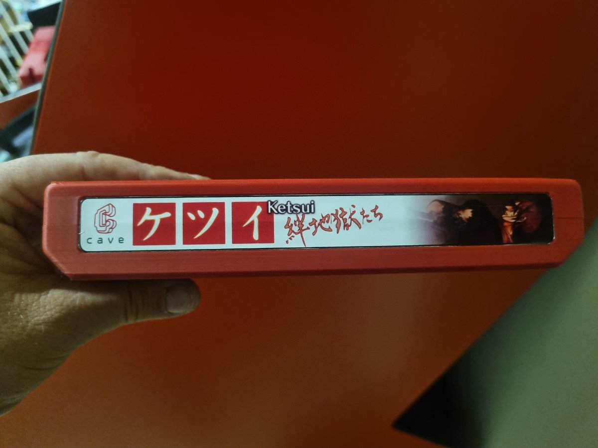

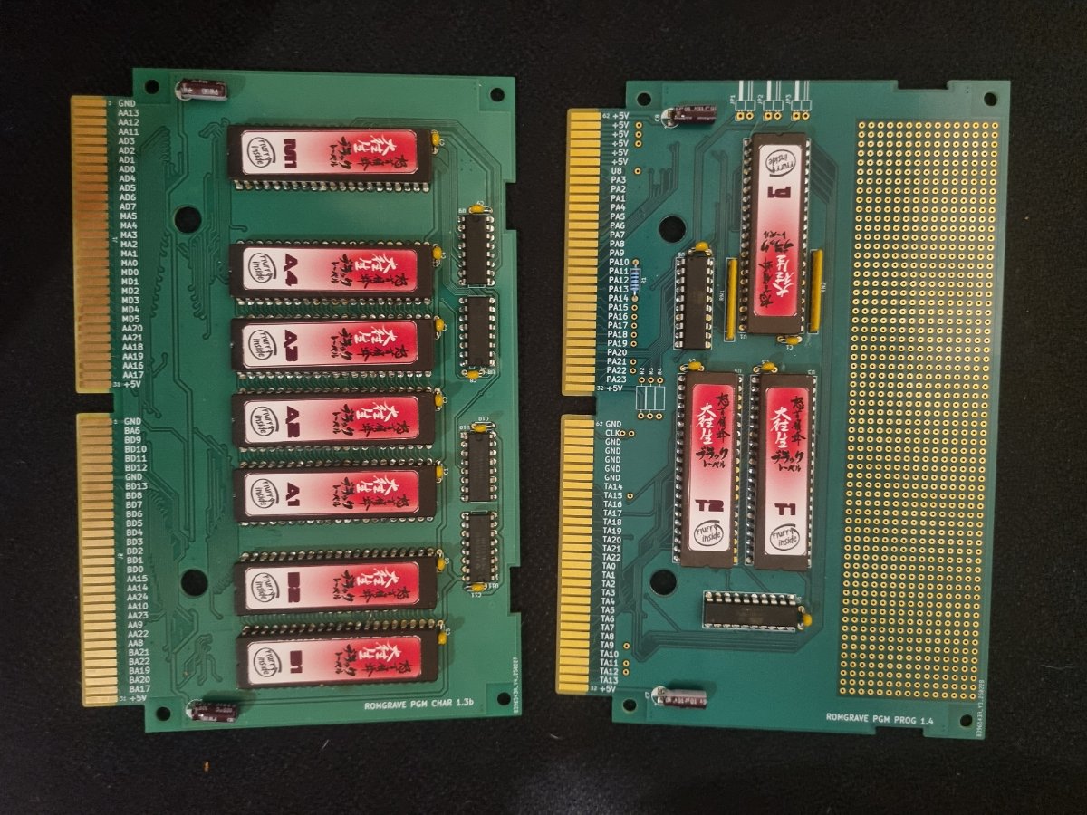

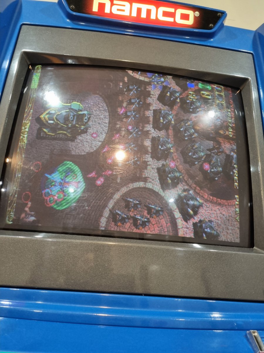

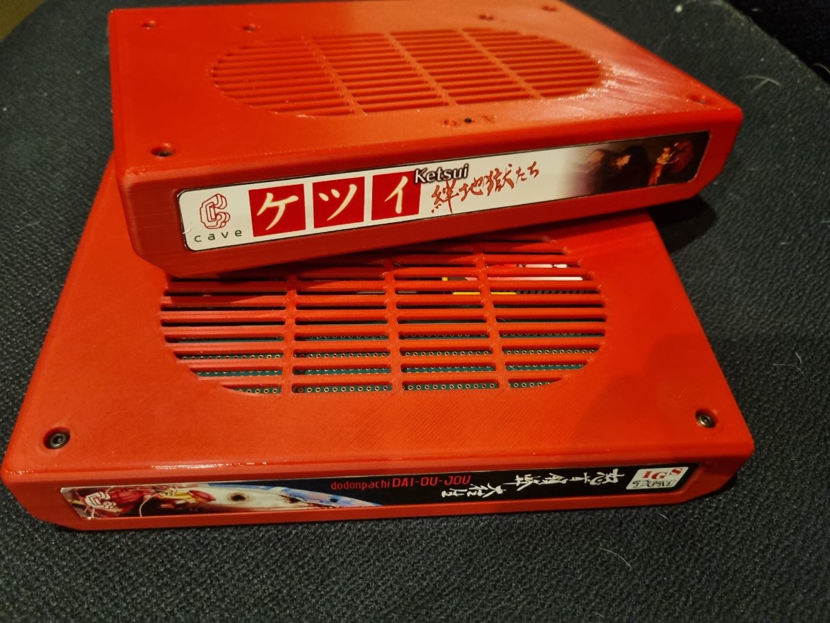

First Ketsui cart for PinBill over at KLOV.

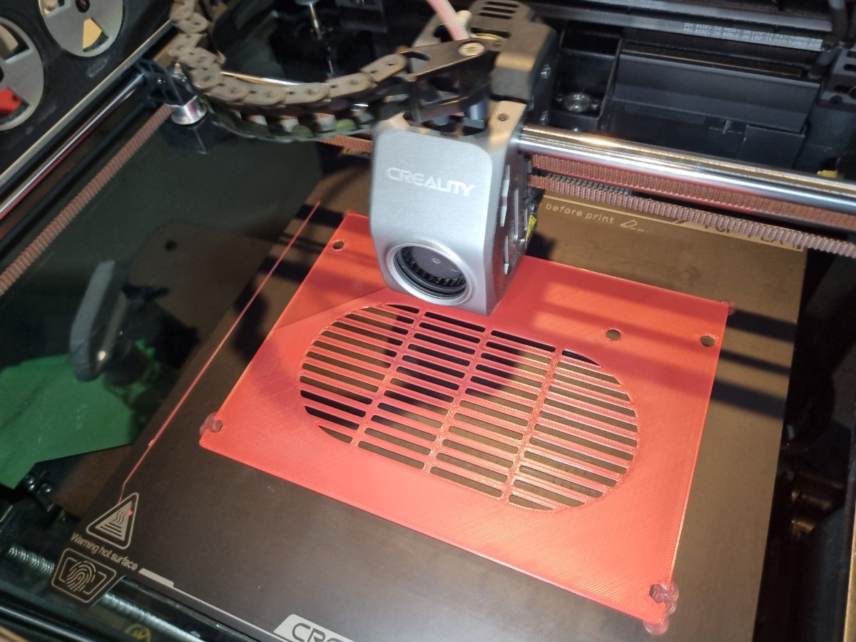

Note the switch solution, it's not my design but shared by another forum member. Also the x3d dark red makes an almost perfect match for PGM red buy it's a prickle to print with. If you are having problems raise the z offset a little (0.02) and increase the temp (+5-10)

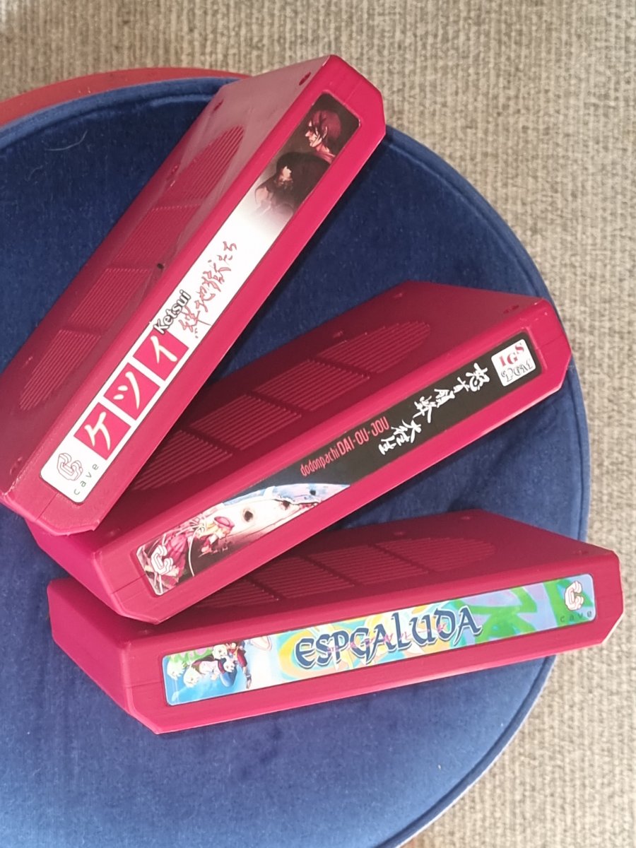

Here a few I made up in slik red cases for another private sale.

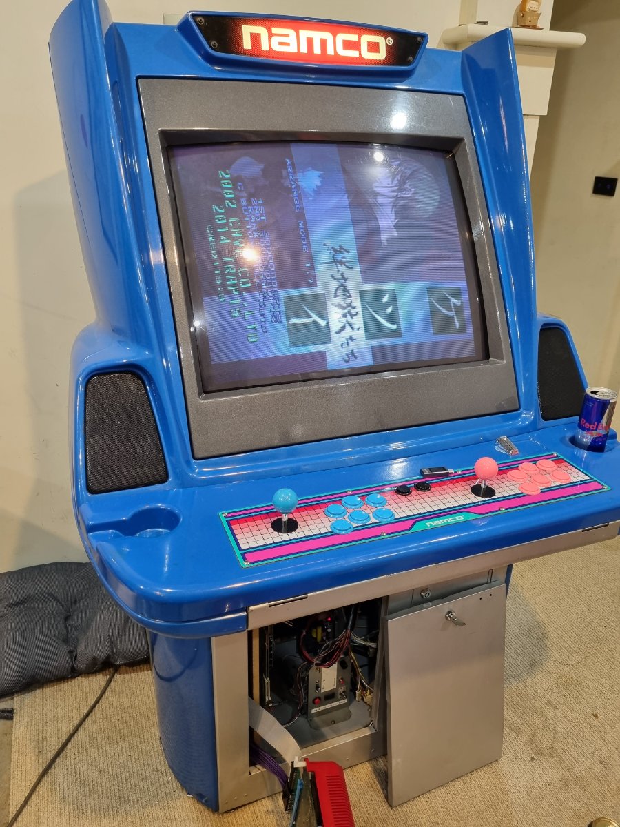

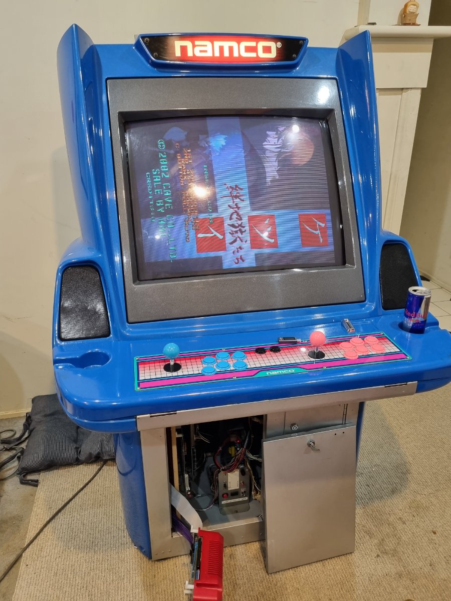

Set of carts for @Jangofatt.

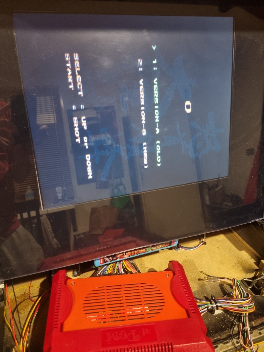

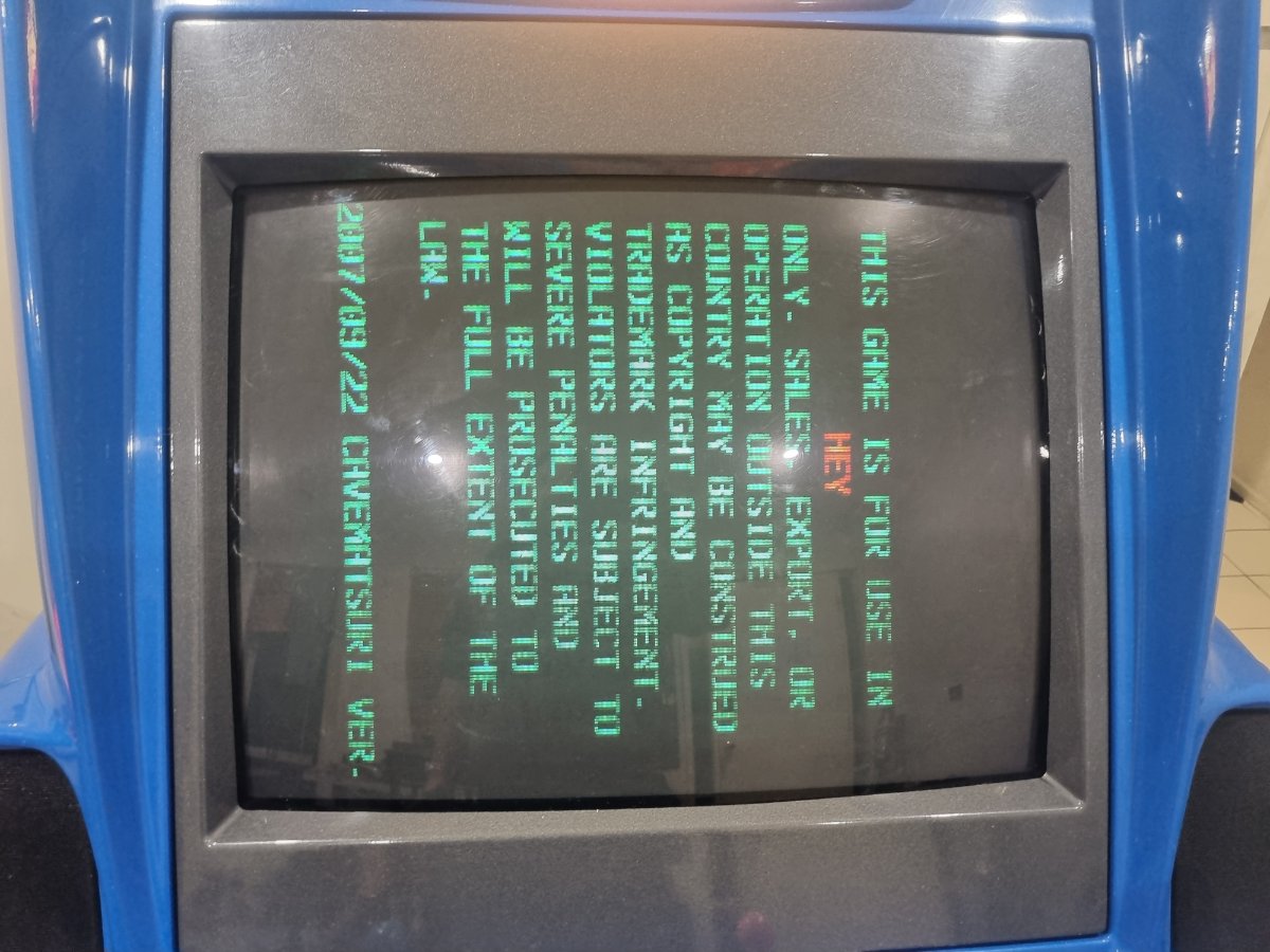

This Ketsui has OG Ketsui and the new Matsuri release. Unlike the Trap arrangement, which changes the credit screen green, Matsuri keeps it red, so the only way to know which game you are in is via the copyright screen (OG says Japan in red on the second line, while Matsuri says Hey) or by the differences in game play.
Matsuri is a really nice addition so thanks again for the effort getting this out.
