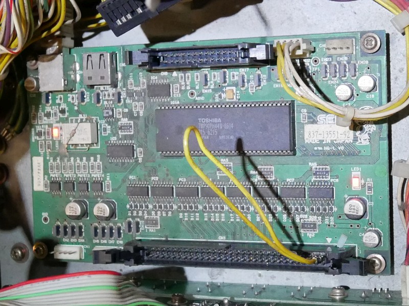

My GFI I/O is fried, so I'm replacing it with a Sega V3 i/o, but I suspect that some of the pins are slightly different - at the moment my Naomi recognizes the Sega i/o and starts up, and loads into Guilty Gear, but despite looping pin 1 and 3 on the Sega v3, I can't seem to get any inputs going. First problem is I can't coin up, by service button or coin chute. I know I also need to "fool" the card that there are coin meters present, but the thing is that there IS a coin meter on the G-Balance. It seems to attach to pin 49, which is just as it should be. My problem is that since the test button won't work either, I can't figure out what any of my inputs are doing... so I don't know if the card pin layout is completely different, or my soldering is bad (it is, but I mean non-working bad).

2nd, I'm at a complete loss now. Just to see if I could get any input, I looped pin 1 and 3 straight in the socket, and connected both coin meters (pin 49 and 50) to 5v pins (5 and 6) using a breadboard with 100 ohm resistors so I can't blame my wiring. But even if I run a cable straight from a button to the I/O, I get no input (I've obviously tried several different ones from the harness as well)! Am I missing something blindingly obvious in my ignorance?
It should be mentioned that in the test menu, the Naomi correctly identifies the sega I/O, and all the values are 0:ed out (the coin values change to from 0000 to 8000 if I remove the coin meter-cables) EXCEPT for the Analogue values, which are jumping like crazy - they stabilize if I remove the USB cable from the Naomi. My only hypothesis is that I've been sold a duff Sega I/O, and that the analogue values are somehow overriding the digital inputs.

With a JVS Type 1:
+5V to CN7 / CN8
JVS cable connected
Jumper between pin 1 and pin 3 on the 60-pin connector
If I touch GND and an input together I get a reading on screen. At no point are the analog values jumping like crazy.
You might have just gotten a duff unit.
Yeah, definitely a broken unit then :(
Thank you so much for confirming it for me though, I could've spent hours and days tinkering, convinced I was going wrong somewhere.
