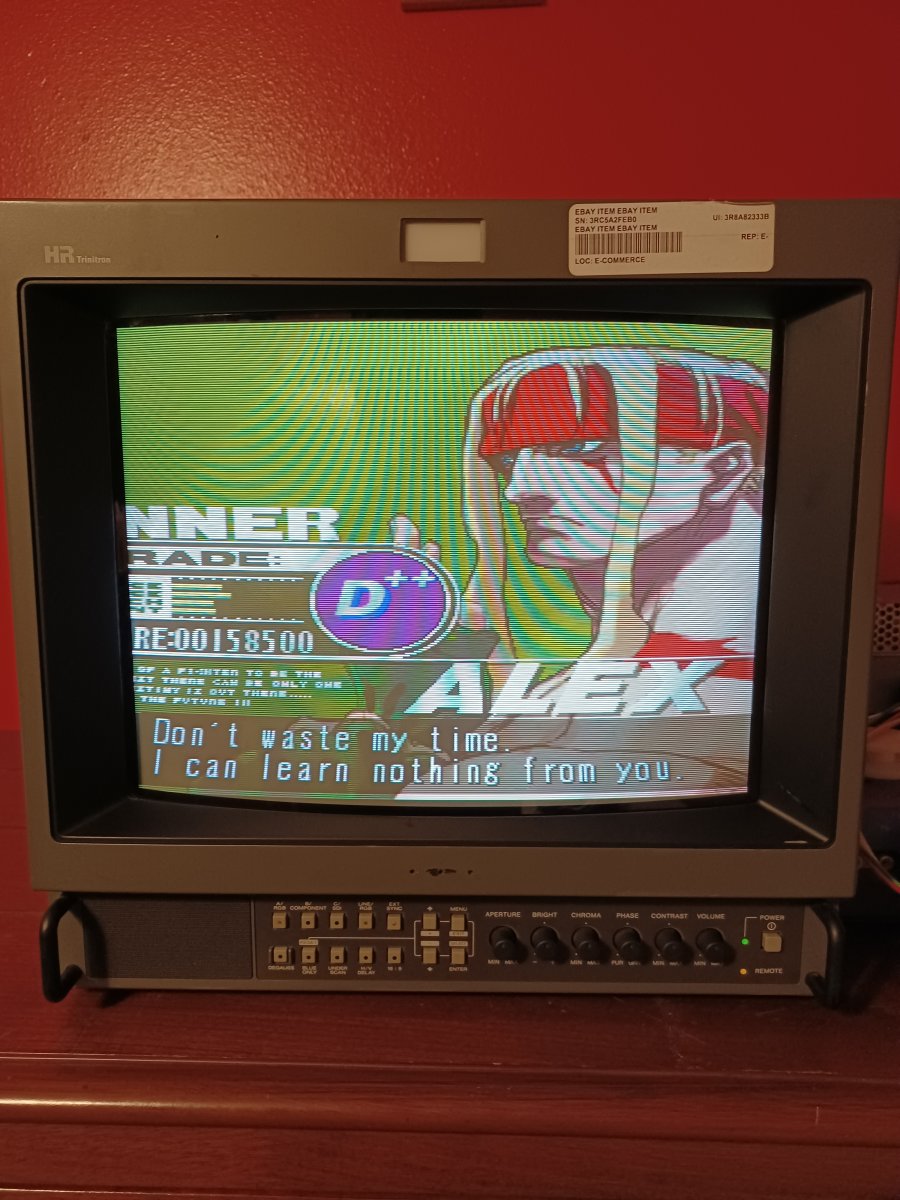

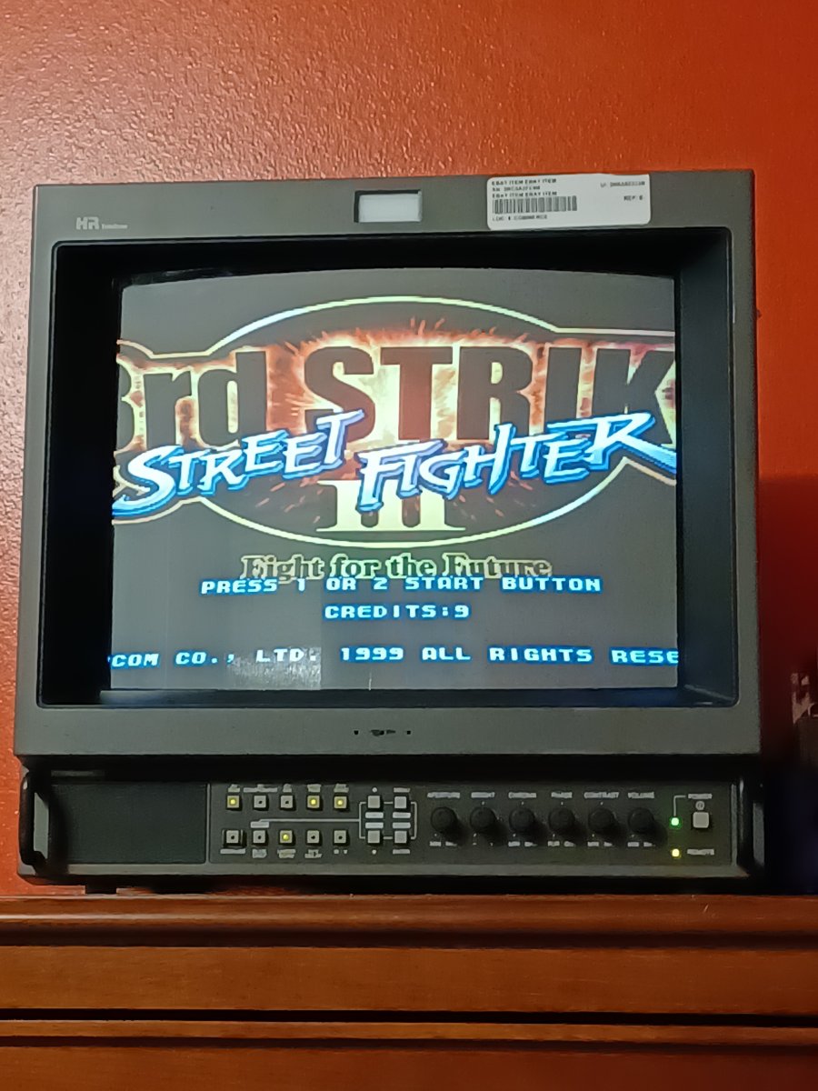

I recently came into possession of a PVM-20M4A which had a blown HOT and blown ICs on the PSU. This monitor had previously been worked on by someone, who really did not do a very good job, including ripped pads, terrible soldering and wrong parts installed. Anyway, I decided to recap the crucial caps in the deflection area while I was in there, most of which are on the sheet above from
@hatmoose .

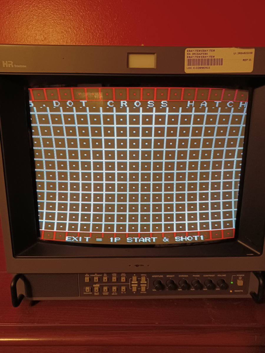

Once I got everything powered up, it produced the exact same deflection issue as above, where the raster was stretched horizontally, and most east-west pincushion adjustments would not make any difference. After spending much time learning how to read electrical diagrams and hours staring at the A board, I managed to fix my issue.

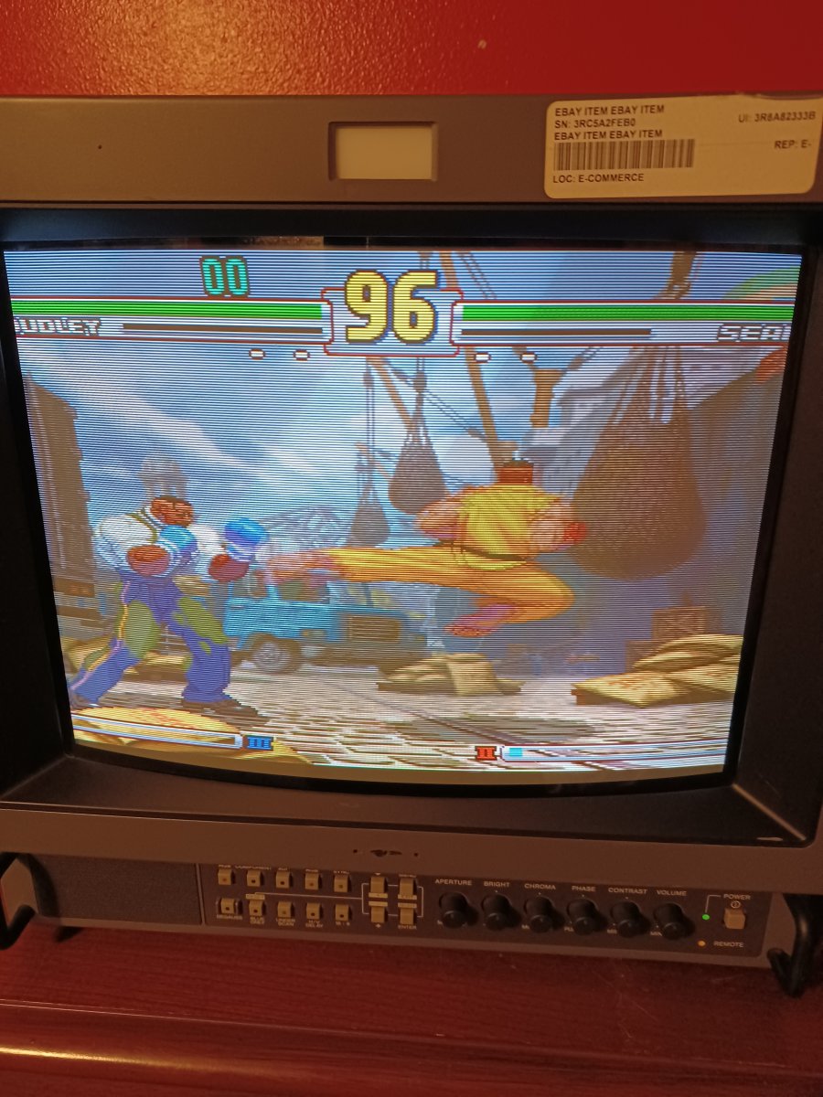

I checked for continuity between the positive leg of C579 and pin 8 of the IC (very difficult as this was underneath the capacitor, used a jumper wire attached to my probes) and confirmed no continuity. So I wrapped a resistor leg around the joint and added a bit more solder to make a good joint, confirmed continuity and when I fired it up, it was fixed!

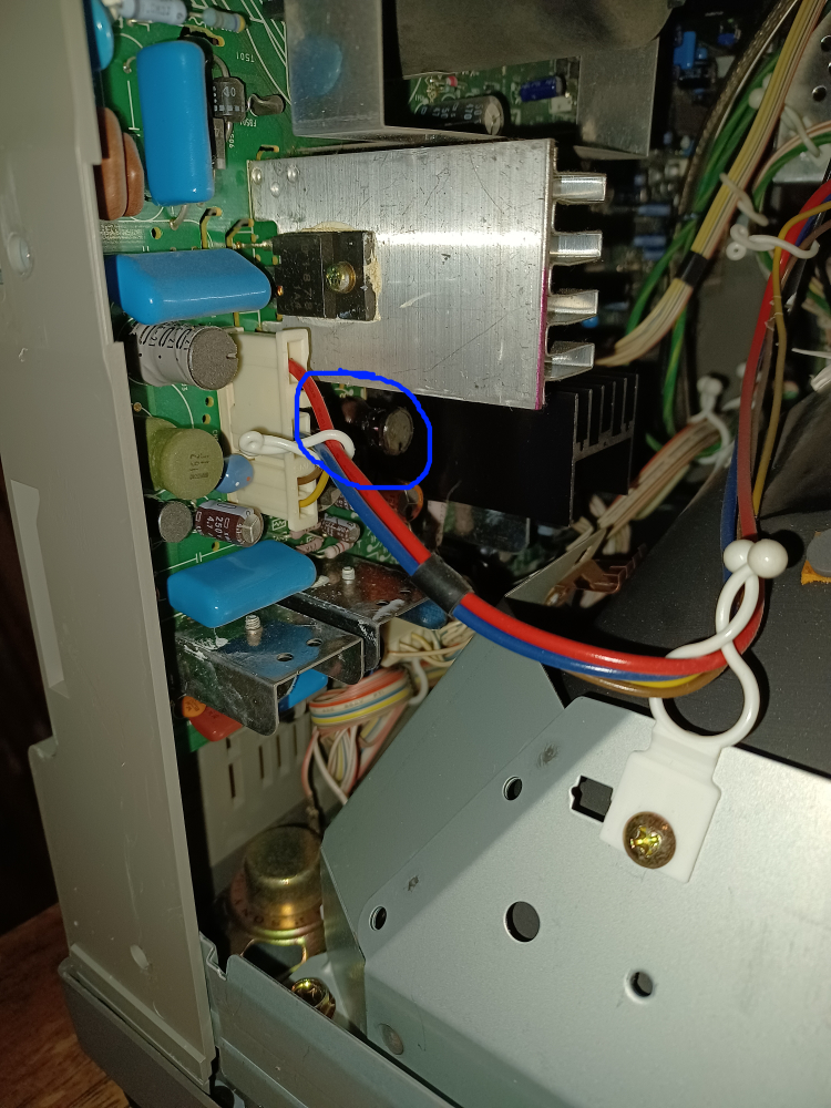

Now from my understanding, this circuit can fail at a few different points, this just happened to be where mine failed. Its best to start at the diodes and work your way from there. I'd start by looking for any short paths to ground across D506, D502, D512 and C525, as well as C514 and C2510. You can do this by checking the resistance across the components using the heatsink of Q501 like this:
from the red circle to the four yellow circles, as well as across A and B. You can also do this across the legs of C514 and C2510, resistance should be in the kiloohms or higher (mine was about 53kohms). Also thank you to MKL over at the Shmups forum!
Q503 can also be tested with a multimeter in diode mode once removed from the board. With the red probe on the left leg and the black probe on the middle and then the right leg. You should notice around 0.5-0.7v, with the latter combination being slightly higher. All other combinations should show O/L.
