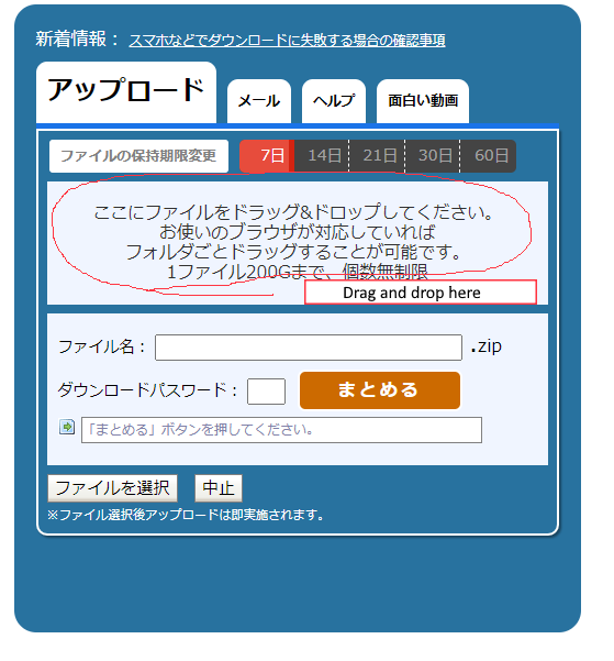

In Japan, "Giga file bin" is able to upload 200gb.
https://gigafile.nu/
But I do not know the speed of upload from abroad.
