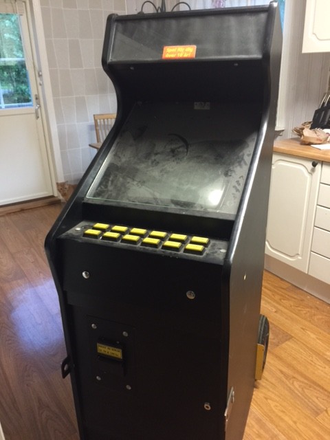

A friend of mine got some old poker cabinets cheap. So I grabbed one and got to work.

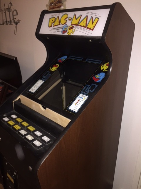

The old monitor hade severe burn in so it had to go. I used a 5:4 17" IPS (5ms). Picture is fantastic, it's just missing scanlines and a tinted plexi in front of it (to make it darker, it's on the lowest setting right now). All finish it this weekend for sure
For the moment I use a Raspberry Pi 2. It's configured so that player 1 start also function as button 1. This makes it possible to play games like Donkey Kong without any problems. I have about 30 games in the machine in total, less is more. It just didn't feel right to add more buttons to the control panel. The joystick and buttons are original leaf switches hooked to the Raspberry GPIO.
Insert coin is hooked up to the coin eject button on the left. The right coin eject is pause. There is a button not visible on the top that function as a "quit game" button.
All in all I'm happy with the result. As this is going to be a christmas present for my girlfriend that loves Pac-Man I think it will do the jobb just fine
