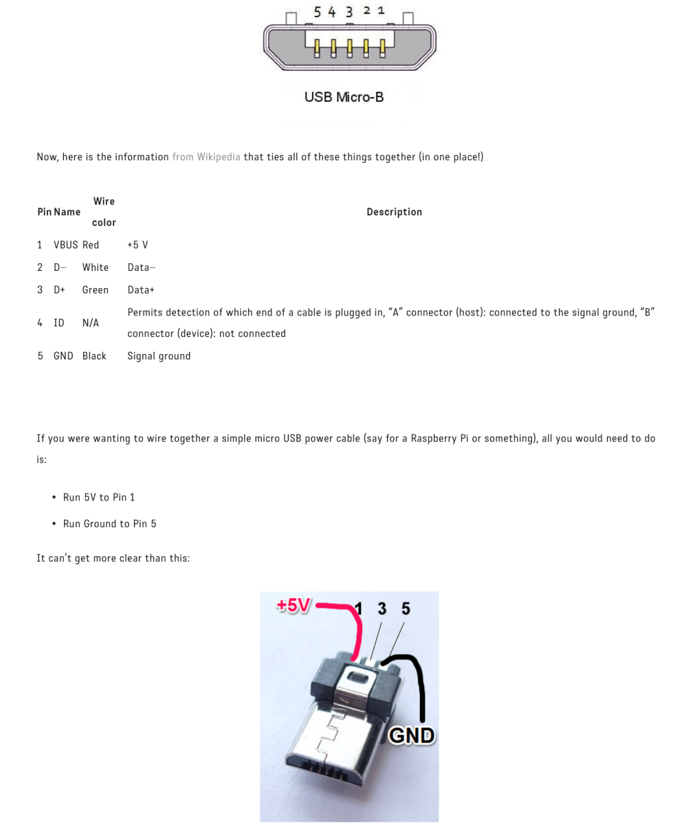

The scaler is normally powered by MicroUSB, so my assumption is that you could wire +5V to Pin 1 and GND to Pin 5 of a MicroUSB connector and be good to go.
Yup, should work fine. You can get male breakout boards for micro usb to make things easier.
