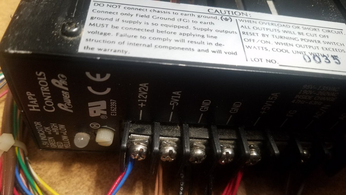

Naomi's need 3.3v going into it. I don't see a 3.3 terminal on that power supply. You'll need something like a Capcom IO that will supply the 3.3v needed. If you're trying to run a GD-rom as well (MVC2 is just a cart) I have no idea if the Capcom IO can handle that kind of load.
capcom io will do a cart fine. there's some mod I think to make it do a net dimm? I am sure it won't work with a gdrom. Sun PSU is the OEM solution. You can also use a PC power supply and mod the connectors.

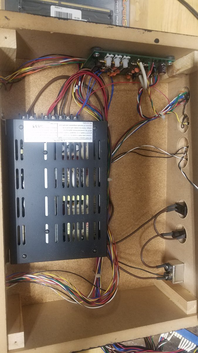

Thanks for the info. I do have the capcom I/O, I have it set up like this. My concern is they the power supply is rated for 110w or so.... running audio and video directly to the monitor

This is how I have it set up
