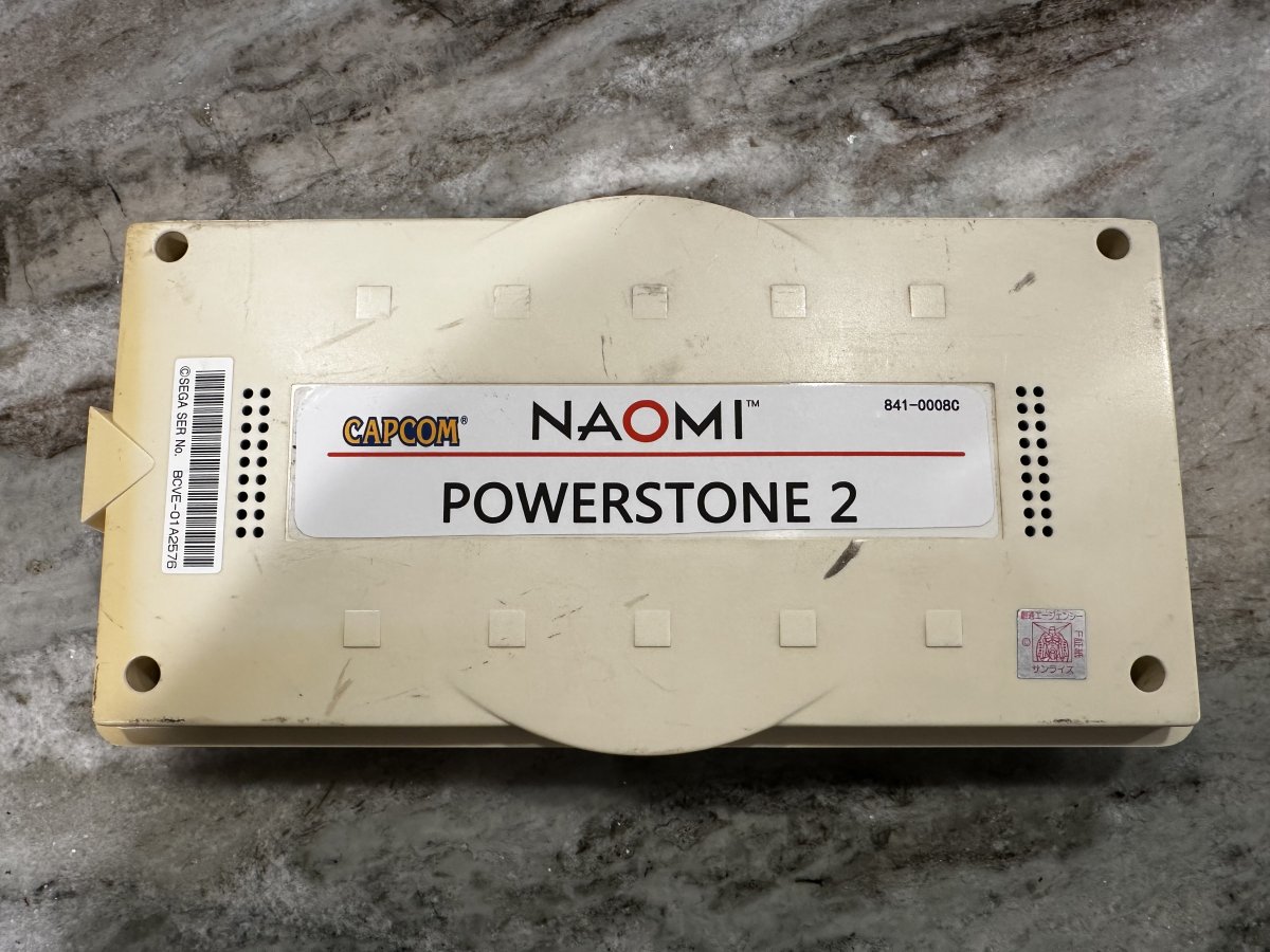

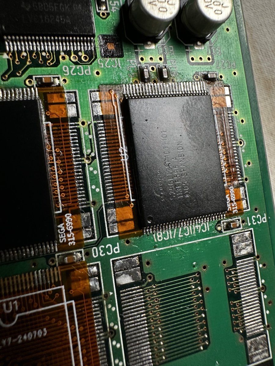

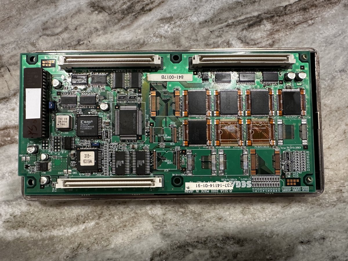

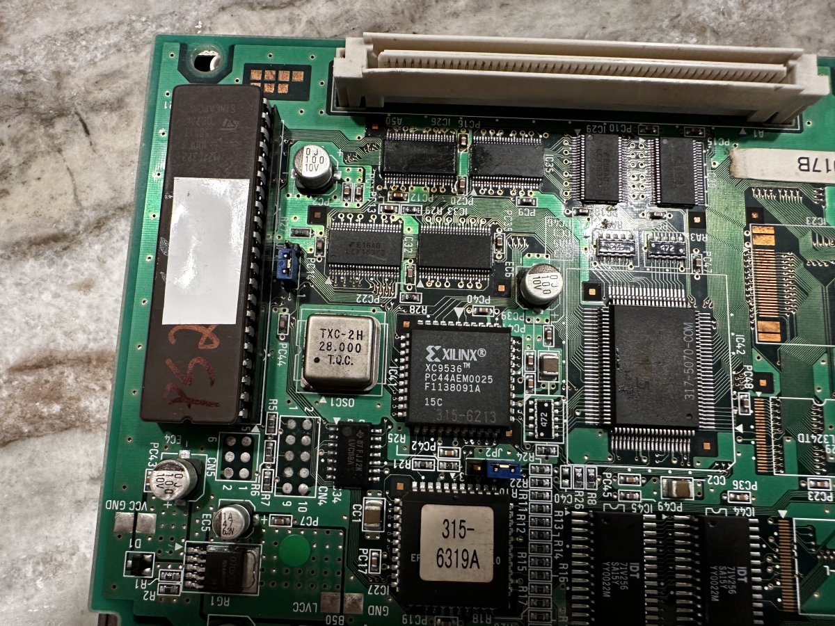

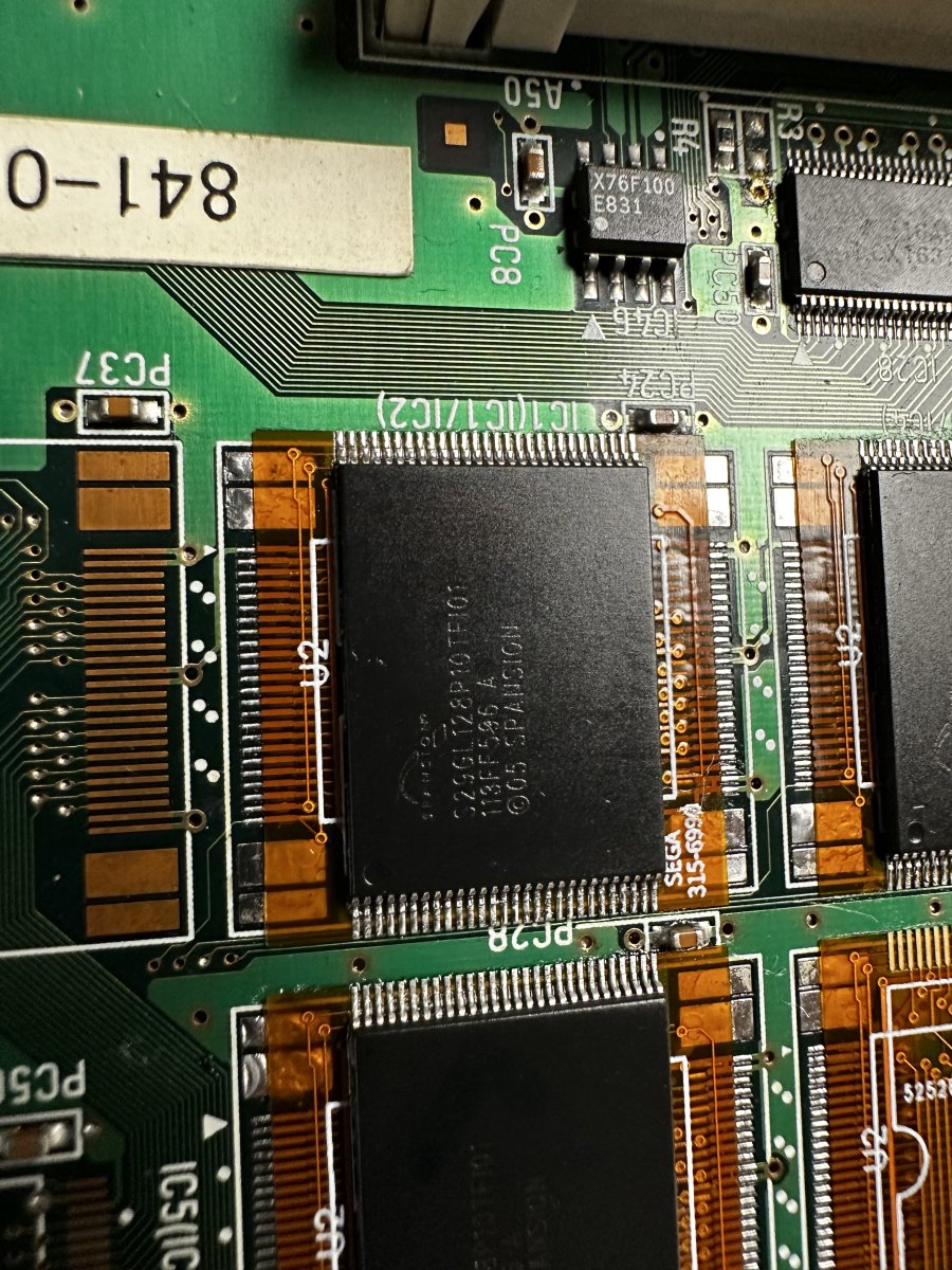

Hi everyone,
Looking for a little help here. I bought this Powerstone 2 Naomi cart, and I'm pretty sure that it was converted and not original, but I would like to be sure. I've been looking for pics of the PCB online for confirmation, but I'm not having much luck, so I figured I would ask here since there it would get a lot of eyes on it. Thank you in advance for the advice and help. I would rather have an original.

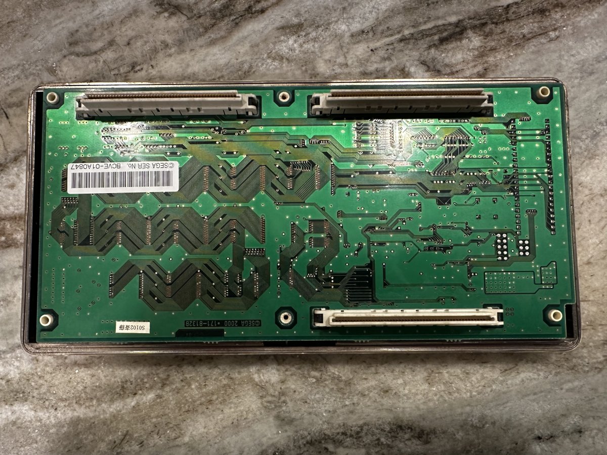

The original Powerstone 2 cartridge used the 171-7919A board, but the board in the photo is 171-8132B, so it is clearly a conversion.
For a long time, there was no flash memory compatible with 171-8132B, so I was wondering how to convert it, and thanks to your photo, I found out. thank you. Can you take a close up picture so I can see the number written on the film under the flash chip?

You can also verify the pcb sticker (841-0017B) with the part number for the game cart, in Mame's Naomi driver...
"Mobile Suit Gundam: Federation Vs. Zeon - 841-0017C"
"Power Stone 2 - 841-0008C"
(The letter that follows the part number)
A = for the Naomi mainboard
B = for the PCB
C = for the case of the PCB
D = for the case of mainboard
E = for communicationboard

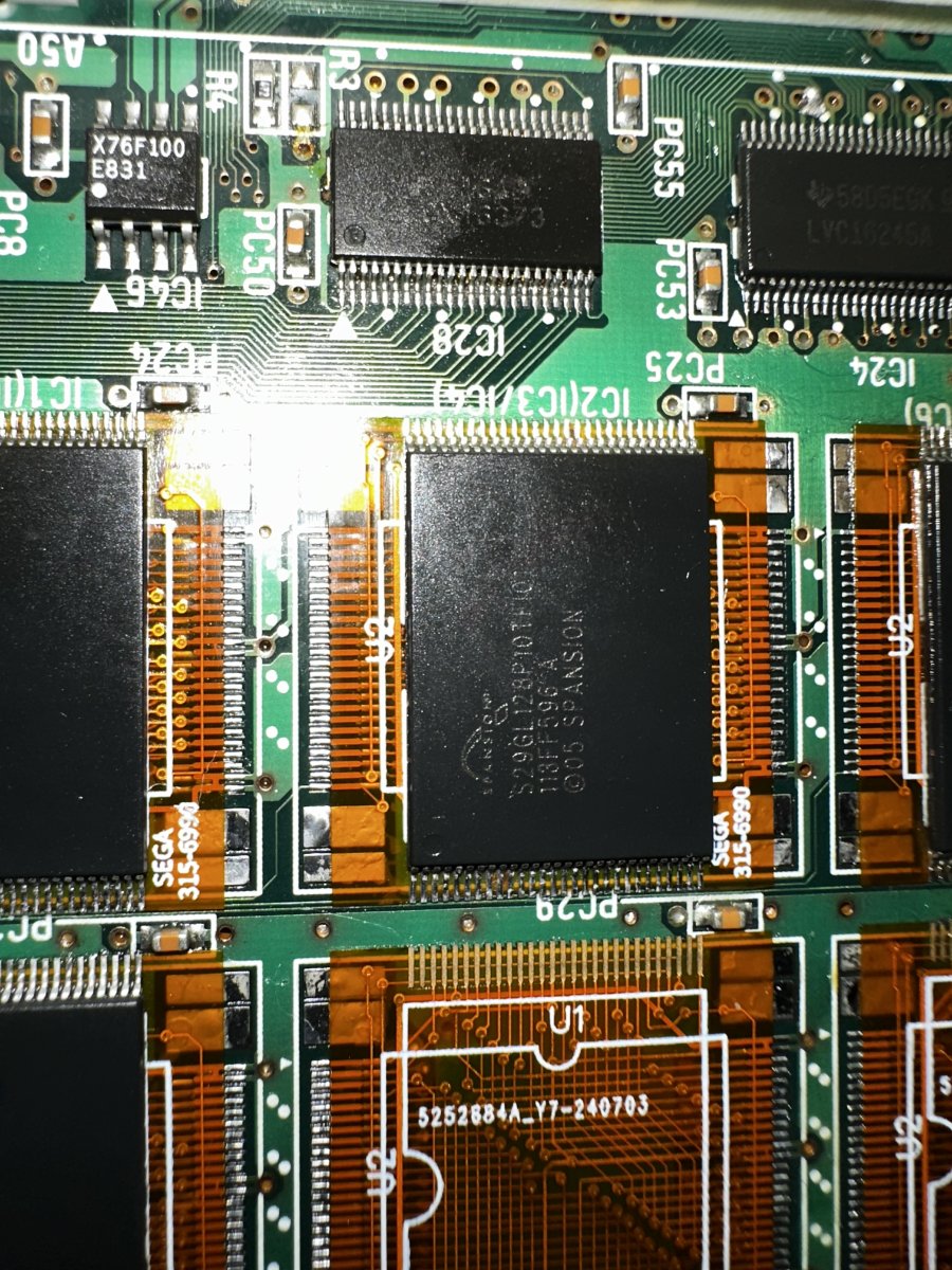

Yes, this is the card I modified. It uses the s29gl128 chip adapter, which is very difficult to solder.
If anyone doesn't understand anything, they can consult. You are also welcome to customize these cartridges directly from me.
I am only responsible for providing renovation services to the boss. I'm sorry that everyone bought something that didn't meet their expectations.
Does this help?
