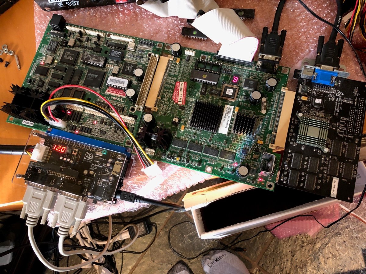

I purchased this board set as working a while back and unfortunately never got around to test it.
I find this weird that it was sold as working because when I got it the U27 bootrom was located in the expension slot above.
Anyhow I hooked everything together, I get an error code 8. After doing more research, this seems to relate to:
8. - Boot Rom Failure or pins not making contact at U27
So I pulled out the rom that was there, tried it in the proper U27 but no luck, I downloaded one from MAME and wrote a new 4001 rom. However the error still remains.
I tried all the other versions just in case it had to be version specific with the security chip but still no luck.
I then reflowed the U27 socket just to make sure its not due to a bad contact, but that didnt help either.

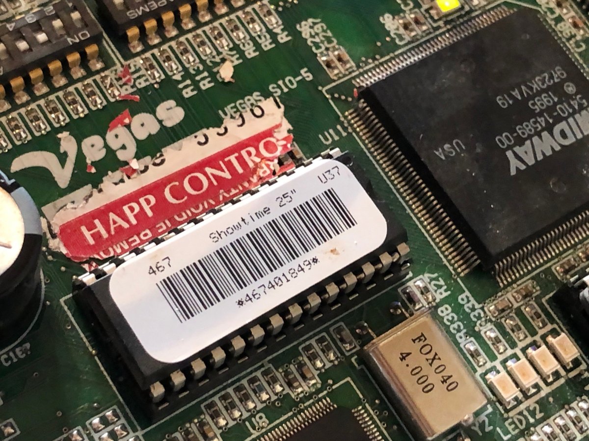

Looking at the security pic, it says: Showtime 25" 467401849
So I thought maybe the seller mixed it up and its just a regular NBA showtime board (security pic). I then downloaded the roms for the bootrom of nba showtime, tried that and still didnt help.
I was wondering if anyone has the Sportstation combo, whats written on the actual security chip?

I have a Gauntlet Dark legacy here and also a Gauntlet legends, I was able to swap the chips and make sure the sound board for my showtime was working ok. However the CPU boards and video cards are different so I have no other ways to test them.
I also saw a lot of mentions regarding voltage, I tried increasing it to 5.10V like suggested and 12.1V but that didnt help. I know the voltage is fine because my gauntlet boardsets are loading up and working fine. So I do not think its a power issue. Possibly more of a security chip / bootrom issue.
Im running out of ideas, any help would be appreciated.
