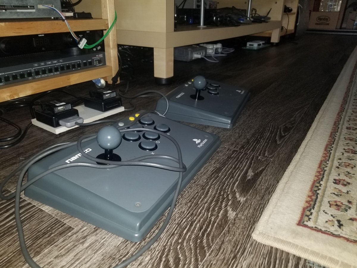

NPC-102 Namco Joystick 1996…2018 JLF Install.
I had to mod the stick a bit, starting by drilling the joystick base a bit where the bolts line up, I did it in order to use the base as is (keeping it stock) and be as close to the top as possible in order to keep the bottom from scraping at all.
I also did some snipping of the sides where the bolts can mount on certain applicatiopns, just so it could fit in the enclosure without hacking the case.
The tabs for the square gate needed to be a bit shorter and one of the leg clips that hold the gate also needed to be trimmed. Do not cut all the way as you will ruin the integrity of the stick BTW.
The shaft is Namco stock which fits nicely. The actuator needed to be cut and I used the Namco actuator for sizing. I could have used the Namco actuator which I tried and although it provides a shorter throw I’m honestly not too thrilled about the nylon material.
Finnally the spring, the Namco spring is too loose, it’s nice for some but too loosey goosey for me, the sanwa spring way to stiff in this case with the shorter shaft (at least for me), so I opted for a Tekken 5 spring, stiff like seimitsu but clean travel and contact like sanwa 'cause it’s all basically sanwa anyway.
The results are excellent, proper height, no different than stock height. Looks superb, no alteraions to the case which was my main concern and a bit stiffer than stock JLF, almost like a 1.5lb spring which I could have installed but I’m happy with how it came out.

I have been using a set of these for playing local sets with folks weekly for the last 5 years. Only in the last 2 years did I bother to replace the buttons (2nd gen Sanwa silent) and mess around with the stick.
Here is what I found:
1) Stock spring is a keeper. 1.5lb Paradise spring is too stiff and stock JLF is too loose. Stock Namco top Springer holder is the only one that works properly. A JLF one can be used if cut down to size.
2) Pivot from a JLF is exactly the same. Swap if worn. Grease goes here.
3) Silicone grease made a huge improvement over whatever old stuff was in there.
4) An oversized actuator can be used, you just have to hacksaw it down. Same deal with shaft covers. File sand after cutting a tiny bit less than needed. This is irrelevant for the most part after point 6.
5) Non-lever Omron switches seem to be the only ones that fit the housing. I used V-152-3A5 levered switches that I removed the lever from (drilled out rivets). Perfect tension.
6) Oddly, the biggest improvement in cutting out the dead zone was from adding the JLF washer that sits above the top spring holder. This alone is the best improvement you make to the stick. Dirt cheap and feels so much better in terms of stick return (dashing).
Everyone I play with now can use these sticks and don't have much of an issue. Was the not the case before. I love them personally and after the JLF washer addition, they are absolutely the best stick I have used.
I suggest not swapping the stick, but an LS-33 is the only one that will fit with minimal modification and keep the same overall feel. Time better spent on other shit IMO.
