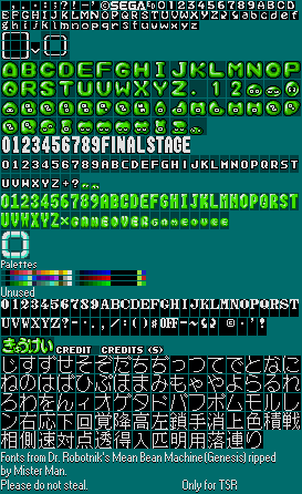

On the pre-battle enemy descriptions, I wonder if it's possible to take the English text sprites from Dr. Robotnik's Mean Bean Machine and put them into the game for that.
For example they would be the ones at the top of the sprite sheet.
Other instances of text may be more difficult and would have to be completely redrawn from what I've seen in other parts of the game.

It's not really going to be that simple. The majority of the JP text that would need to be translated is going to be made up of many tiles combined into one space to create one character. Whereas if you look at the sprite sheet you've found, for example, the "ones at the top" are much smaller- probably only taking up a single tile. The arcade version of Puyo 2 also already has an English table used for words like "ARLE" on the battle screen. You can view and search the rom files in a hex editor to confirm, but just from a quick peek, your generic single-tile table for these letters is going to look something like this:

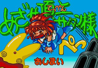

So from a conversation with a friend, the green text in the bad ending translates to "Aim for the top, Satan-Sama!" with the small orange text on it possibly being furigana since it reads "teppen" or "top". Then the yellow text under Arle is a spitting sound effect of "peeeh". The orange text at the bottom just means "The End".

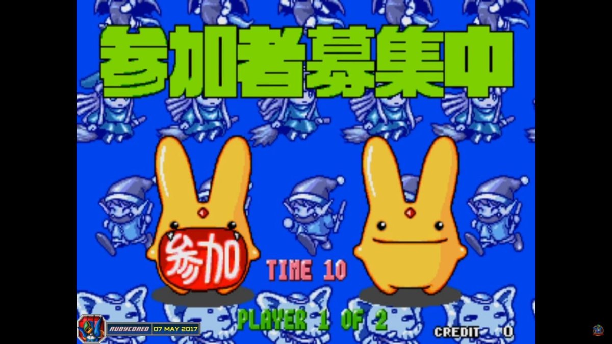

So from looking at the game, I realized that what's normally the option screen in the console versions is a "waiting for players" screen. The green text says "Searching for Participants" and the white text in Carbuncle's mouth basically says "To Join" and when there's enough credits there's text flashing over the one on the right that says "2P Press Start Button". Then the Carbuncle on the right displays the same text as the left one when player 2 is ready.
When the timer runs out and only player 1 is ready the green text changes to "Solo Puyo Puyo". If both players are ready it changes to "Double Puyo Puyo".
