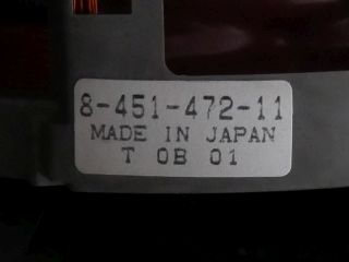

That would be awesome. Can you also take the ref of the yoke?
I looked at the 14M2 service manual and A and G boards are identical to the 1454QM I have so yoke values must be very close between the two.
Yoke ref:
Lh 1.27 mH
Lv 16.8 mH
Rh 2.1 ohm
Rv 17.1 ohm
