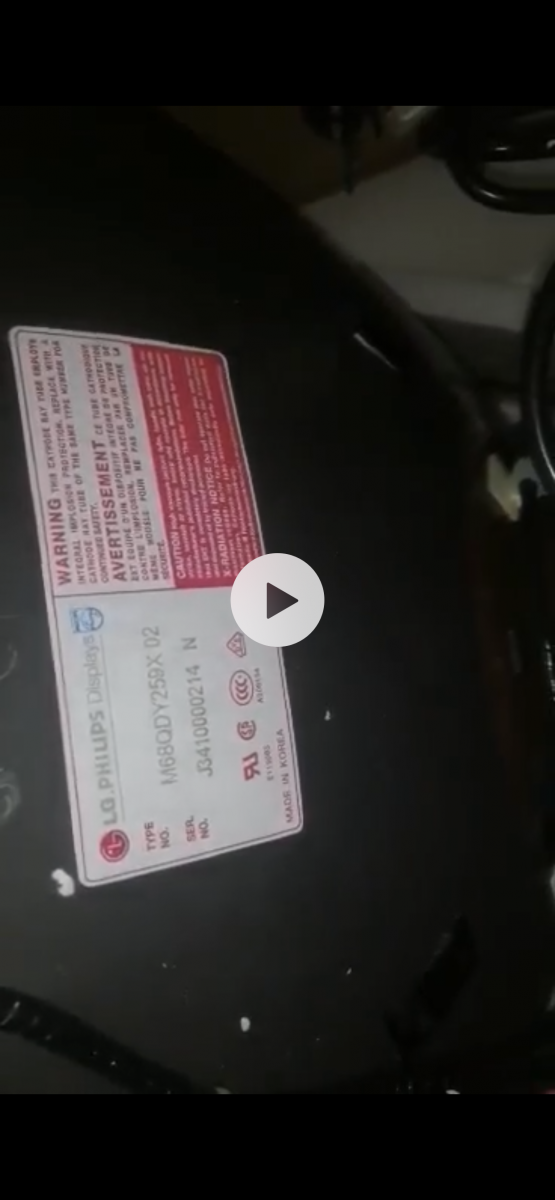

Anyone know if this tube would fit a blast correctly? LG tube with Wei Ya chassis. I’m told it’s meant for an egret 3 or atomiswave cab.
