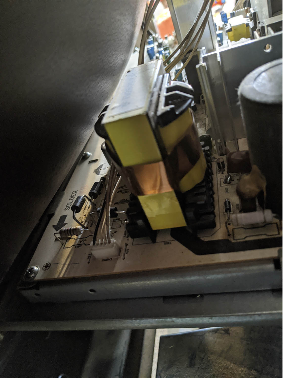

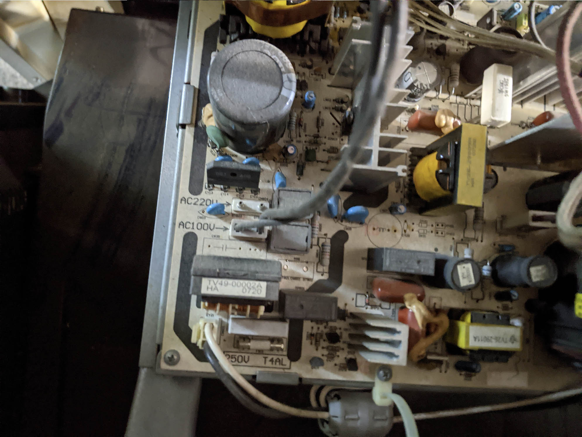

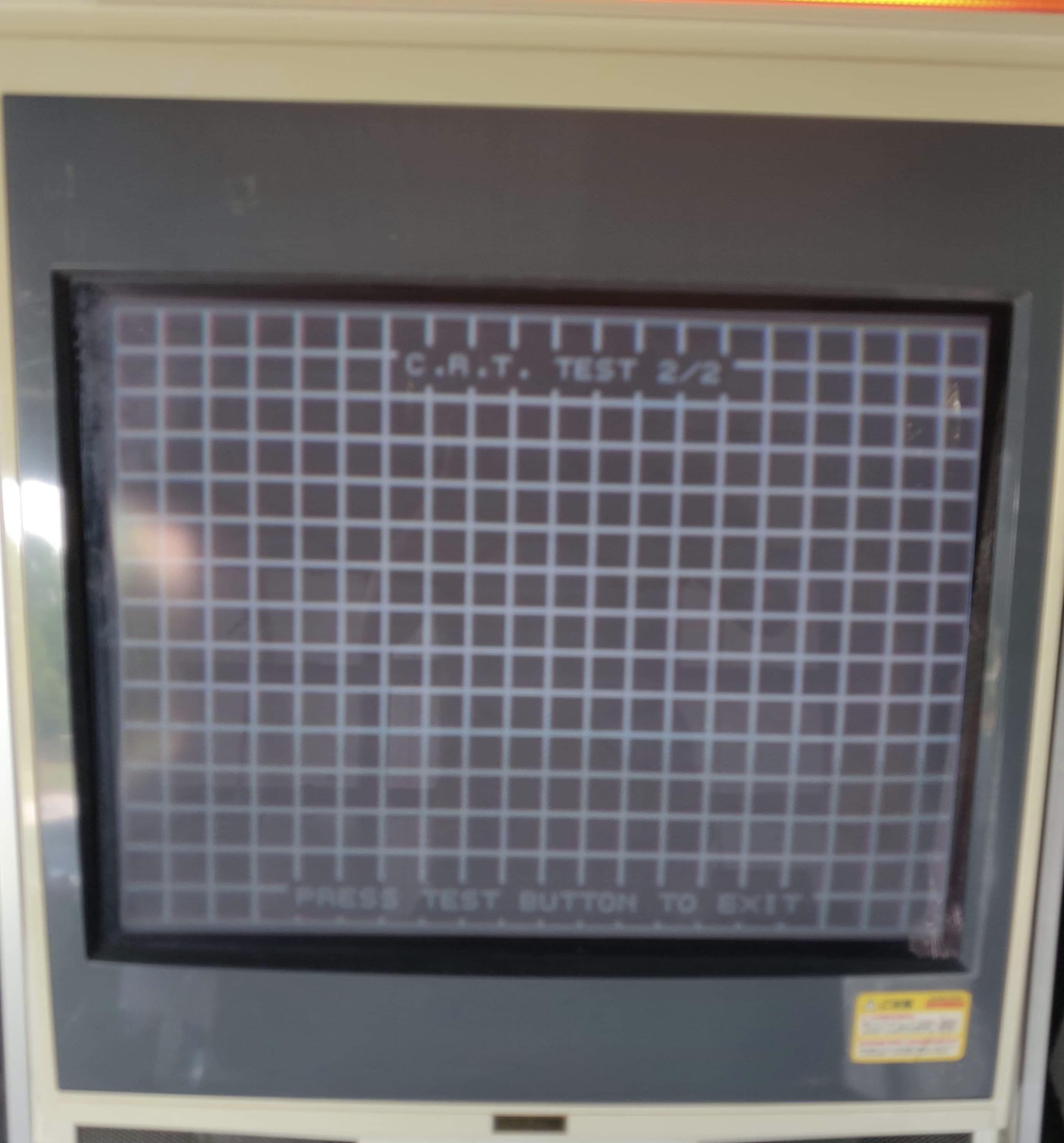

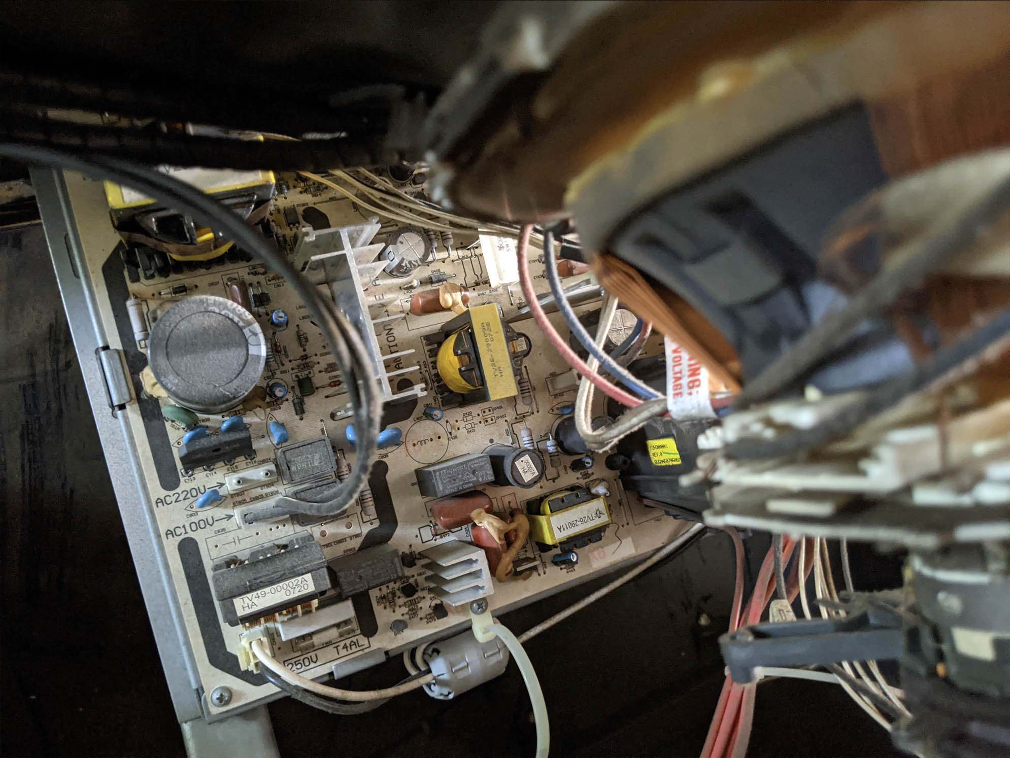

Hey guys,
So I have an opportunity to snatch up an otherwise clean New Net City; the only issues with it are associated with the monitor. It has a good amount of burn, and the seller says that the brightness is cranked up to near it's max on the chassis (Sanwa KW0606A) but the picture looks really dim. I'm wondering if this thing is worth picking up with the main feature of the NNC being it's display, and this ones being kinda suspect.
I have a few questions related to this in addition to getting your thoughts on what I've already mentioned:
  • Is the dimmness a tube/yoke issue?
  • If the tube/yoke are dead, how and where would I find a replacement?
  • How much should I expect to pay for a replacement A68LTF356X?
  • Could the dimmness be an IC issue or something other than a failing yoke? (Seller says they don't hear a buzzing flyback)
  • How much is the price of an NNC impacted by a bad monitor?
It should also be noted that I have a relatively low level of sophistication when it comes to arcade repair. I've done a couple cap kits, rewired so,e lights, swapped monitor transistors and ICs, buttons/controls, etc but nothing really "advanced". The geometry / color balance looks pretty good on this from what I can tell. It's the brightness and burn which I'm wrestling with and just don't know enough about.
I've attached some photos to help you guys see what I'm working with.

so geometry looks great so chassis matches yoke
i suspect the resistor on the heater line needs halving in value to give you good brightness etc
its also possible the tube is weak but i think i am correct about the resistor looking at the colour levels
How do I go about halving the resistor on the heater line? Pull the neck board and literally replace the resistor?
i think its on the video b+ line on the main chassis but i need to look at a chassis to check
@gunblade Do you know the resistance of the resistor I'm looking for? And is halving it literally replacing it with a resistor that is half the value of the existing resistor?

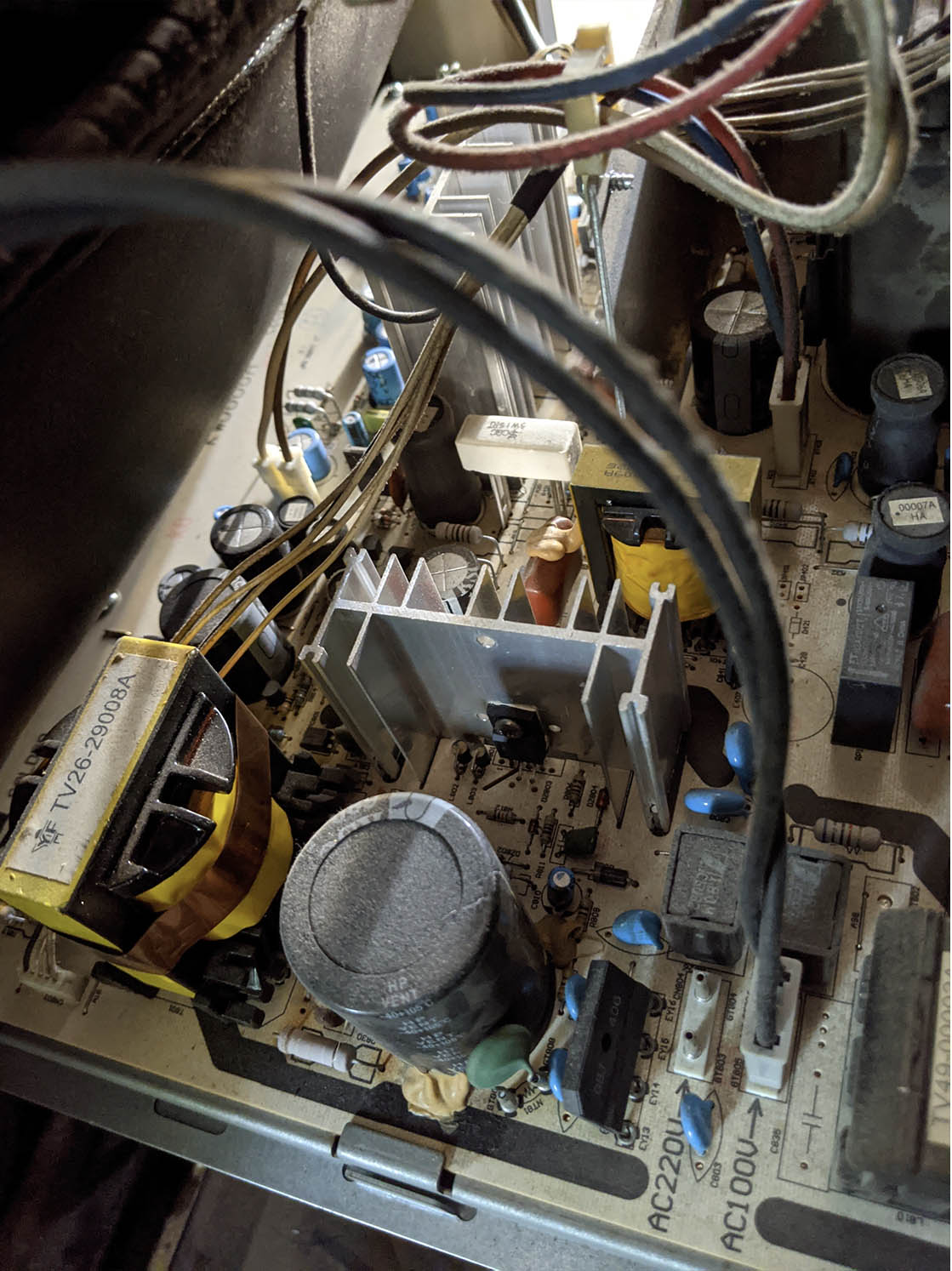

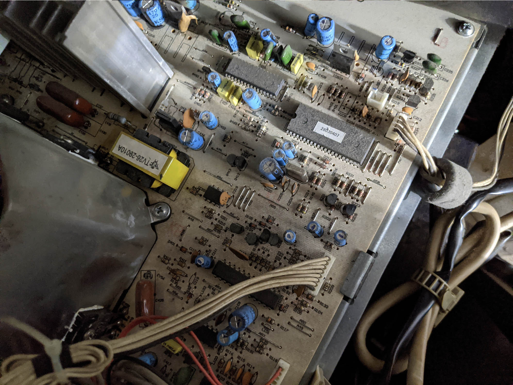

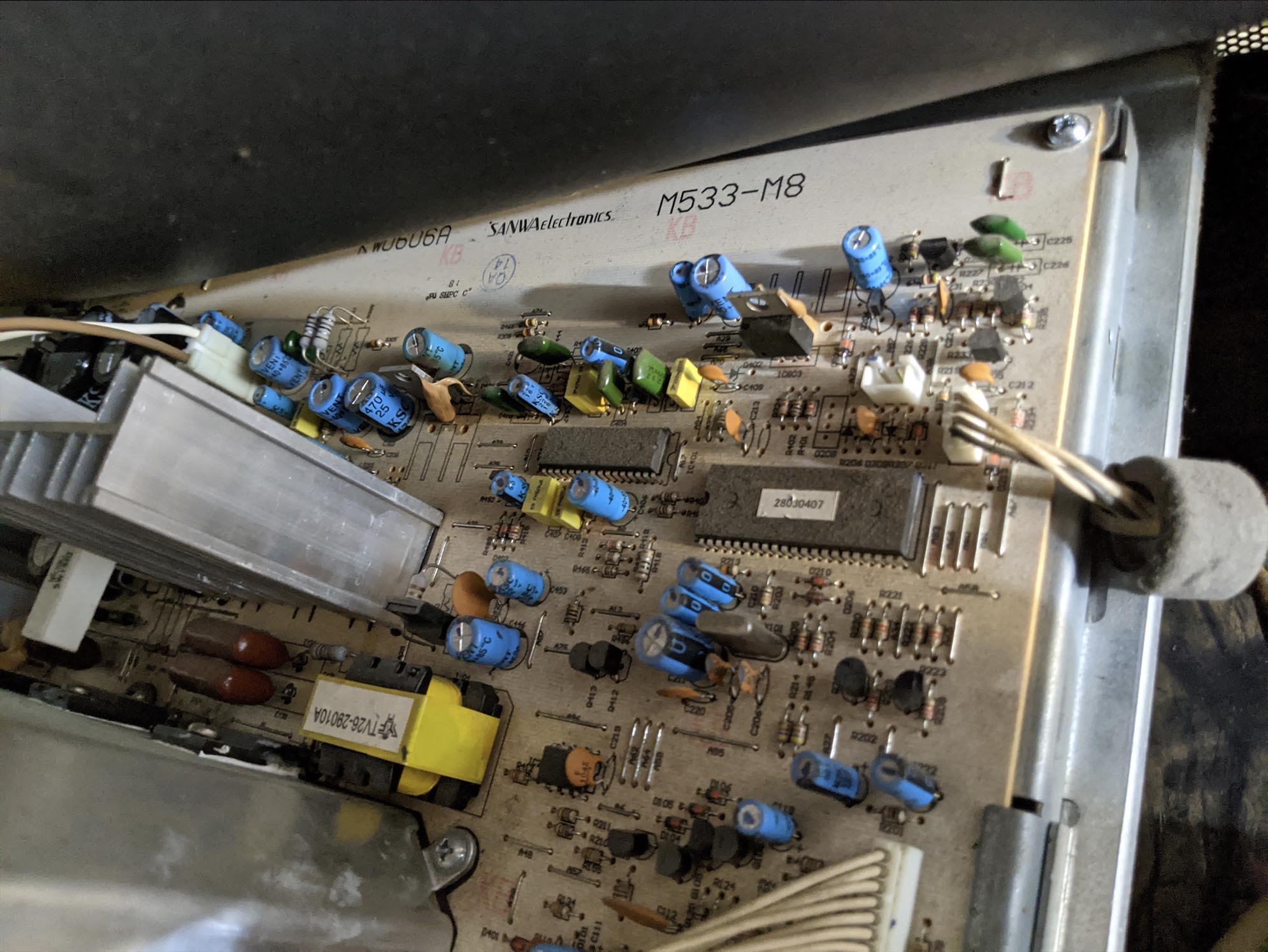

Also attaching photos of the board:
Apply Toshiba's trademark to water with your fingers, there may be shanghai novell YS
It’s impossible to look at the Toshiba logo at the top of the line as "ltf356x"
see your tube label a68ltf356x PICTURE
It says that on the label it's a Toshiba and it looks super legit I don't think it's a fake if that's what you're trying to say. Sorry language barrier I think is getting in the way of me understanding you. I'm trying to figure out where the heater resistor is and what resistance it is on the sanwa PFX chassis at this point.
