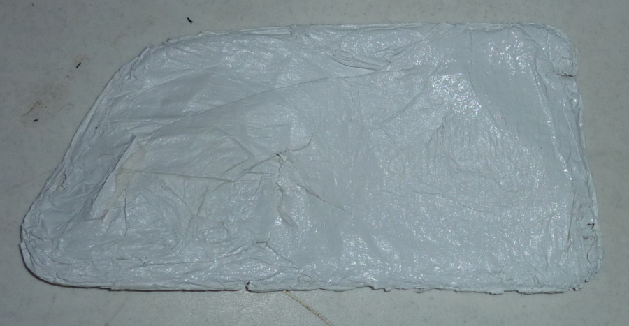

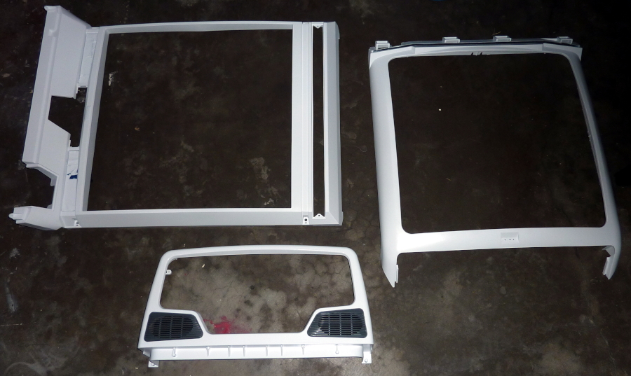

I didn't prime or even sand the Net City. I sanded the Super Neo 29 parts though. I used wet toilet paper and paper towels to jam into the edges of the top bezel for the Super Neo 29 speakers. I used the back of a razor blade to push the towels down on the sides, so it wouldn't bleed over the top. Image 2 shows the towels after the paint got on it. Using painters tape pulls off that old paint, so that's out. Worked good. I also used Goo Gone to remove where some paint got through onto the speakers. Sega Net City is nearing completion. Just a cap kit on the monitor at some point. Paint is Rust-O-Leum Appliance Epoxy.
