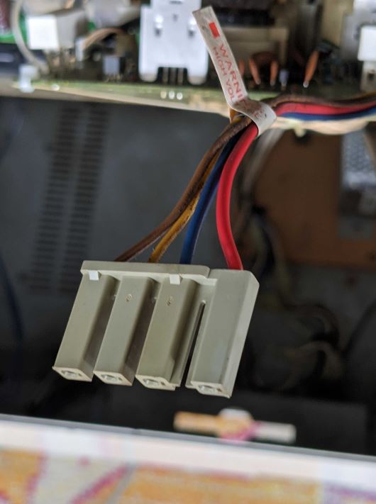

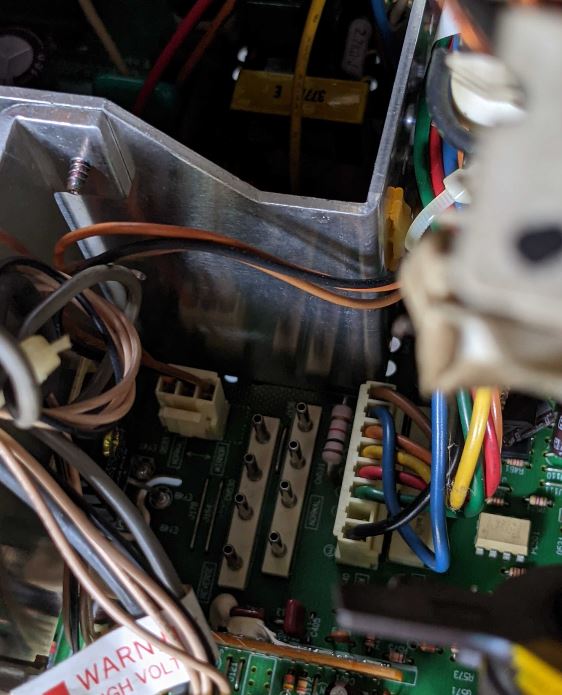

Hello, received a cabinet where the chassis wasn't screwed down and am putting things back together. Fortunately nothing appears to be broken but I'm left at this connection and am not sure which plug or orientation to use. Any help is appreciated, pictures attached.

That's for the yoke. There's two sets of connectors for it, one for normal picture orientation, the other for reverse (upside down and mirrored).
Plug it in to Normal (labeled on the PCB). The connector goes only in one way.
