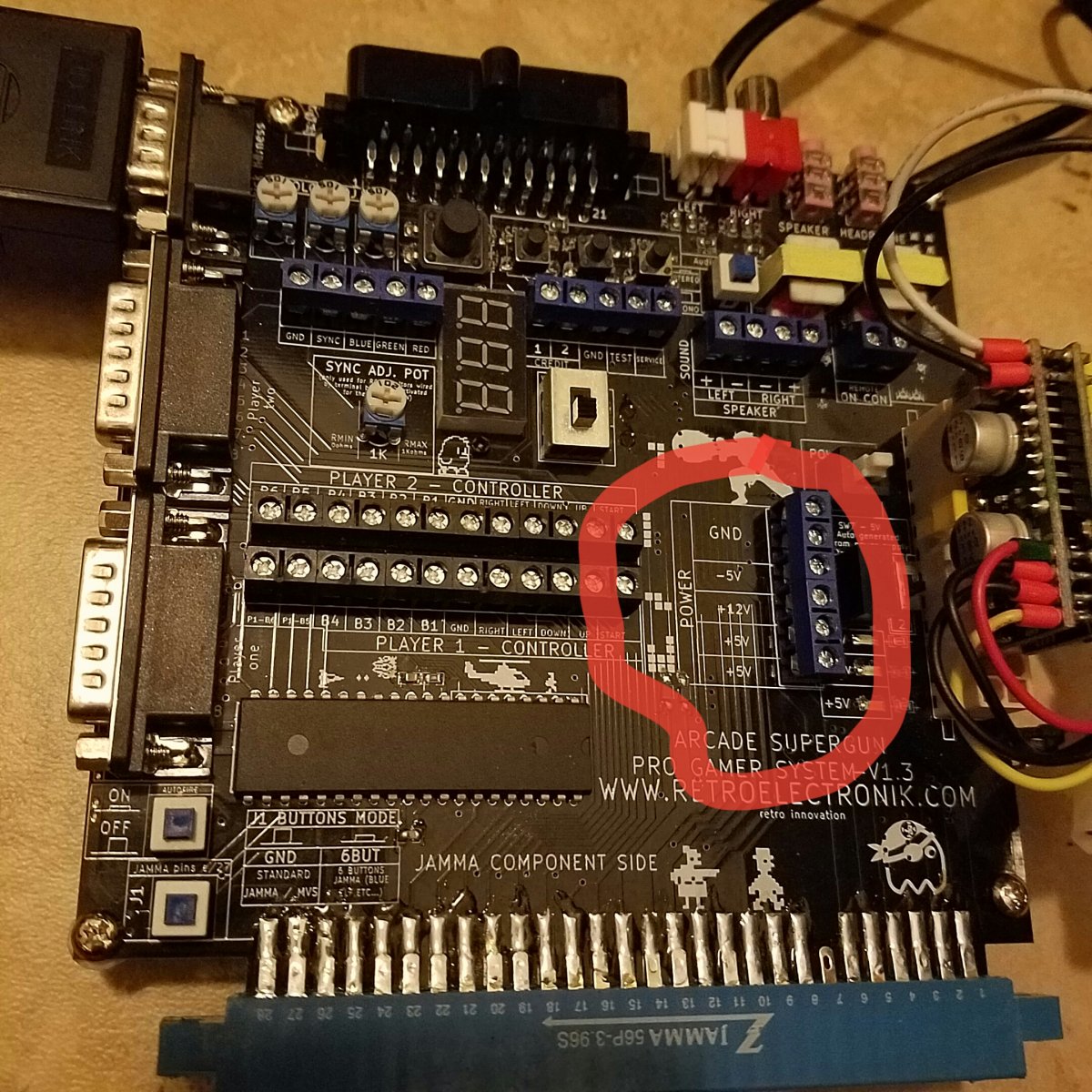

I have this supergun and i use a Pico power supply 80w (basicly a mini atx 20 pin psu). Its a solid supergun. You can also hook up an arcade power supply to the terminals in the red circle

You can use either a standard PC ATX PSU/ Pico ATX PSU or a arcade PSU. If you use a ATX power supply it plugs into the atx plug. If you use a arcade PSU you'll need to wire each wire to the corresponding voltage and ground on the PSU and supergun terminals . You have both options

Just use a 16 to 18 gauge wires with 16 to 18 gauge ring terminals on the psu side and then striip the wire and use the screw terminals on the supergun.
