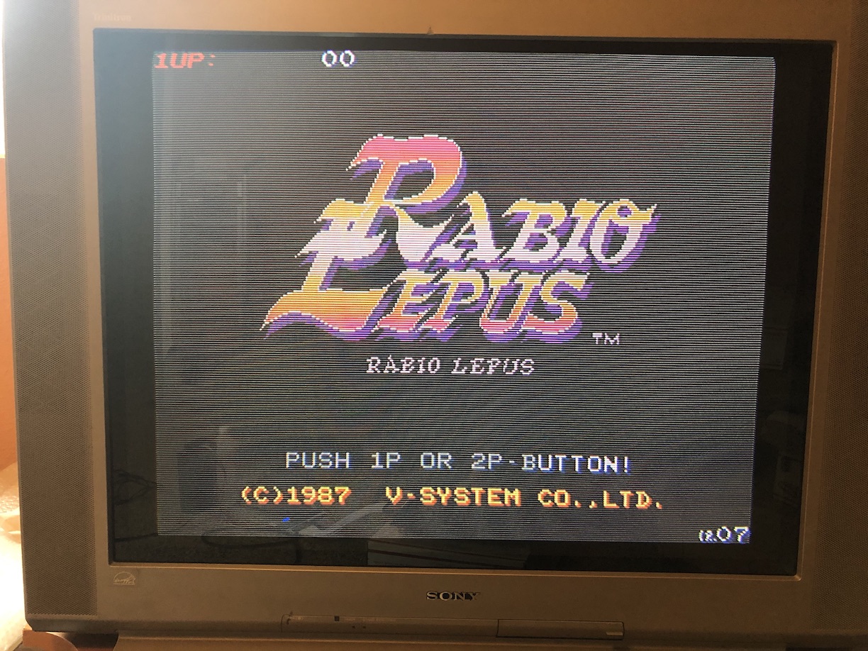

WTH? This is the first game that has been THIS picky about power and underpowered at that. Is this normal or does this indicate a problem I should be looking for?
Also, with the HAS, the screen is still very washed out. On my JAMMA cabinet, I'm able to adjust the monitor to make it darker and make it look OK, but the video output seems very different. The HAS knob adjust darker, but cannot dial it in on my CRT TV.
Anyway to fix this to work with my HAS or is this just an unusual PCB? Or is something still wrong with it?
You can see in the image above, the background should be black like the edge of the monitor, but instead it is grey.
Any ideas?
I'd recommend replacing the capacitors. That may resolve both the issues of the dark display and the pickiness over the power. I've had boards that displayed dark and then a cap replacement brightened them right up.
If the new caps don't make a difference, you can at least cross them off the list of potential culprits - it's never a bad idea to replace old caps IMHO.
I wonder if there is some common fault with this PCB, or is it the supergun compatibility issue, because I googled and found pictures that look washed out, too - https://www.worthpoint.com/worthopedia/rabbit-punch-rabio-lepus-jamma-pcb-161492357 (notice the black edges of the monitor).
Do I understand it correctly that it's the same on the cab and you just "fix" it by darkening the monitor?
Correct @RGB even on my JAMMA cab, it is too bright and I darken the monitor to make it look correct.
Thanks @ShootTheCore, but the screen isn't too dark, it's too bright, as if the PCB is getting too MUCH power, even when I turn the PS down to 4.85v.
Of course, it could be a cap (or something else), but I guess for now it works. I'm going to play through it (at least as far as my skills take me on a $2) and see if the board freezes up. On power more than 4.95v it seems to freeze pretty quickly (just running the demo).
