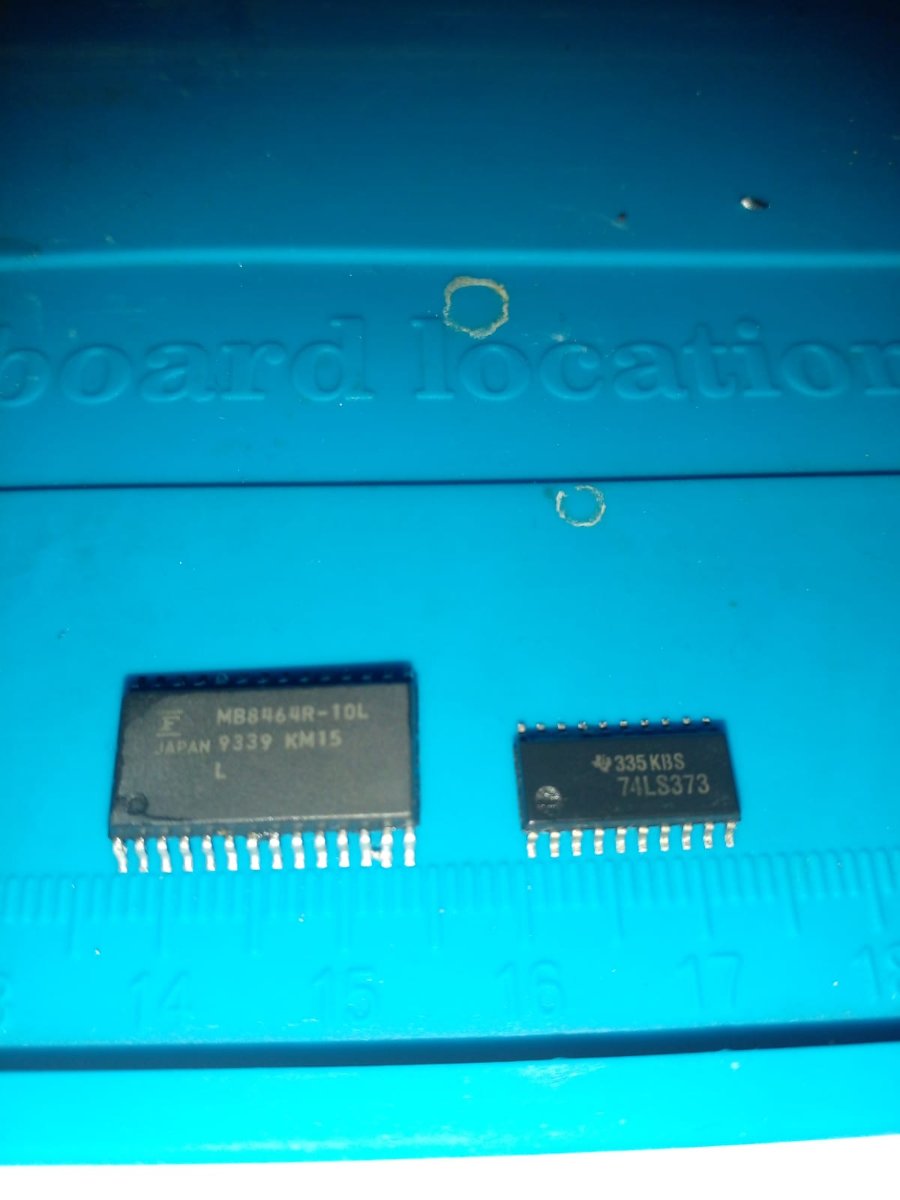

Hi! I did what you suggested, but the RAM error came back. So I started testing each memory chip one by one on the board and was able to identify which one was causing the issue. I found out that one of the MB8464R-10L memory chips and also the 74LS373 were faulty.

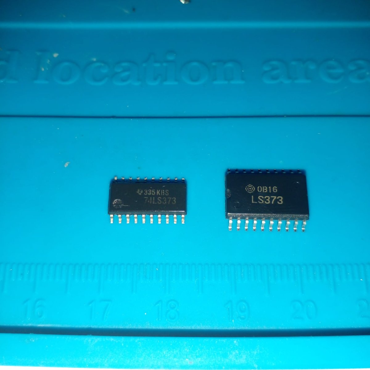

After putting the working memory chips back on the board, it booted up, but there were still glitches. I believe the issue is still with the LS373, probably because it's of questionable origin and its package is quite different from the original one. The LS373 I got is physically larger than the one originally on the board. There was just enough space to solder it, but the pads were right at the edge.
I don't think the size is really the problem, but I'm going to try to find the exact same model as the one that was originally on the board to replace it.
