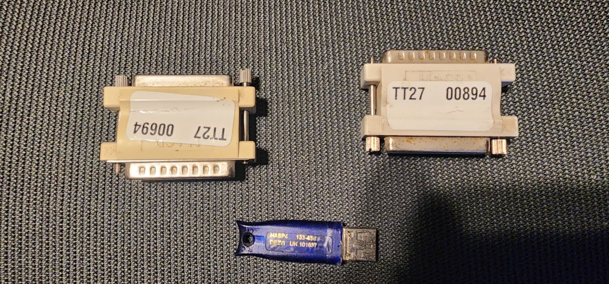

A USB Dongle and A LPT Dongle (astro_zombie kept the 2nd LPT Dongle)

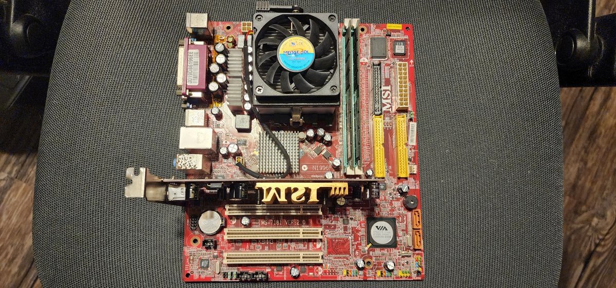

A BIOSTAR M7NCG-400 Mother board with CPU
AMSIMS-7181 VER2.0 Motherboard with CPU and RAM

From what I understand the v2.12 software requires BOTH the LPT and the USB dongle. Though I'm not sure how that works considering some of those Gen 2.0 mobos don't have an LPT port

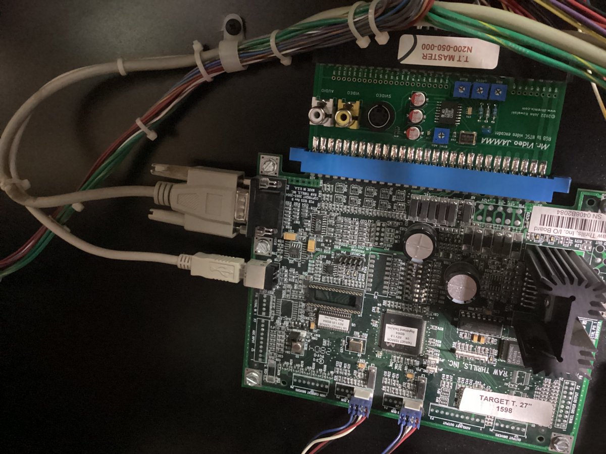

I've identified 2 different revisions of the IO board. This IO board was actually used on a number of different Raw Thrills games however the firmware on U4 and U6 is unique to the game. I've found a Target Terror IO board that list "Rev1.8"/"Rev1.01" on U4 and U6, and another variant that lists "Rev1.9"/"Rev1.02" on U4 and U6. There's a post on KLOV stating that certain software versions only work with certain IO board revs. but I've not found any other evidence to support this.
How it's all hooked up
The Manual does a good job at explaining how all these parts connect together but I'll simplify it here:
The IO board is powered over JAMMA, and connects to the mobo via USB (for controls) and a 3.5mm audio cable (to amplify and pass through audio to the JAMMA Edge) and a VGA cable (for video).
The Mobo itself is not powered by JAMMA but rather an ATX style PSU... Technically it's an "SPX" power supply, which is a more compact form-factor for use in mini-ITX setups but otherwise the same.
As for the Watchdog device. This is completely optional. Basically this detects if the PC has frozen and "pushes the reset button". Supposedly this same device is used on a number of Raw Thrills games. It's got 3 connections. 1 connector goes to the reset switch header on the MOBO, it has a 4-pin molex connector to the PSU, and another 2 pin connector that needs to be spliced into the JAMMA harness with one pin to ground and other to Player 1 Coin Lock out. Basically it seems the IO board is able to detect a lock up (I would assume via the USB connection) and then triggers the P1 Coin lock to force a reset on the mobo. Why they didn't integrate this into the IO board, or at least provide a 2-pin header so you didn't have to splice into the JAMMA harness is beyond me. This makes sense in an arcade where the machine auto-resets if there's a problem. not really needed in a home setup though since you're not running it for hours unattended.
Guns are "Happ 45" style CRT guns and are hooked up to the IO board via two 4-pin headers.
Setting the resolution is done by the DIP switches on the IO board. The Manual does a very good job at explaining the appropriate dip settings. It also explains that during POST it will always be VGA and wont switch to lower resolutions until the OS loads the game software.

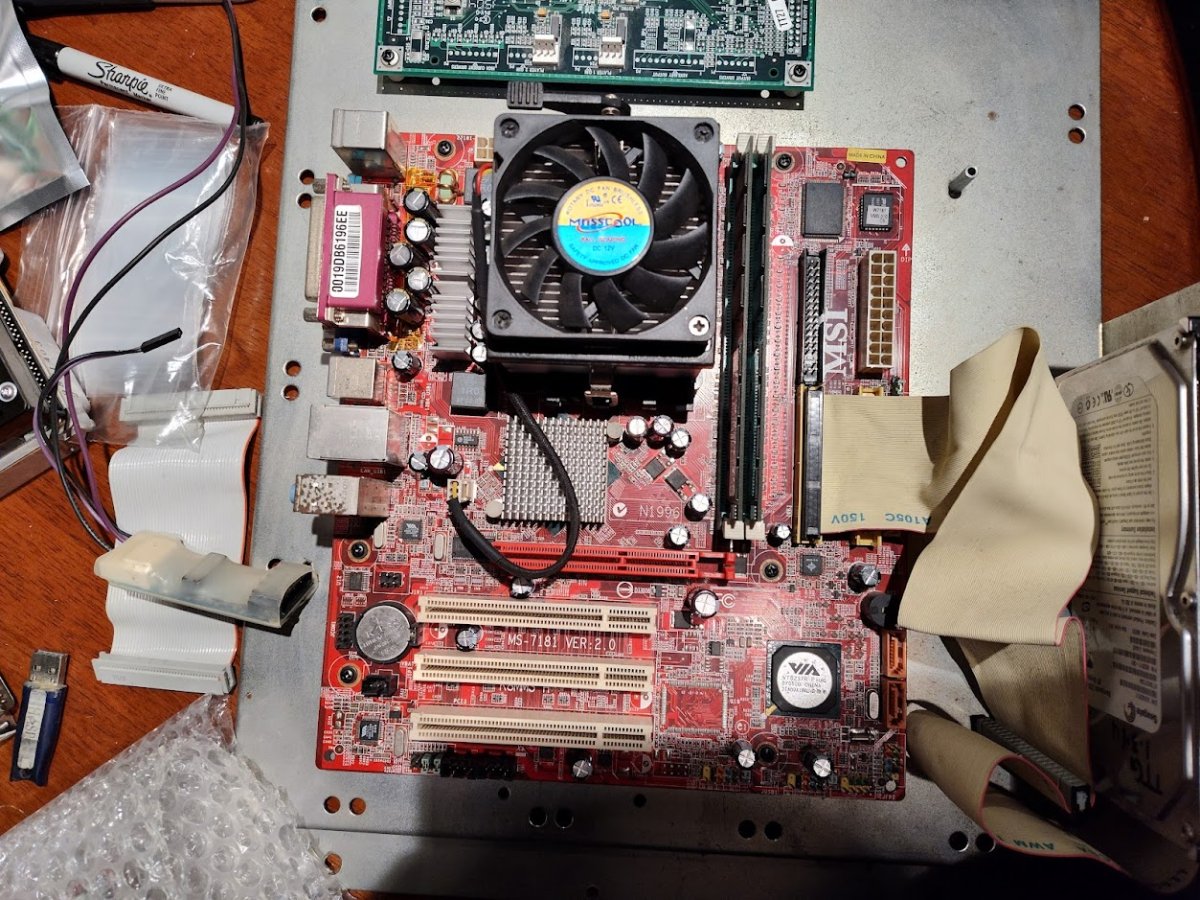

I started with the newer generation of the two mobos I received. bolting it and the IO board to the metal plate along with the hard drive. I grabbed an ATX PSU that I had but quickly realized it was far too large to bolt up to the plate. the original PSUs used by Raw Thrills ranged from 200W to 270W I bough this cheap but well reviewed 500W SPX PSU off of amazon: https://www.amazon.com/dp/B08R5NN4FJ?psc=1&ref=ppx_yo2ov_dt_b_product_details
I did have VGA, USB and audio cables I could use, but I wanted to try to keep the wiring mess to a minimum so I also ordered
This 1.5ft VGA cable with compact connector: https://www.amazon.com/dp/B004C4XIOK?ref=ppx_yo2ov_dt_b_product_details&th=1
This 1.5ft Audio cable with right angle connectors: https://www.amazon.com/dp/B0BXXGWK42?psc=1&ref=ppx_yo2ov_dt_b_product_details
This 1ft USB cable with right angle connectors: https://www.amazon.com/dp/B0B74DHJMC?psc=1&ref=ppx_yo2ov_dt_b_product_details
Together all of those parts the board looked like this:
Troubleshooting so far
First Attempt at power on: IO board LEDs light up, no signal on monitor. CPU fan doesn't come on.
I'm assuming it needs the "power button" pushed. I found the manual for this mobo and identified the power button pins so I can hook up some wires to simulate a button.
Hooking up the power button and pushing it Causes the PSU to come on and the CPU fan to start spinning but otherwise no signs of life.
It's at this point I noticed that there is an additional 4-pin power connector on the other side of the CPU. so I hook that up.
Second Attempt: Pushing the power button I get a mobo beep and some video output of the POST! but it doesn't go any further than that.
Obviously the arcade setup doesn't need a power button so the BIOS is not configured correctly. The Manual actually has a great section outlining the appropriate BIOS configuration. So I hook up a key board and reconfigure the bios so that it automatically powers on, skips any errors (like no keyboard connected), and does the correct boot order (which should be CD ROM followed by HDD for software recovery), as well as some other settings. I save and quit but it still wont boot.
3rd Attempt: I tried rebooting after changing the bios settings. I don't need to use the "power switch" anymore but it's still not coming up.
At this time I notice that the HDD is registering as a slave instead of master on the IDE chain. This despite being in the master position on the cable. I notice that there is no jumper on the HDD and the diagram identifies no jumper as being the default for a slave device. I find a jumper and install it on the HDD in the correct position.
4th Attempt: the OS boots!
The mobo gets past post and the OS starts and displays a Target Terror background but shortly there after throws an error.
I'm not sure what this means. but I'm out of time for today and I'll be troubleshooting this more soon. I'm going to see if this Mobo needs the GFX Card, and if that fails I'm going to try upgrading to a newer software revision.

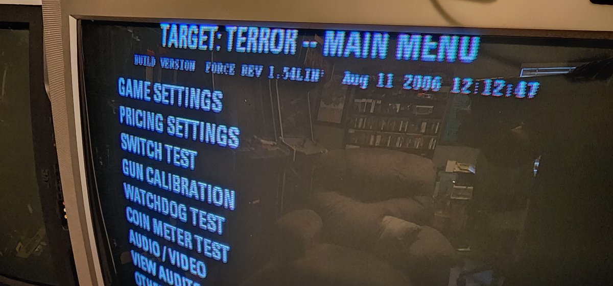

v2.12LIN installed on the new HDD fine. though it takes about an hour to do a drive flash. On boot I only had the LPT dongle in and it gave me a missing dongle error. It would only make it past this Error if BOTH the USB and LPT dongles were installed. so I guess that confirms that this version needs both. After that though the "Now Loading Please wait" screen simply blinks to black every few seconds but sits there indefinitely otherwise.
I decided to try the next newest version I had which v1.54LIN. Again this took an hour to flash. and like 2.12 it didn't throw the gun.exe error, however this version through an "insert dongle" message no matter if I had the USB or LPT or both installed... so this was a bust. It would seem that there are different dongle variants too so that's another complexity here.
Next up I'm trying v1.38LIN
It's worth noting that neither v1.34U, nor v2.12LIN nor 1.54LIN ever switched the resolution to 15KHz despite my dips being set to do so. I'm not sure if it never booted far enough to change the resolution or if these versions simply don't support it.

However I had success with v1.34U. I have the game booting now on a fresh v1.34U image, it requires both dongles and the video card. (this is on the MSI MS-7181 VER:2.0 Motherboard)
Weirdly the same disc that installs v1.34U installs v1.38D. I believe "D= Dedicated" "U=Upgrade" and "LIN=Linux".

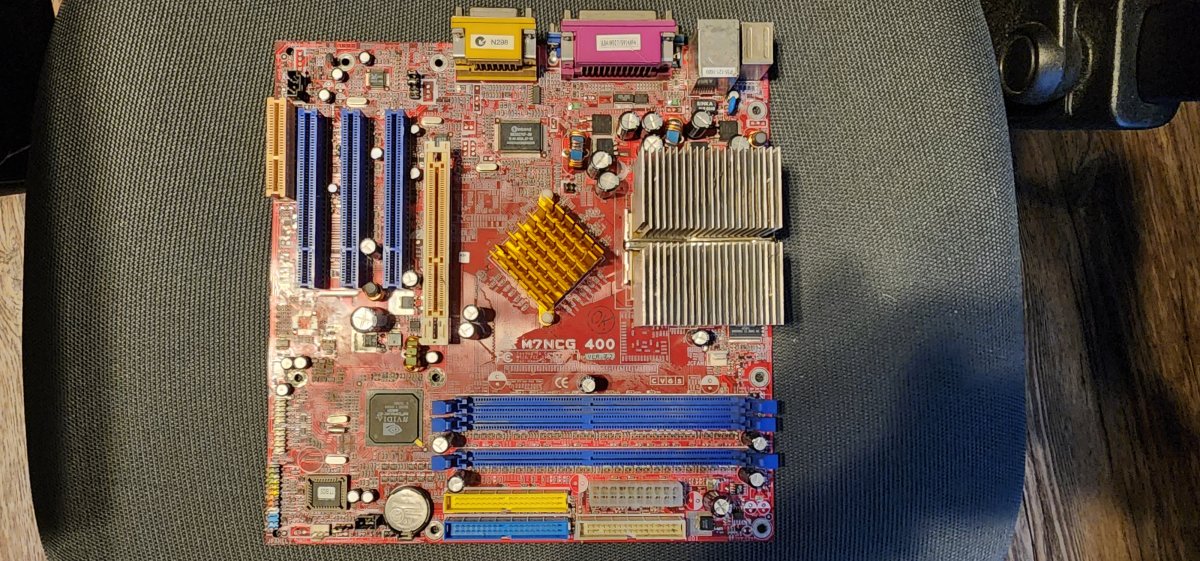

I did also try to boot the BIOSTAR M7NCG-400 motherboard but had no luck. the power supply kicks on when I push the "power button" but there are no other signs of life. there's some corrosion on the board around the FSB so this board might be toast :-/

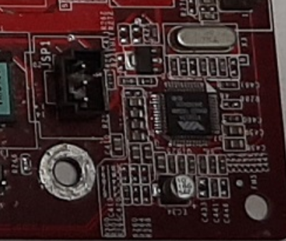

As for my lack of audio. It seems to be an issue with my mobo. inspecting the audio section I'm actually missing a cap!
if anyone has a MSI MS-7181 mobo and could get the value of this cap for me it would be greatly appreciated! I haven't been able to find any reference images online with a clear enough picture of the cap to discern the value.
Hi, found the EC34 capacitor value at the motherboard service manual, page 21: C10U16EL, I would decode that as as a 10 uF 16V cap
Also got an almost discernible image of it, from a MSI MS-7142 photo, has a similar VIA VT1617A audio section
I too am working through a mountain of parts and trying to get a working target terror. Thank you for your thorough postings. I have a v1.38d cabinet. I am wondering if you have any suggestions for me…
My issue stems from an irreparable monitor. Now I have been struggling to get a working video signal to a replacement crt-tv, a Sanyo ds27800.
I chatted with Astro zombie who said that v1.38d would not work with a crt tv.

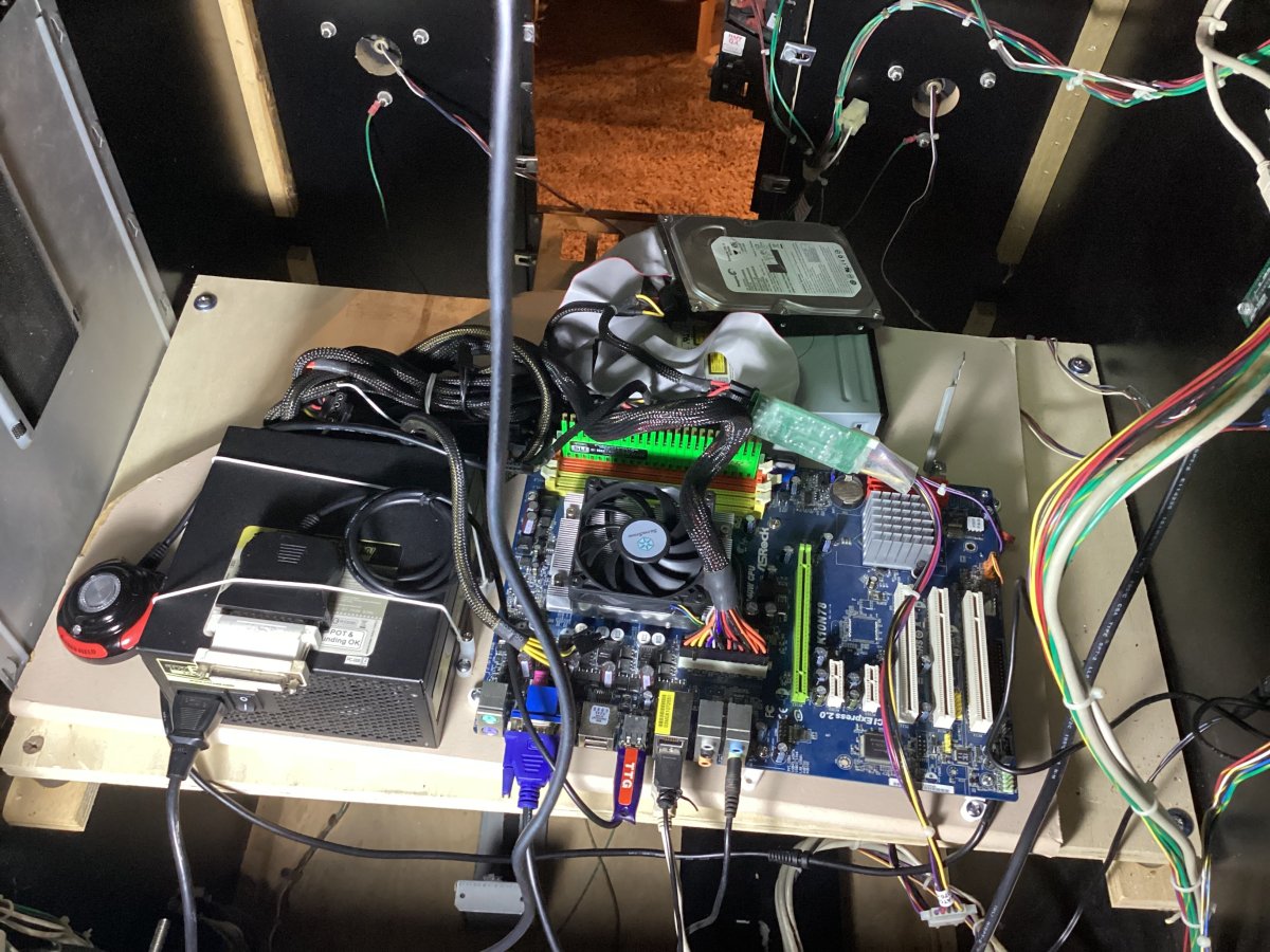

So, I built a whole new computer (per specs) for v2.12 Lin. (Pic)

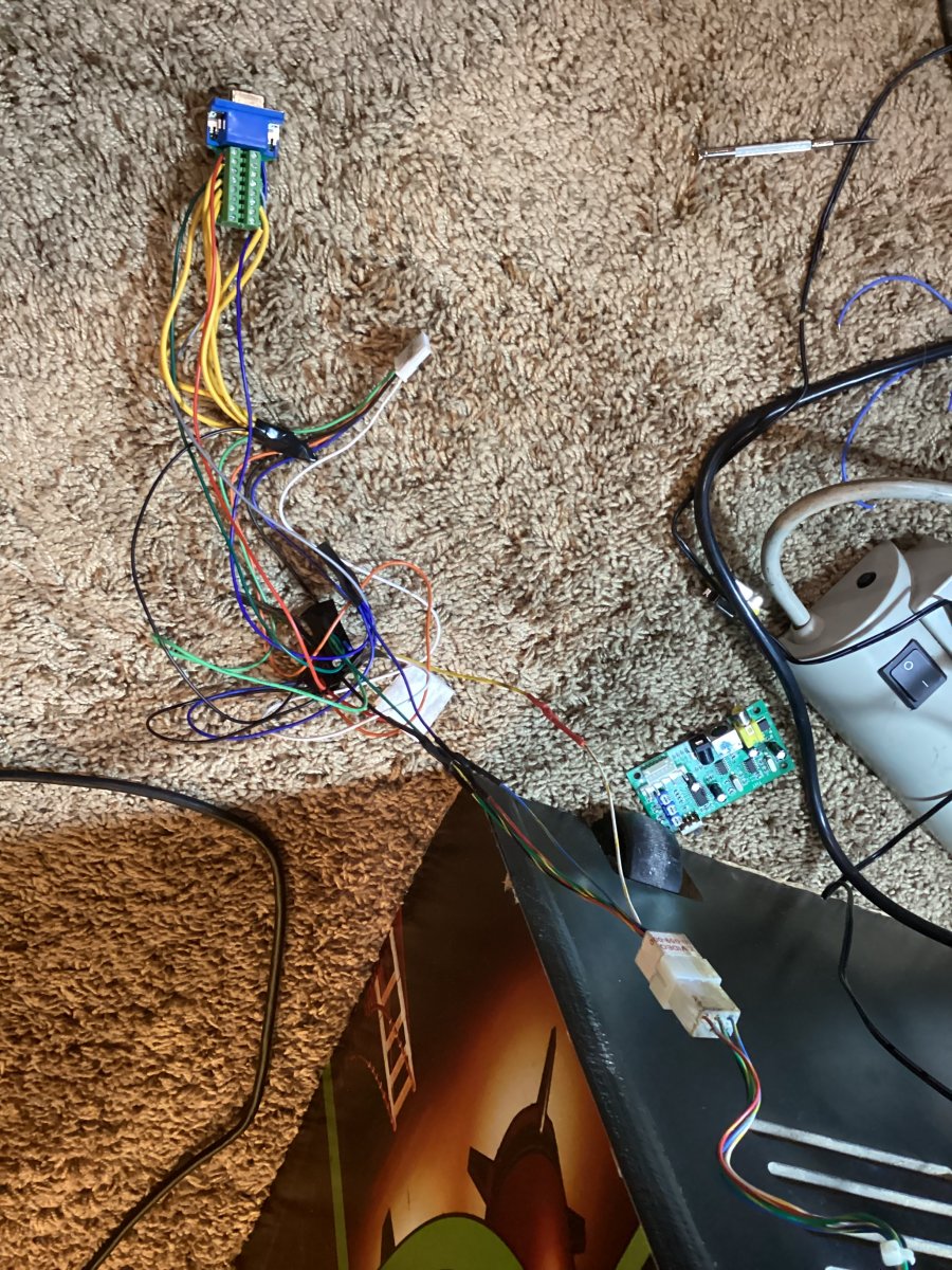

I have made a vga connector (pic) that connects to 5 pin molex from jamma edge of I/O. This does pass through video signal but it is degraded. Also, I found a jamma pass through board from Mr. Video JAMMA in Canada. (Pic) This potentiometer sync on-board adjuster was invaluable in getting any video output. The RGB pots don’t seem to have any effect. The pass through has both s-video and video composite outputs. These do not work when directly connected to tv. The only way to get an image on the crt tv is connected the pc onboard video vga to video converter (pic) and the s-video out to crt tv. This pic is normal and not blurry. If the vga cable routs through the I/o board the output is blurry. (Pic) This pic is on a vga monitor.
***Any video signal coming through I/o board is in an incompatible format. If the vga adapter from above (works when directly connected to pc vga out) is placed AFTER the I/o board, there is no signal to crt tv. There is a signal, but it is fleeting, distorted, and quickly replaced by the blue screen (no signal). This signal is only visible when switching inputs on the tv and only for approx 1 sec.
In addition, the new v2.12 Lin build freezes at the “loading please wait” screen. I have flashed 2 different HDD with two different ISO (2.12 Lin) images and same end result.
Any help would be greatly appreciated.

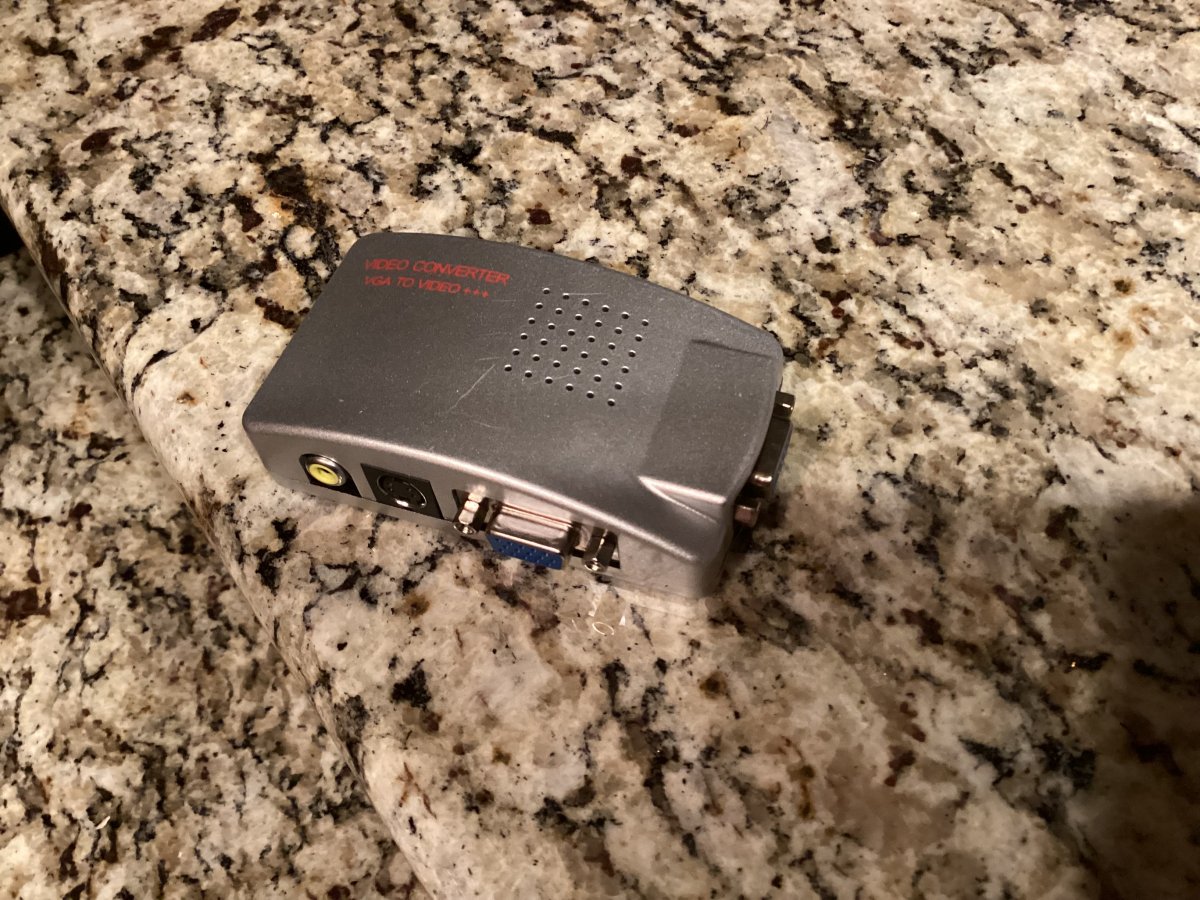

I can tell you right now that a CRT Light gun will not work if you're passing the video signal through a converter. the converter will jack up the sync signal and make the guns not track properly. you need to have native video out to the display for the guns to work.

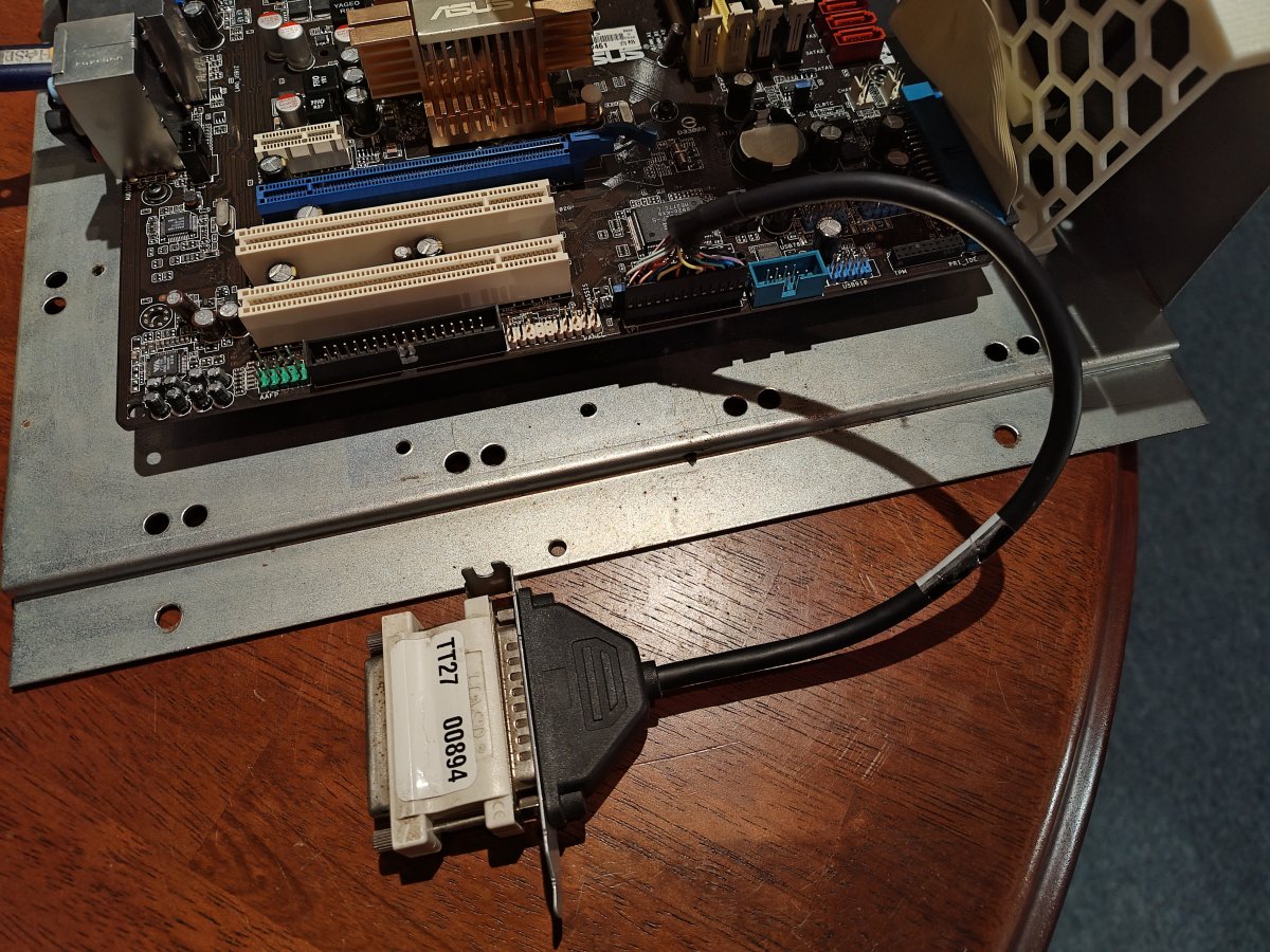

So an update to my setup. I decided that since I'd confirmed my mobo did not support the newer Linux based images and thus did not support 15KHz resolutions and since it was having audio issues that I would pick up a new mobo to solve these issues.
After very little hunting on eBay I picked up a used working generic ASUS M3N78-VM Mobo with a CPU and RAM for about $50. This seemed like a very common and inexpensive mobo to find compared to many of the other supported mobos on the list. I've also seen people run v2.12LIN so that's nice also.
Another nice benefit is that it uses integrated graphics, so one less component in the system. Negative marks against this mobo is that there is no LPT port on the back panel, and it only has 1 IDE header. All of the newer mobos that don't need a graphics card and work with the newer linux releases have this same issue. I've seen a bunch of people run USB to LPT adapters or PCI to LPT adapters but I don't know why since these mobos all DO HAVE an LPT header right on the mobo, you just need a harness to use it.

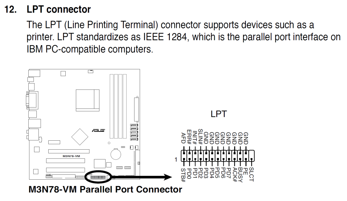

I found a ton of cheap adapter cables on ebay like this:

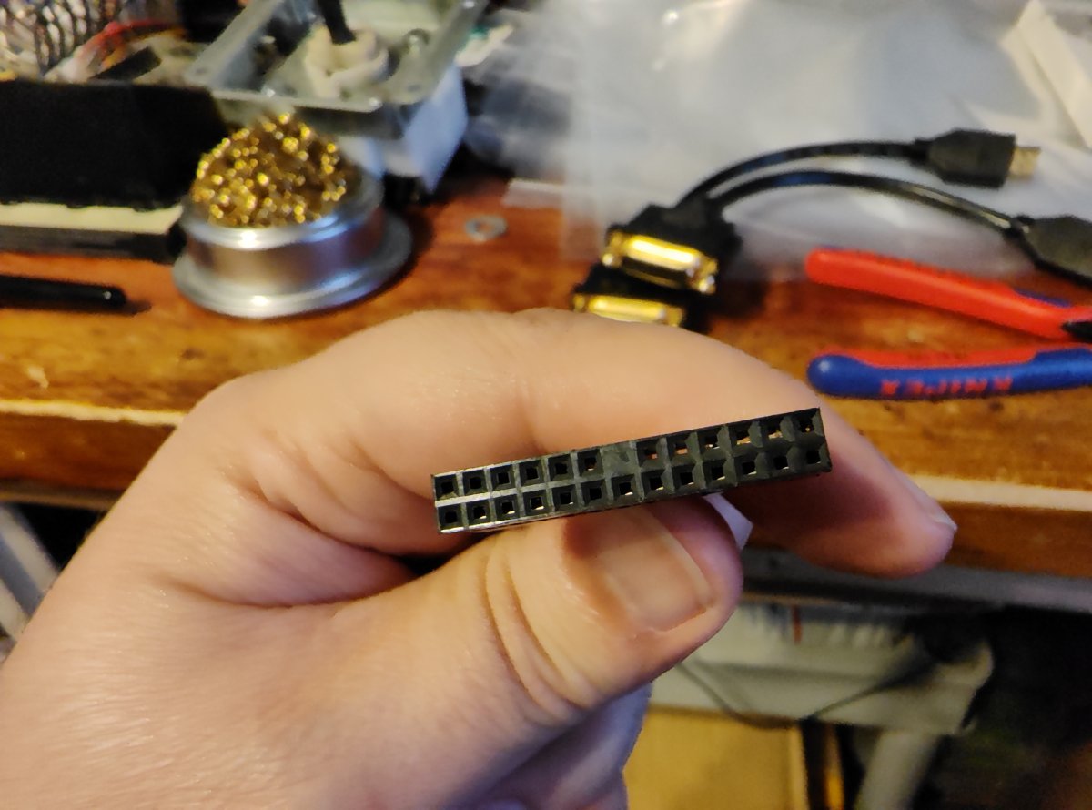

the problem is the LPT header on the mobo has a key pin in the top right corner:
but this adapter has the key pin in the center:
checking the pinout of the connector against the mobo header pinout they matched with the exception of the key pin, and the adapter had a ground wire going to the key pin location for the mobo
it was very easy to cut out the key on the connector with a razor blade and then move the ground pin over by 1
this worked perfectly
I'll be using the mini PCI bracket attached to the adapter to hold this down to the metal plate that the mobo is attached to.

Interesting. is yours the "TTG" labeled USB dongle or one of the older ones?
my v2.12LIN definitely needs both dongles but I wonder if some of the newer USB dongles work without the LPT dongle.
