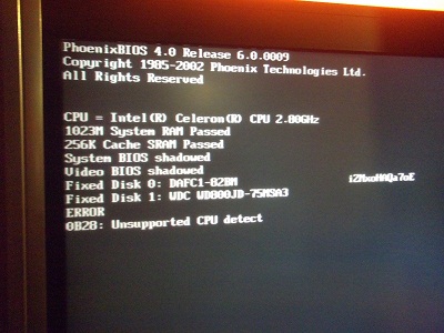

But - I have a really strange error case with my Lindbergh.
From the beginning: I wanted to put a Multi in my original Virtua Tennis 3.
Then came the first issue: In boot sequence an error appeared: unsupported cpu detected. (Photo)
There I saw it has a celeron, although yellow Lindys should have a pentium 4, right? I thought that´s the problem, and the multi would need the pentium 4, so I bought it (definitly the correct one, checked it), Same error. (With Pentium4 displayed) Then I wanted to cancel it, change to virtua tennis again- but still the same problem, even with the original processor and game, installed and running for years.
Soo...can anyone help me? Maybe an easy solution, enter a code, reset something, something like that?
I really hope for help, thanks in advance.

You can try resetting the CMOS by using the jumper on the Lindbergh or pulling out the CMOS battery.
If you've already tried 2 CPUs then I would say that this is a terminal motherboard failure. I've not seen this before, so it's not a common failure which is likely why no one has replied. If the CMOS reset doesn't work, you'll need to buy a new motherboard for your Lindbergh.
