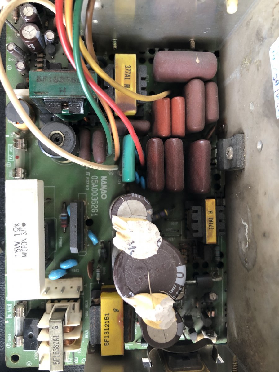

Help, I recapped my Astro city psu and plugged it back in again. The machine turned on okay for 5 minutes and then the monitor shut off. It’s not coming back on again. My psu is 400-5261Y. I tested the machine with a second psu I know that works fine and the monitor is not coming on so I definitely think it’s the monitor that has the issue now. I don’t want to risk putting the psu I recapped into my second machine and having it kill that monitor too. Could the recapped psu have caused some sort of power surge that killed my monitor? The red 5V indicator LED is on. Not sure if that matters or not.

Astro City monitor boards are normally a Nanyo MS8, but i've seen a lot of folks also have MS9's in there. The MS9 is a better electral design from a safety perspective. If it's easy to find the chassis model number that info might be helpful too.

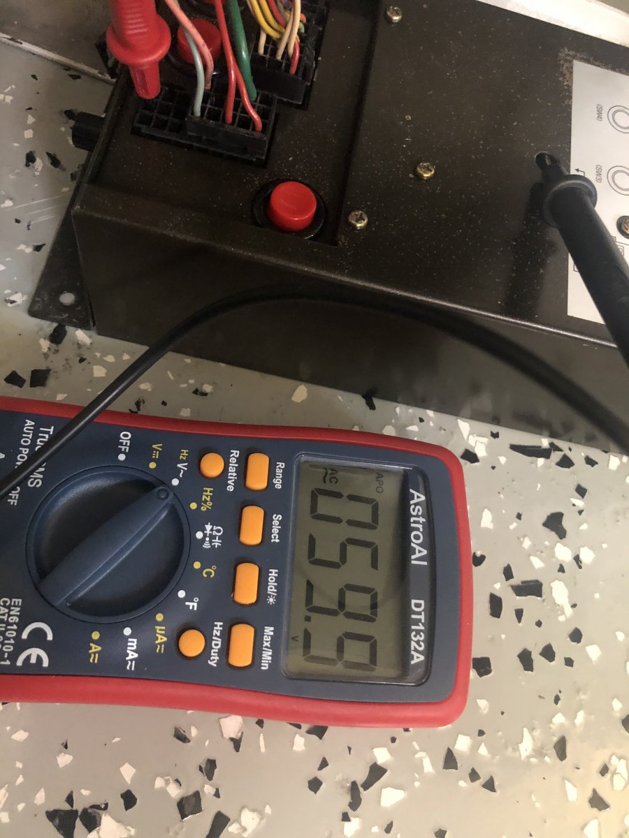

From the working psu, I’m reading 59V out of OTL and 58 out of OTN. From the recapped one, I’m reading 62V out of OTL and 55 out of OTN. They also match the input VAC.
You're measuring it wrong. It's AC, not DC. Red meter lead on live, black on neutral (or vice versa). You should see a full ~120V on both connectors.
I put it on AC. The neutral line is in the middle right? Or just ground like chassis casing?
OTL is live, OTN is neutral.
