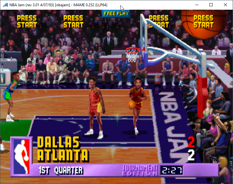

Did some hacking on NBA Jam TE so it would run on any T-Unit.
