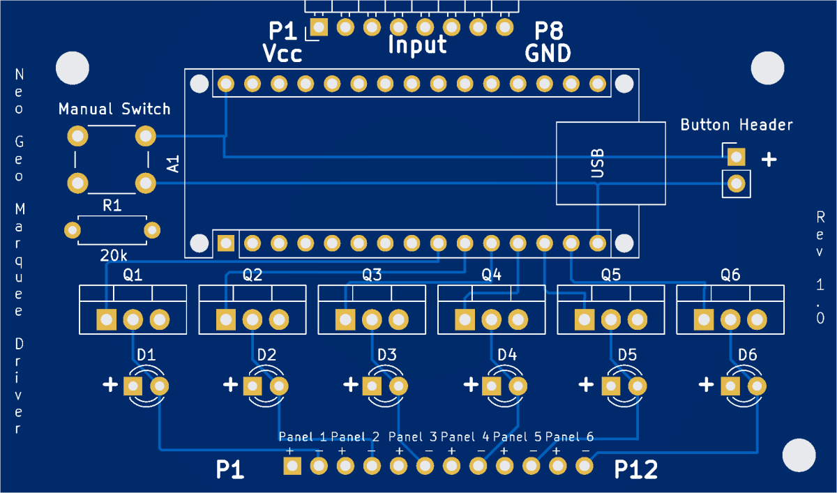

I decided to see how difficult it would be to make my own, and how much more difficult it would be to use EL panels
Introducing the Neo Geo Marquee Driver (will likely get a name change before being released)
This is available in 2 forms, depending on what panels users want to attach. A 12 pin 2.54mm connector or 6x USB-A connectors. Logic is all on an Arduino Uno which turn panels on/off using MOSFETs
The best part? This project is going to be released as 100% open source. You can get your own PCBs made up, modify the design to suit your own requirements or I will also be selling these pre-built. The total build cost for the PCB is less than $20 for the 12 pin version or under $30 for the USB version. A bill of materials is available on the GitHub
Features:
- 8 pin JST/Molex style connector matching the MVS board header for easy connection
- USB connectors for EL panel connection
- Powered by Arduino Nano
- [Optional] LED indicators for active panel (for testing/diagnosis of non working panels)
- Code can be easily reconfigured to allow whichever combination of USB ports you want to use to be active
- [Optional] Self test mode at power on to identify any issues
- [Optional] Attract mode with adjustable delay (cycles through marquees if you wanted to have a panel but do not have a multi-slot board)
- [Optional] Manual mode with button and button header to manually cycle through marquees (similar to attract mode but with manual change)
- Mounting holes in both M2 and M3 size options

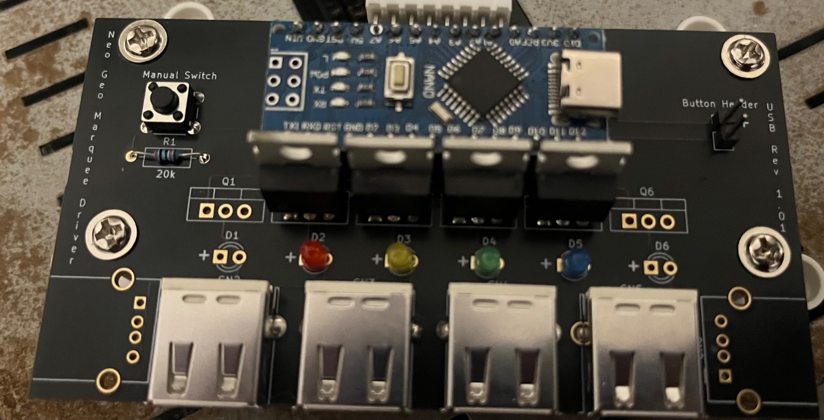

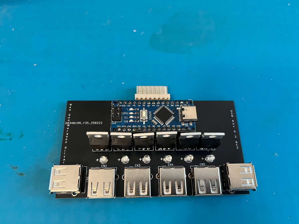

The boards for the latest prototype revision arrived today - I am hoping this will be the final test version before production. This is the USB version designed for use with EL panels commonly found on Aliexpress
All parts on the board are through hole and very easily available from Digikey and similar distributors (also Jaycar for those in Australia) with a parts cost of around $20-30AUD ($15-25USD)

I have now decided to call the current revision v1.0 because it does everything I need it to do for an original marquee. Additional features can be added from here but we officially have a production model

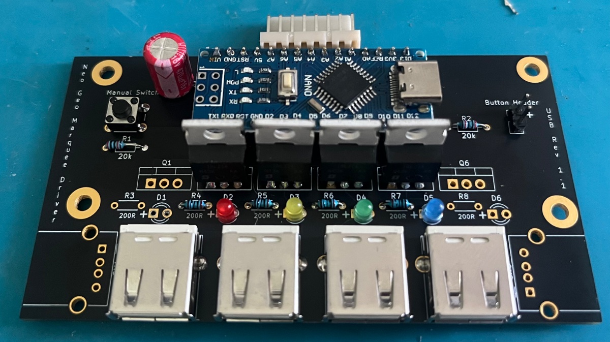

The latest revision v1.01 boards arrived today and I put one together ready to install in its new home in my 4 slot cab
I reworked the code to use only the bottom 4 connections and had some fun with the test LED colours
Next step: installing in the cab

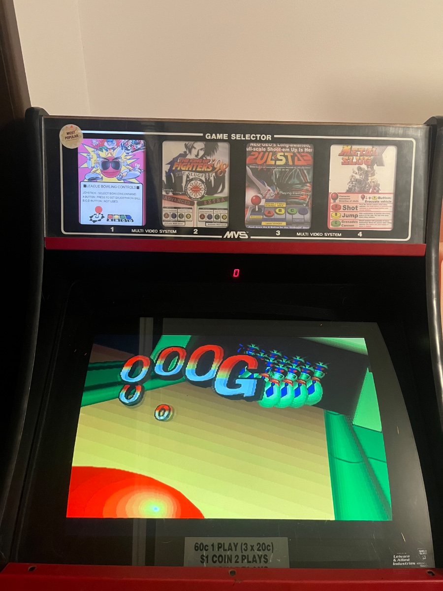

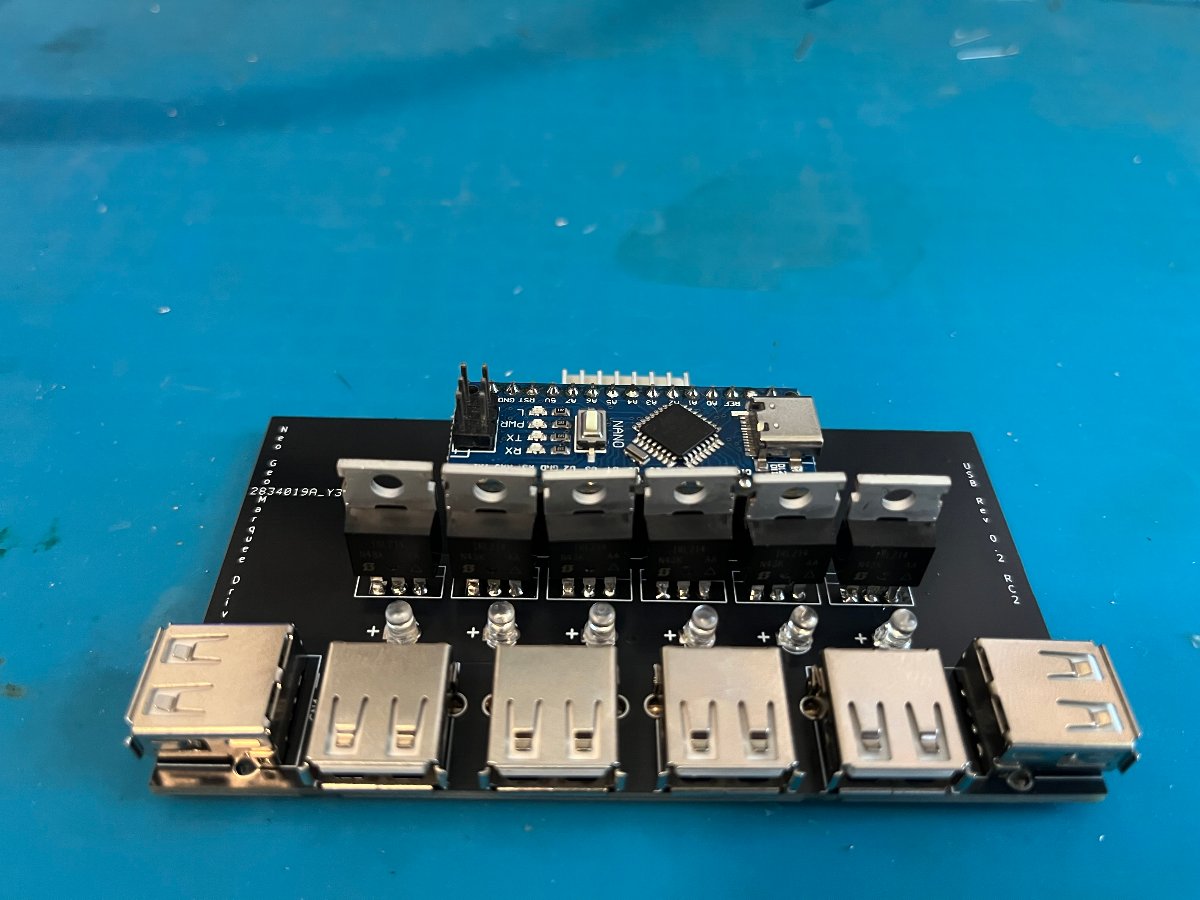

I have one installed and working in my own 4 slot cab and have built a couple more for others
This is the final design PCB fully populated (I have made a separate version of the code to allow the 4 bottom ports to be used)
And here is my own cab

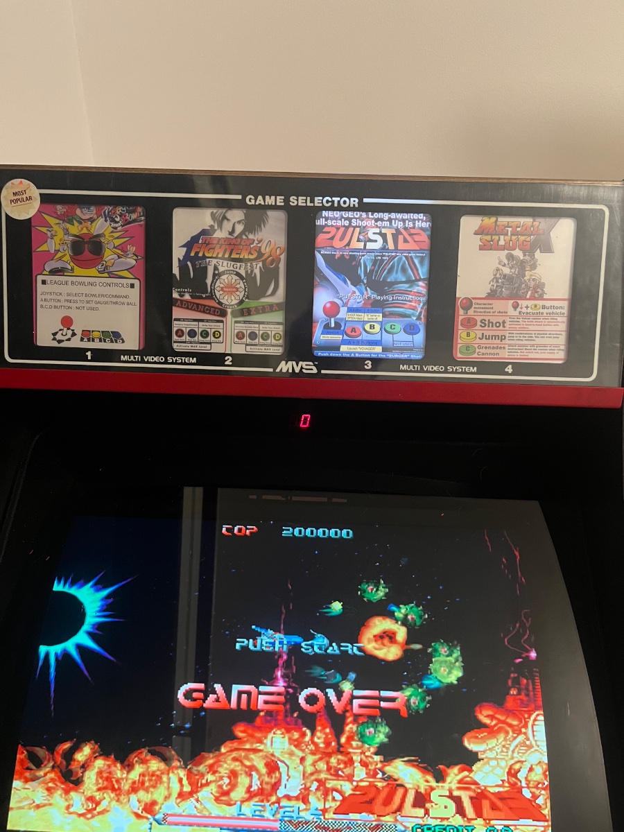

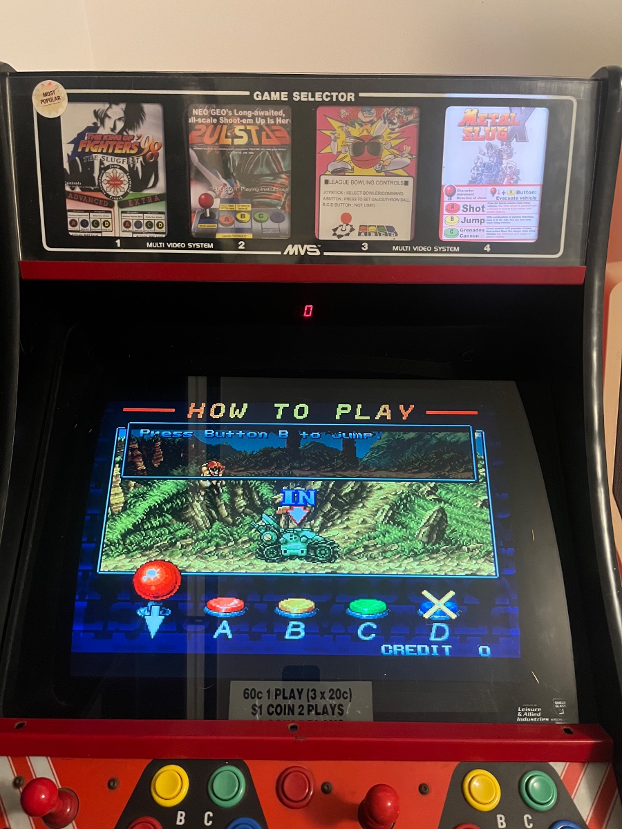

@xodaraP popped by the arcade on the weekend and installed his kit on my LAI 4-slot Neo Geo cab.
Here's a showcase of how it looks and functions. Works beautifully and is very snappy.
The strength of the EL Panel is perfect and illuminates "just right" IMO. Going stronger might be too distracting and wash out the details on the marquee art.

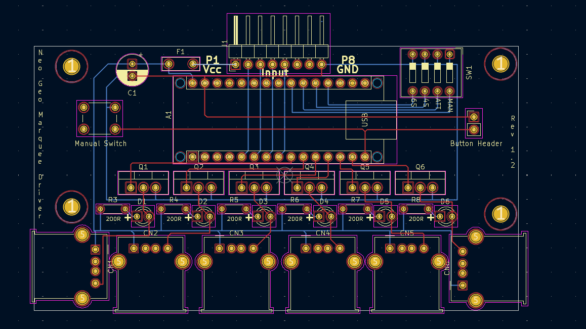

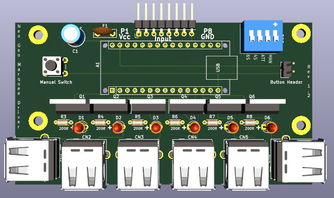

New Revision 1.2
Changes
- Non-USB version will be deprecated in 1.2 as both LED and EL panels are available with USB connectivity to provide ease of installation for users,
- 500ma PTC Resettable Fuse on 5V rail
- DIP switch block for setting 2/4/6 panels, manual and attract modes with indicating labels (MAN/ATT/4S/6S)
- Updated manual switch/button header as pull down instead of pull up and removed resistors
- Updated board layout to improve trace routing
- Increased trace width to 0.25mm for all traces
PCB View (KiCAD)
3D Render
Test boards are being ordered and GitHub will be updated once these are confirmed working
