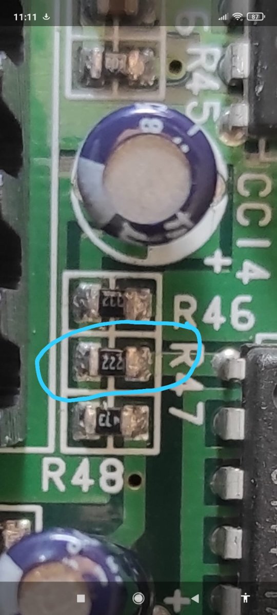

did not work. I could see that the sound of kicks and powers are absent
finally after a lot of work i discovered the defect in the audio that was causing problems in the sound of kicks, voices etc. after changing oki chip, z80, all capacitors, 4 ci 5218a, ci yamaha ym2151, chip ym3012 among others, I found that the defect was simply resistor R47 (2.2k). problem solved and sound working perfectly.
