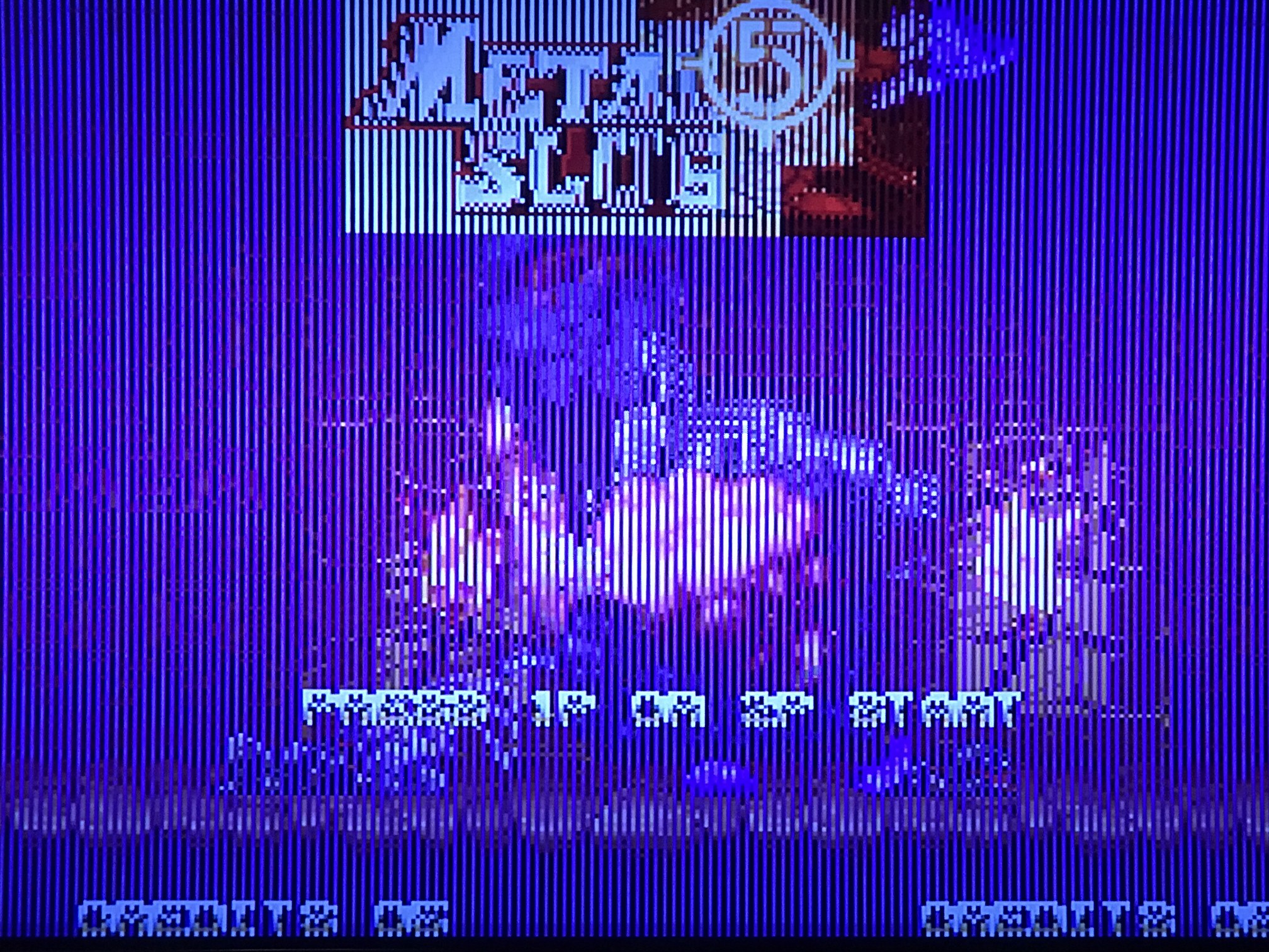

I purchased this Metal Slug 5 Neo Geo cartridge about a year ago. It worked perfectly fine when I first got it, but a few months later, it developed an issue where vertical lines would display over the entire playfield.

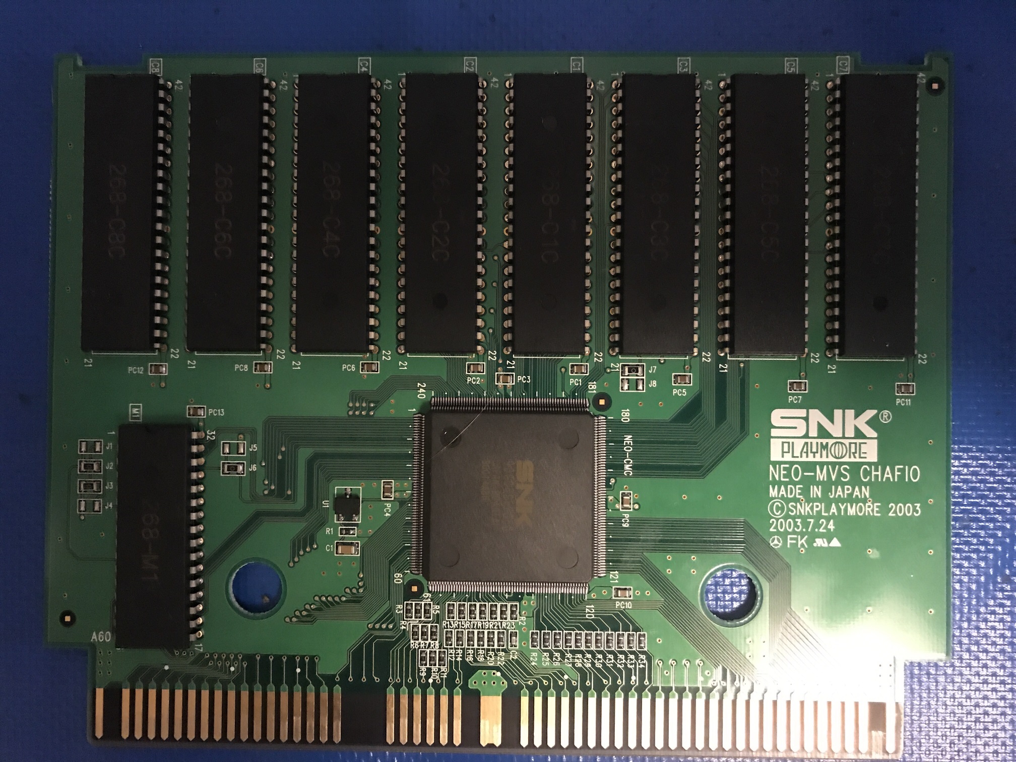

Neo Geo cartridges consist of two circuit boards - a CHAR board with all the graphics data and a PROG board with all the programming and sound data. This was a graphics issue, so my investigation focused on the CHAR board.

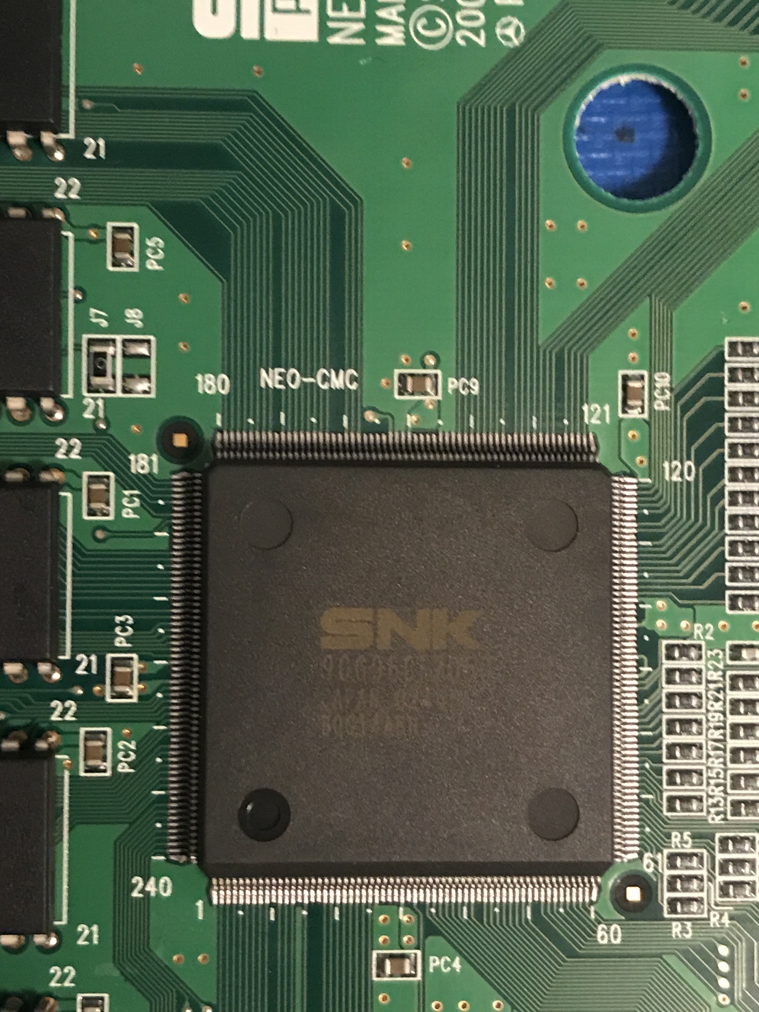

The culprit ended up being the SNK NEO-CMC multiplexor chip that manages the flow of data on the CHAR board. The SNK CHAFIO boards have a bad reputation for that chip failing.

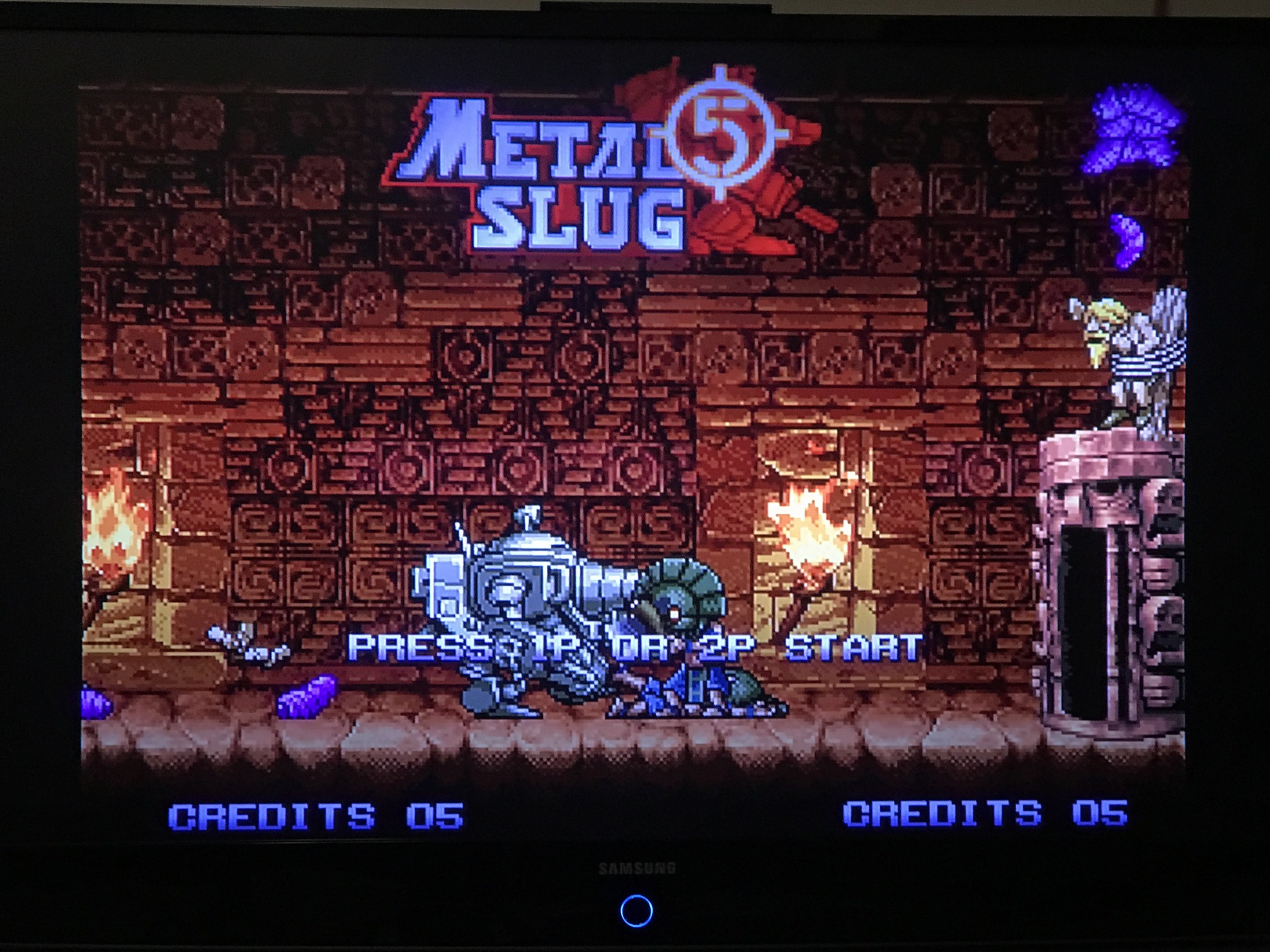

In my case, a helpful fellow on another forum sold me a spare MS5 CHAR board he had, so Problem Solved - for now at least.
Fingers crossed that the replacement board doesn't fail someday...I still have my spare defective CHAR board with the original ROMs that I can swap defective parts if need be.
