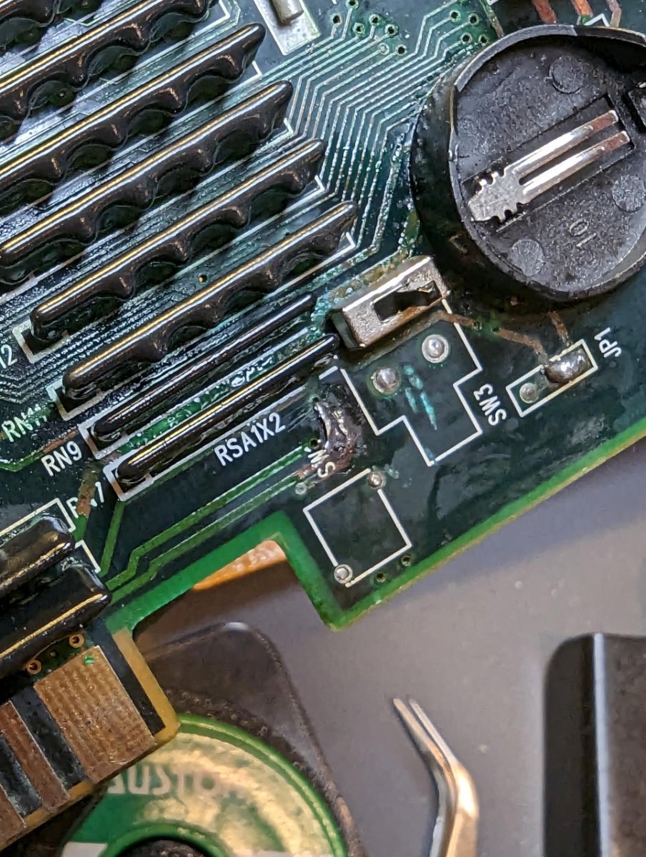

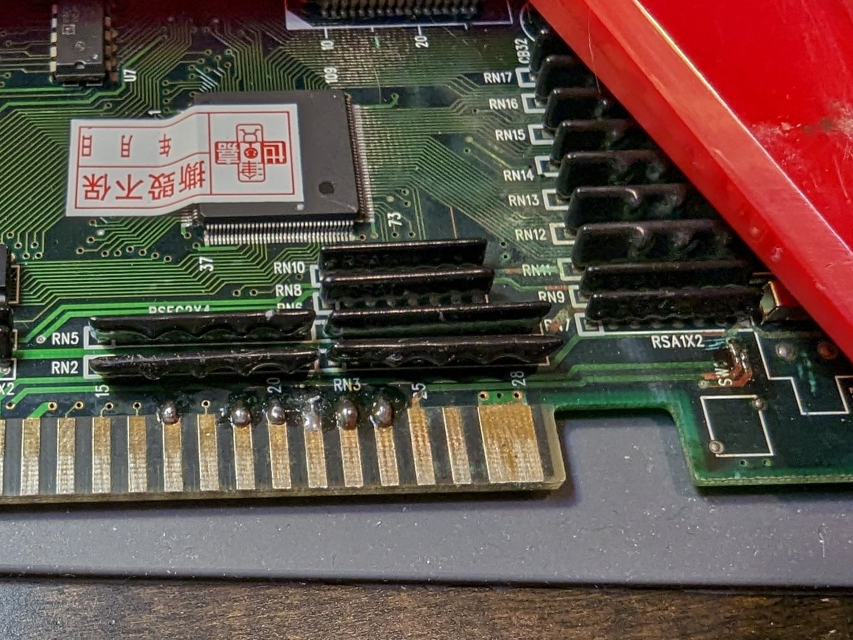

At first glance, I saw scuffed traces all over. The scuffs weren't centered near electrolytic caps or the (empty) battery socket, so I'm not sure how it happened. The solder on the JAMMA pins makes me think something severed the traces and a past owner had to fix it.

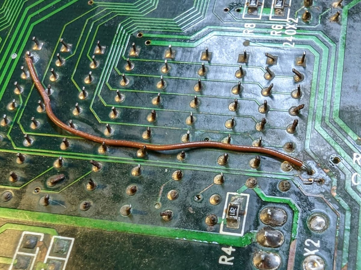

After clearing the gunk and looking closely at the back, I found a bodge wire had come loose (red). Sure enough, that through hole leads to the trace on the other side that's connected to JAMMA pin 25 (P1B4). Another bodge (green), tenuous as it looks, is intact.
The pad at the hole is torn off, and I couldn't get solder to stick to the exposed trace, so I ended up running a longer bodge wire from the source solder joint all the way through the hole. (Thought it would look better than wrapping the wire around the edge of the board.) I soldered it on the other side to the exposed trace on the front. The shiny flux in the pic makes it look like I bridged the adjoining trace on the front, but my multimeter says they're separate. I verified continuity from the source pin all the way to JAMMA pin 25, so the bodge worked.

Looks like all the "gunk" is burned flux... definite signs that the board had been worked on in the past. Shame on the seller for trying to pawn that junk off on you.
