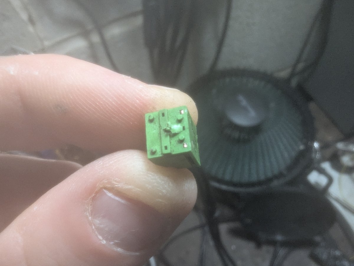

What is this adjustment thing even called , that you use a screwdriver to adjust the voltage on a Blast City power supply , and who sells it still?
I couldn't find the part on Arcade Parts and Repair by searching "Blast City " :( and am not sure what the official name or part number is .
I'm not sure I can resolder this the way the legs broke off . If I'm wrong though based on what you see please let me know!

Thanks very much !
Now knowing that the pot is a "trimmer" I found this other thread that's already done the work on finding and installing a replacement on digikey , with model# as well for the parts
Crud,looks that part is no longer made.
It says this is a replacement, and was in stock and able to buy in small quantities:
https://www.digikey.com/en/products/detail/nidec-components-corporation/CT-6ES102/1025273
