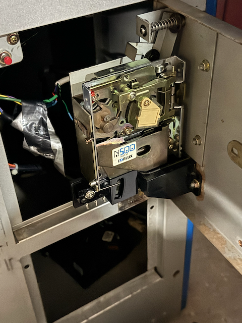

The factory 100 yen coin mech is
Series = Conlux N500
Model = N-560
Variant = N-563-1
The only difference between the N-560 and the N-563-1 is the black plastic microswitch retainer that also acts as a coin guide between the bottom of the mechanism and the coin bucket.

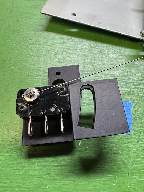

STL attached, this is designed to print without supports, I used the "outer brim only" setting to help with bed adhesion.
Assembly notes as follows
1 x Zippy microswitch "with needle". This was actually the hardest part to find for a bunch of boring reasons that I won't go into, TL;DR use this

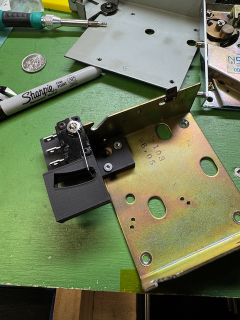

You'll need to bend the wire quite precisely to fit the guide
2 x M3x16mm bolts for the microswitch
2 x M3 nuts for the back of the microswitch
2 x M3x8mm bolts to attach the microswitch mount to the bracket

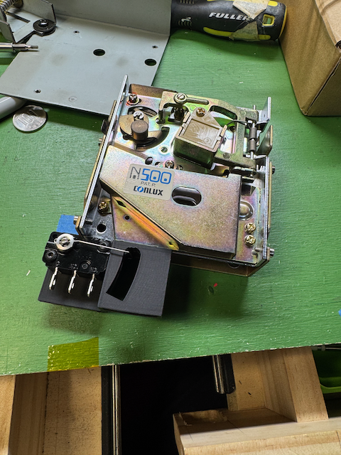

And the finished article should look like this
